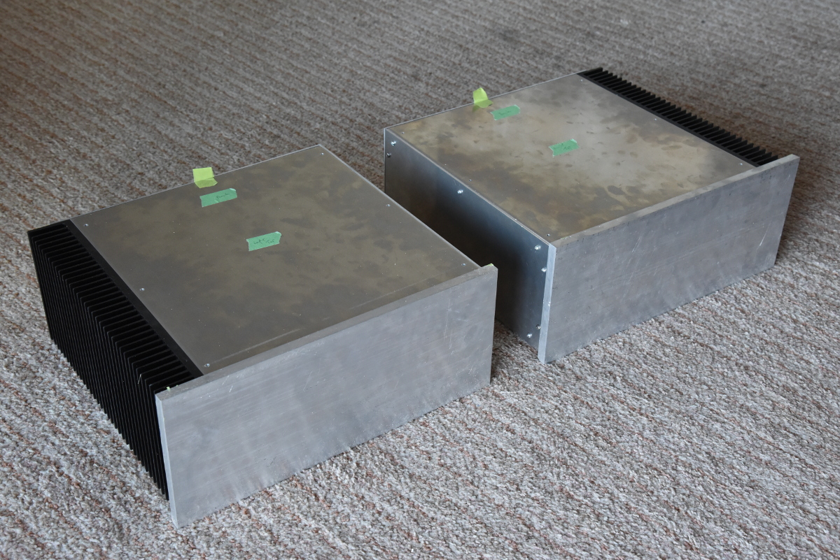

Earlier this year, I built a 2SJ82 source follower amplifier with 2SK82 gain stages. This is an amplifier which I really enjoy, so I decided to build a pair of source follower monoblocks using 2SK180 SITs. For a little change-up, I will use a choke loaded 2SJ28 gain stage instead, and the 2SK180 will be choke loaded as well. The power supplies will be CLC so there will another choke in the mix. So mo' chokes and mo' power. I was thinking of calling this amp Henry or Henrietta, depending on what gender it turns out to be.

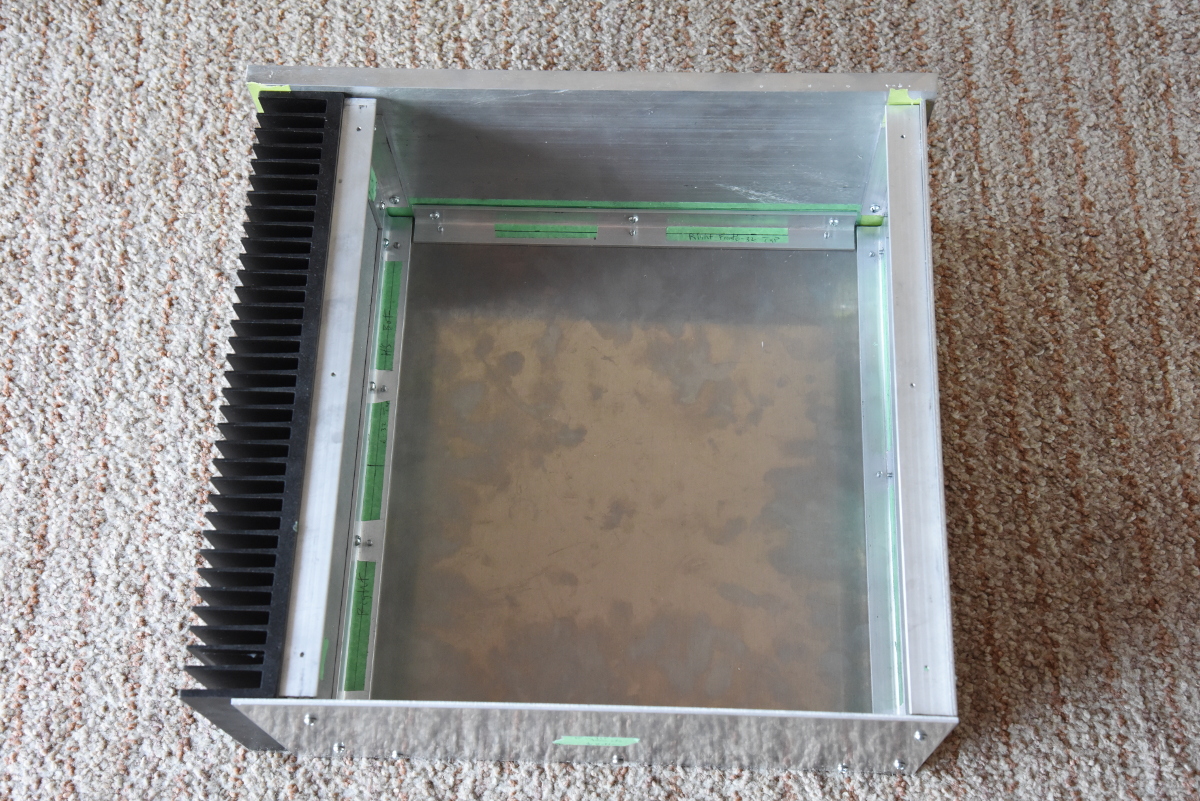

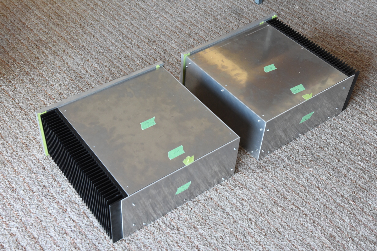

I finally completed fabricating the two cases for the monoblocks today, and that for me, is a major milestone. There is still more work to be done on them but it always feels good when all the pieces fit and holes don't need to be enlarged to force things together. I still need to fabricate the mounting angles for the SITs, drill the back panel, and drill holes to mount the electronics but that will only take a couple of days. Then I will start building the electronics.
The interior of the cases are 13.75 inches by 13 inches so I'll have lots of room to arrange things. The heatsinks are Conrad MF35-151.5 (0.21 C/W for 80C rise).

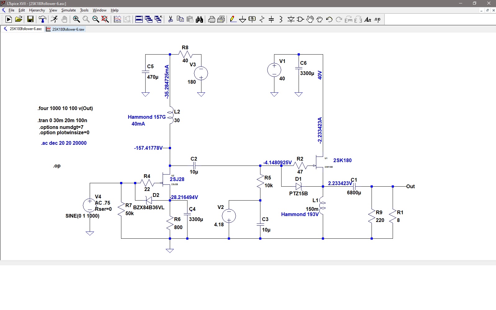

If you need about - 4.148 - bias voltage and you are already developing - 2.33v across the inductor's 1 ohm resistance simply adding a .85 ohm resistor in series with the resistor would give you your required -4.148 v of bias without needing a separate - bias source. Oh you might need to play with that resistor value a little.

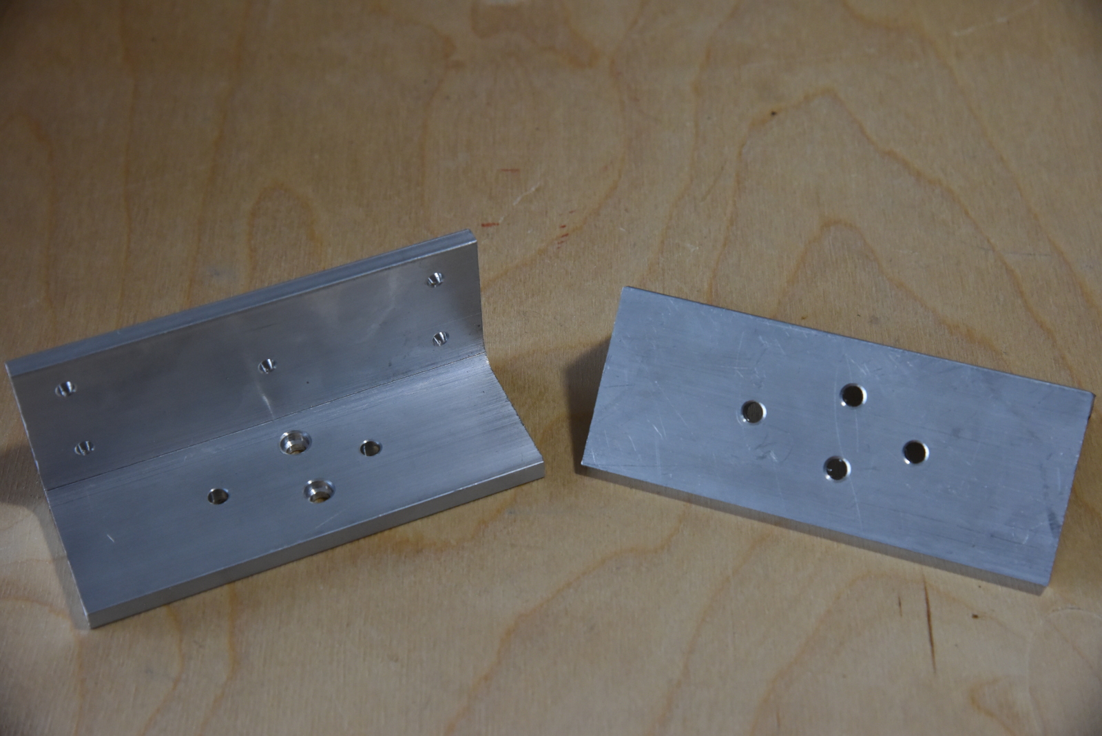

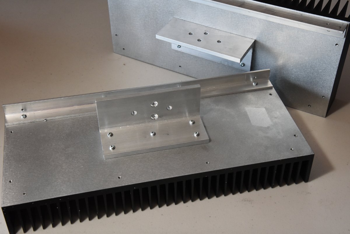

I fabricated the 2SK180 mounting angles today and test fitted them to the heatsinks. The angles are 2 x 2 x 0.25 inches x 5 inches long. Happily, everything fit without any issues. Blind taps into heatsinks are not my favourite things. Since spring has come to the Great White North, I even changed out my snow tires. A productive day.

That's funny. That's the same aluminum angle I use. Easy to get and work with.

I like the idea, but will that heatsink be enough? 88W is a lot of heat. Or do you plan to put a fan on the heatsinks?
This is a choke fed follower amp design I built some years ago, but I didn't choke load the voltage gain stage. I also used Sziklai arrangements in both stages (and MOSFET instead of power JFET devices).

My 2SK82 - 2SJ28 amp dissipates about 68 watts between the IRFP250N CCS and the VFET with the same Conrad heatsinks. The case temperatures are at about 53C while the heatsinks measured at the base on the outside are at about 42C. So, I will monitor temperatures of the 2SK180 when I get it running and decide how hot to bias it and what I am comfortable with. The case plates are all 1/8 inch with 3/8 inch front plate and they will help dissipate some heat as well.
I bought a plug tap to add to my taper and bottoming tap collection and decided to try tapping the holes blind. Using the taper tap, plug tap, and then the bottoming tap in that order works like a charm. Actually, I was more nervous tapping the 3/8" from panel.

I will be building an independent power supply complete with its own transformer and regulation. Its RC timing will be quicker that of the SIT's power supply so it will appear at the gate before the power to the drain. A electrolytic capacitor on the bias supply output will keep the bias voltage up on shutdown. Also, the choke load on the source has a DC resistance of about 1 ohm so it will provide some self bias.

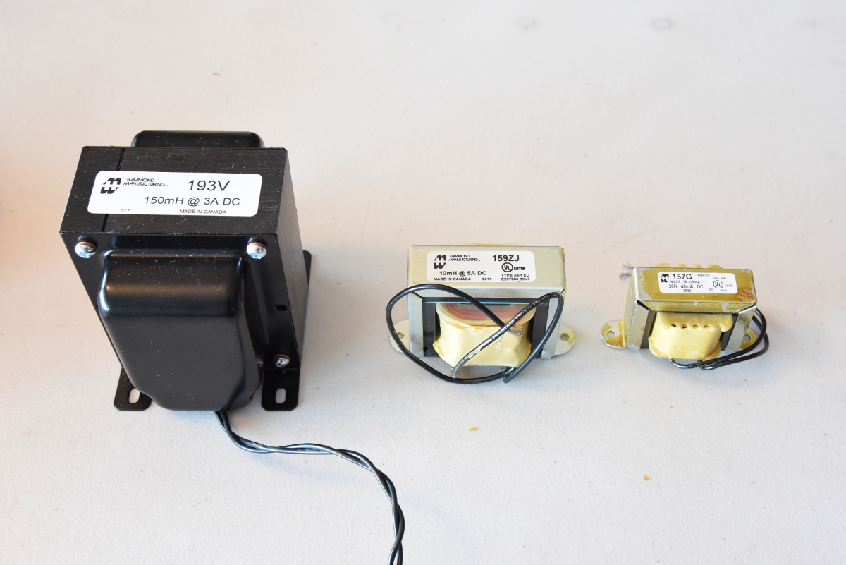

My main power supply will be CLC with 50 mF capacitors and 10 mH choke (Hammond 159ZJ). PSUD2 modelling shows less than 1 mVp-p ripple. I have the same power supply on my 2SK82 - 2SJ28 amp and it is very quiet. I use it to power JBL 2445 and 2405 compression drivers and I cannot hear any noise from them. You can see some test results at 2SK82 -2SJ28 SE Amp.
