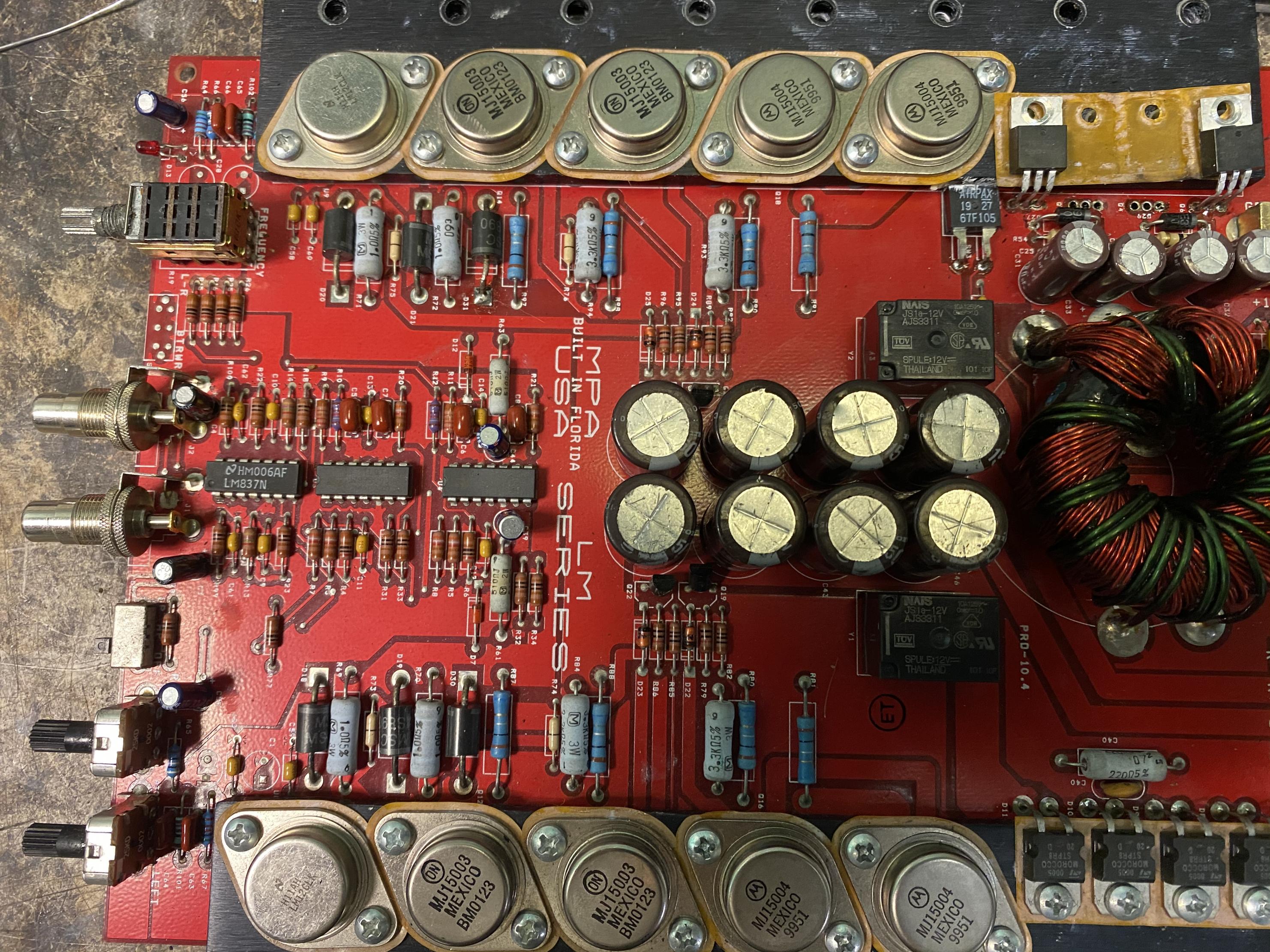

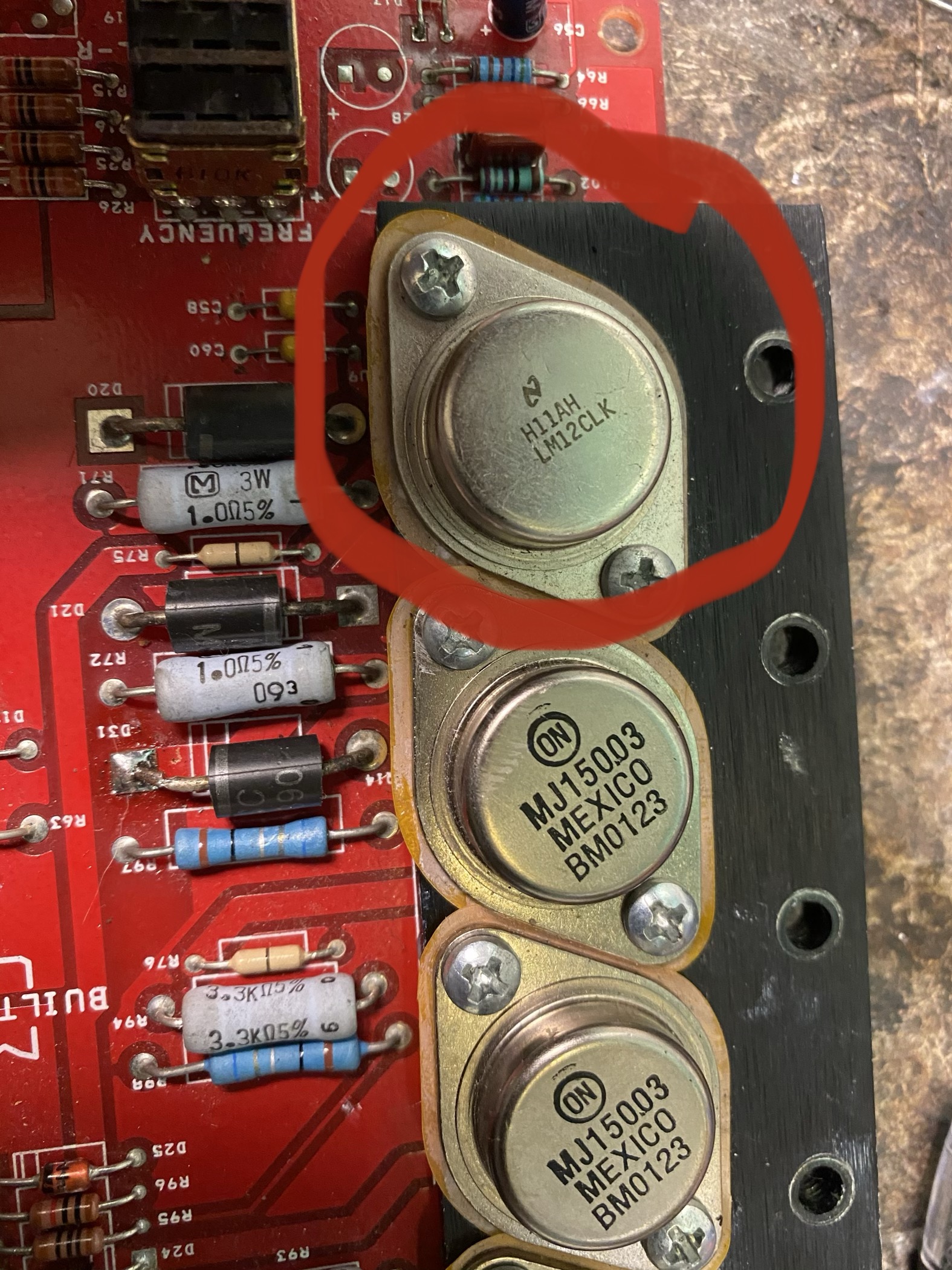

Mmats SQ2150
Amp powers up and idles fine with the fets installed . It produces rail and regulated voltages . But amp powers up with no remote hooked up and the voltage on the remote terminal is 2.89 volts .
Also the amp doesn’t produce any output . The relays won’t kick on
I see audio on both of these .
But no audio on the rest of the transistors
There is audio on the resistors .
I still can’t figure out why I get 4 volts on pin 10 with just power and ground hooked up . The relays so t kick in no drive signal on the gates for the fets and the amp produces rail and regulated voltages with just power and ground hooked up

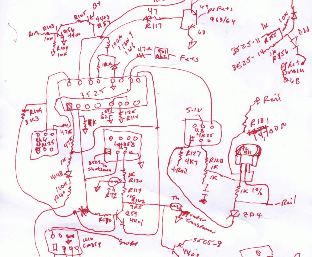

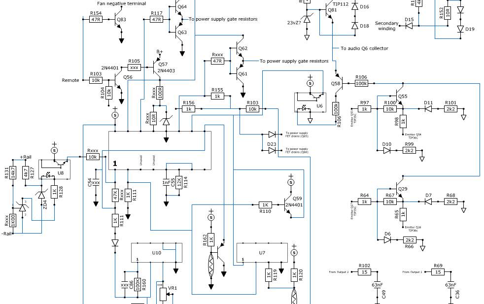

This isn't your circuit and the only similarity is likely the IC. It's just an example of what you need to draw. If you have a graphics program where you can do something neater (second image), all the better.
