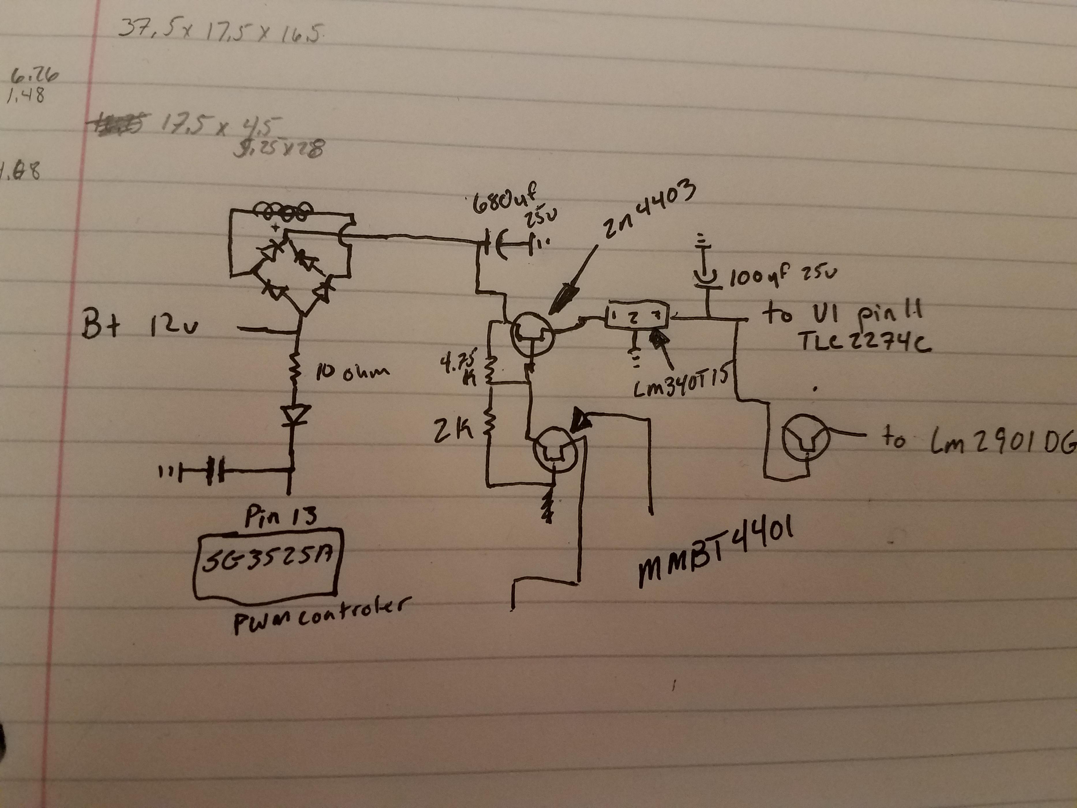

This IC (if used the same way as the 5470 in the Fusion) uses a single-ended supply and will be biased to 1/2 of the supply voltage feeding it.
I tested supply pin13 and bias output voltages pin11 and pin14 on the pwm controller when the supply voltage is at 13.7v the bias outputs are at .5v DC. Now if I back down supply voltage to 8 v on pin 13 my bias outputs has 3.71v pin 11 and 14

Having only your diagram, it appears that the regulator is fed by a combination of B+, through the rectifiers which gets additional voltage from the winding that you have drawn.

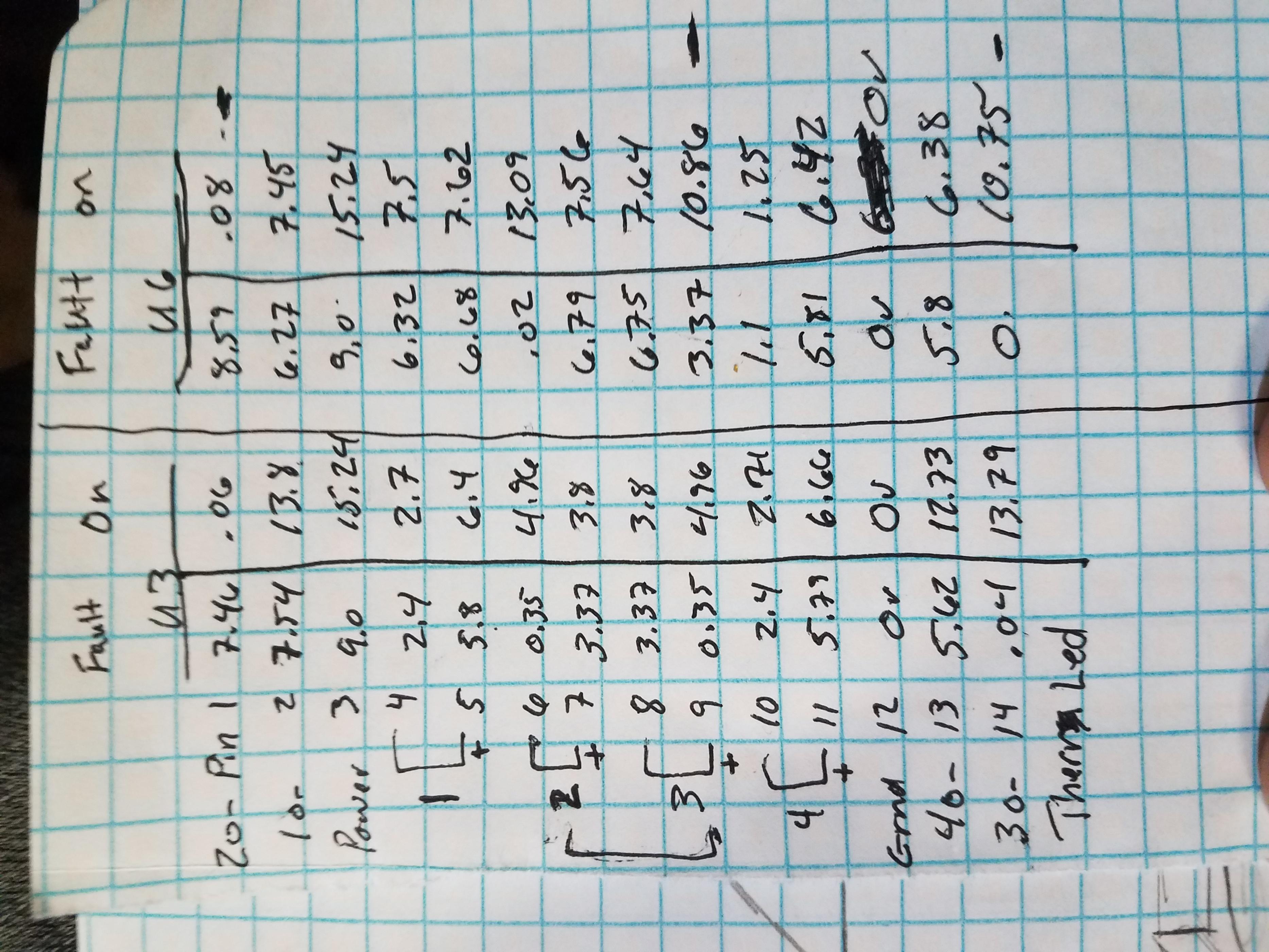

Perry thank you for your knowledge that helps tremendously. Attached is the voltages of u3 and u6. Looks like output 2 and 3 of u3 change. Output 2 is the power led and output 3 is the fault led. The input 2 and 3 are linked to toggle power or fault led. Pin9 high input for 3 goes to soft start pin14 of sg3525. Pin 8 low input for 3 has a pull down resistor that gets fed by pin1 and pin10 of u2 (lm837n). Off of those feeds there are c8 and c15 filter caps to the frequency adjust pot.

So low current was 12.5 rest and 8v through turn on. High current amp turns on but protect light is still on but the remote acts normal. I did notice under high current I am seeing about .06v dc on speaker terminals and a high pitch noise coming from one of the power supply toroids and out of speaker.
I looked at your other post and will compare voltages on u2 and see if I can get the dc voltage down on the outputs.
0.060 isn't significant for this amp. I'd leave it for the last problem to solve.
