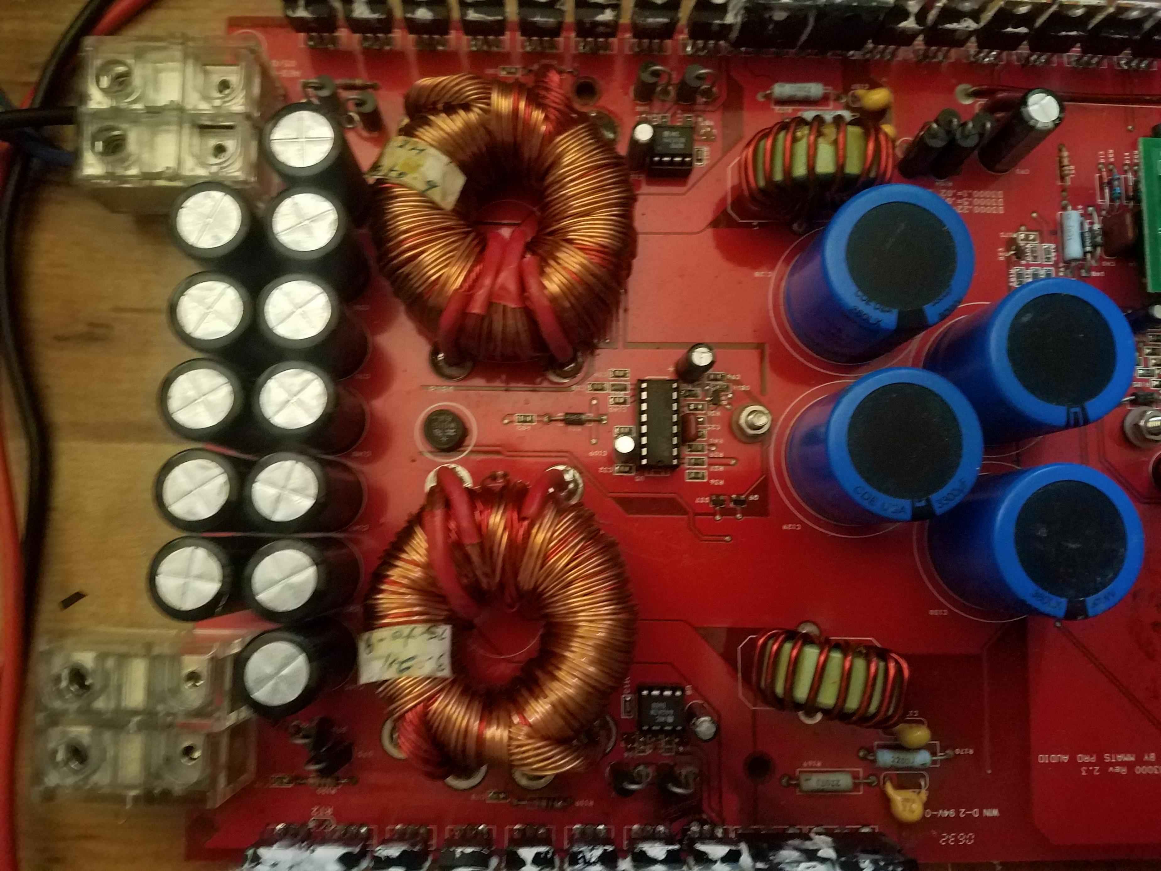

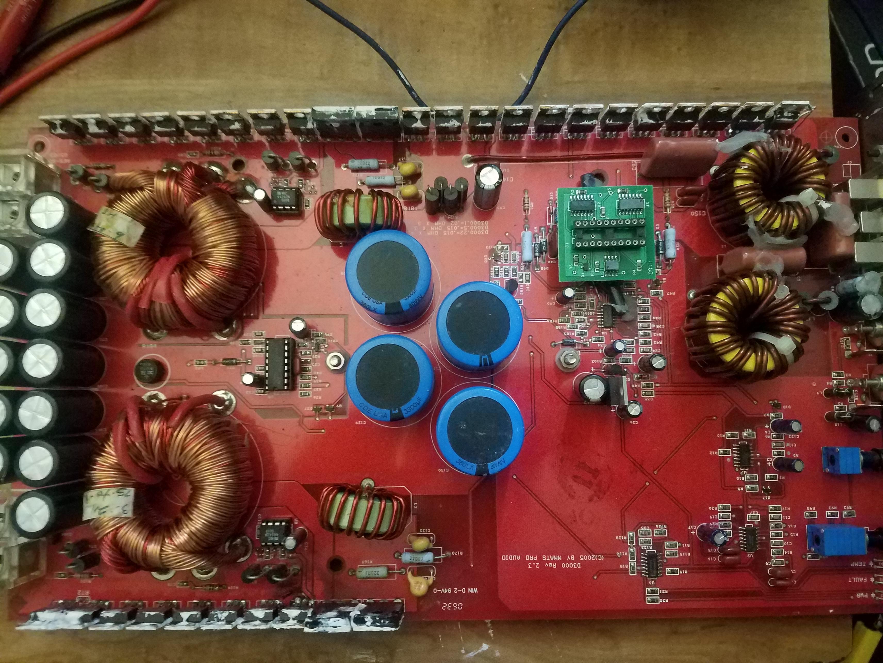

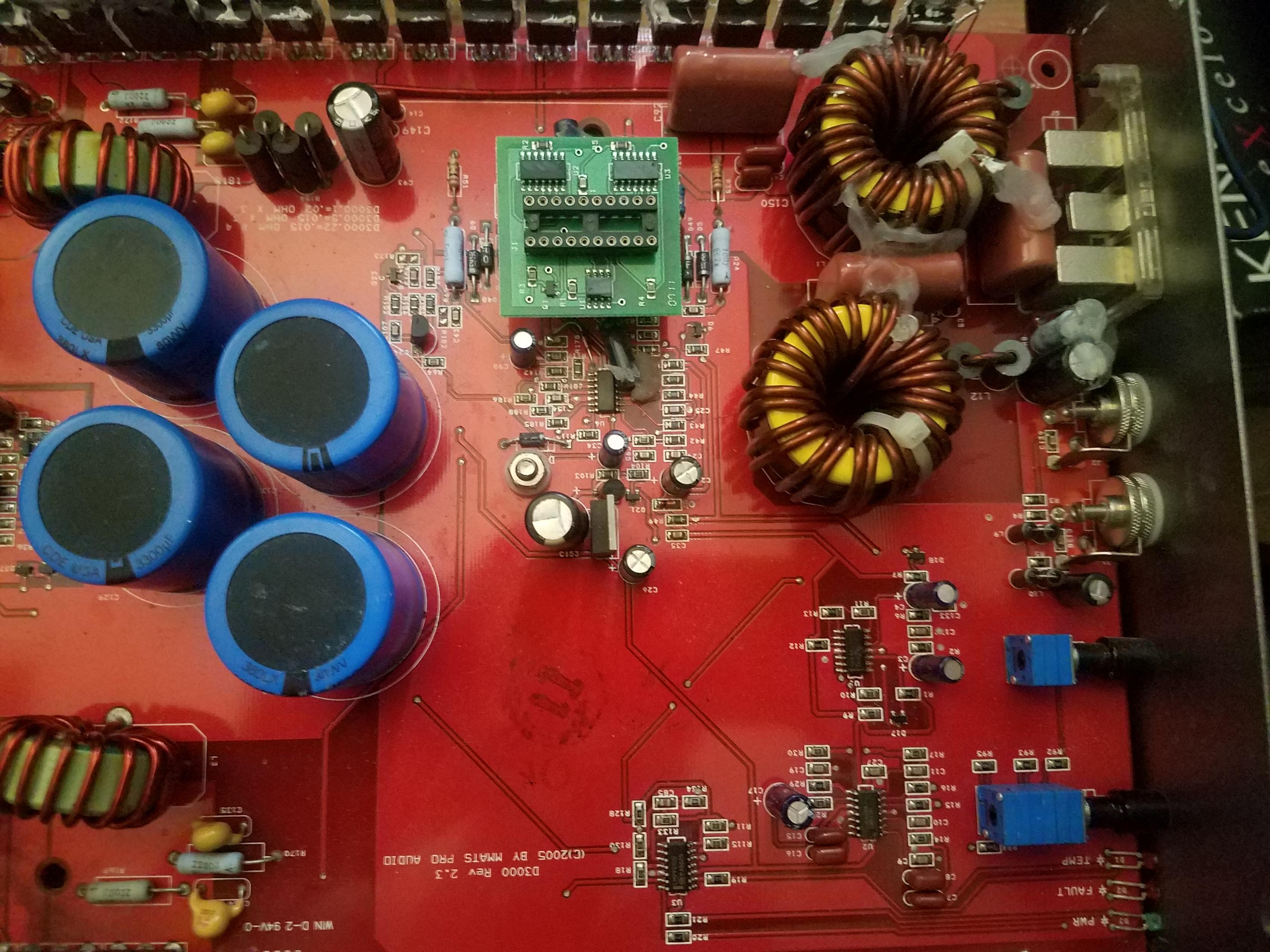

Does the + terminal of the round bridge rectifier (assuming since I'm working blind) go to the input terminal of the regulator?
I also double checked and the output at pin3 is also 14.9v. I do see some discoloration by pin 2 as well.
Ok so + of the rectifier goes to pin 1 of q20. Then pin3 of q20 goes to the input on regulator. If i ohm out + from rectifier to input of regulator I get 65 ohms through q20

Pin 11 has solid ground. Also tested input voltage on the regulator and I have 17v input to pin 1
I think the TLC2274 is the equivalent of the CA5470 in the following diagram.
The driver section is different in your amp. I don't have any diagrams for any MMATS amps.
http://www.bcae1.com/temp/Fusion-FP9001D caramp - 4080 like stealth.pdf
Or IC2 in the attached diagram.
