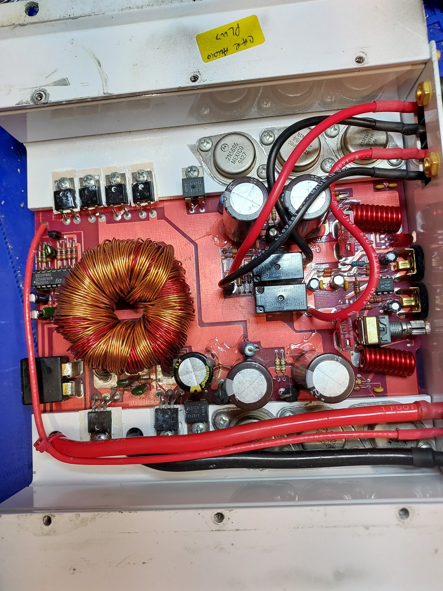

i've tested some 24v relays with just 12v supply and they worked, not sure if its meant to or not (would 24v mean Max voltage it will take? )
The rated voltage is where the relay meets specs but it has a range where it's expected to operate. For the relay in the attached diagram, it's expected to engage at 70% of rated and to release at 10% of the rated voltage. The diagrams show that these numbers can be variable.
The maximum voltage depends on the coil temperature. Many manufacturers give it as about 150% of rated but this varies with the ambient temperature. A hotter ambient temperature will allow less applied voltage because the coil is being heated externally.

Probably the pick up voltage would be the main concern between a 12 and 24 volt relay. The pick up voltage, or must operate voltage for a 24 volt relay is 16.8vdc.
I ordered the relays off of eBay. The original was a Jy1aJEN-DC12V. The ones I got are JY1J-DC12V. I had to buy a lot of 10 pieces. Another seller had them where you could buy 1 but had a minimum order of $15 plus tax and shipping. It was cheaper to pay $29.99 plus tax and free shipping for the 10 pieces.
Same exact relay just with the NC pin. I just cut it off and worked like a charm.
