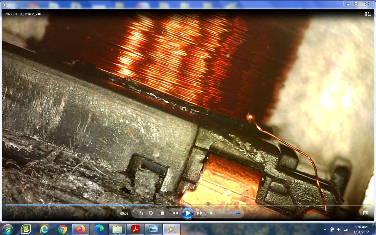

The one for the left channel is. I followed the audio signal and it goes to the relay but doesn't come out. I checked the power to the coil and it was getting power. I pulled the relay and applied power across the coil and got nothing. I cut it open to see if it could be fixed and noticed the darker area around the coil. I checked for continuity and got nothing.
Can you find the end of the wire that was connected to the wire you found?
It's likely that there is/was a shorted turn. If you're lucky, the short is near the broken end and you can take off a turn or two to make reconnecting the wires viable.
Not having any luck. I did find an end to the wire, but the plastic is melted around the end of the coil. This wire is extremely thin and when I try to pull it out it just breaks. I've tried digging away the plastic but that seems to be a problem because it is welded around the strands.

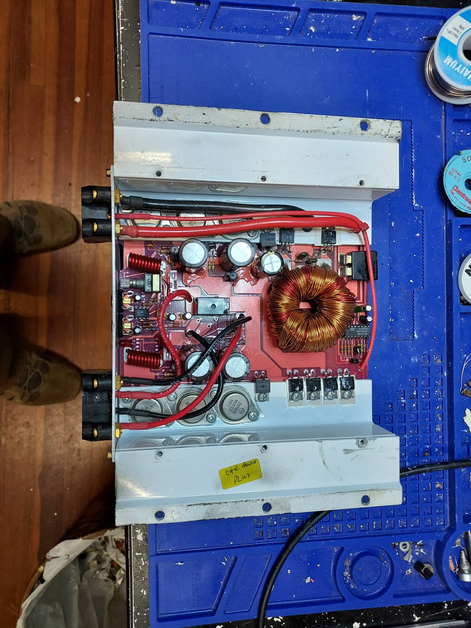

Bypassing the relay would work but would probably render the protection useless. There are fuses in each output just before the relay.

An optocoupler probably couldn't pass audio clean or handle the current.
A 24v could be made to work but you'd have to use the rail voltage (regulated) to make it engage.

If he's absolutely insistent on displaying through the plexi, that would eliminate your first suggestion. If he's flexible on that, that would be the best solution.
If he absolutely wants it to appear original. you could jump the dead relay and use an external relay in the speaker output (hidden). You could pass the trigger wire for the relay out through the grommet used for the other wires.
Didn't you suggest wiring in a different relay but that wasn't acceptable because the owner insisted on using the plexi cover and it had to look original?
He would prefer that it looked original. He will be satisfied if it looks presentable. Most of all he wants it to work.
So your suggestion is to use an external relay?
It's an option if you can get the trigger wire(s) out of the amp. I assumed that it was an old amp that had wires exiting the amp but it could be like some of the older amps that used wires to connect to terminals instead of grommets for wires. There weren't any photos of the entire amp so I'm not 100% sure what you have.
