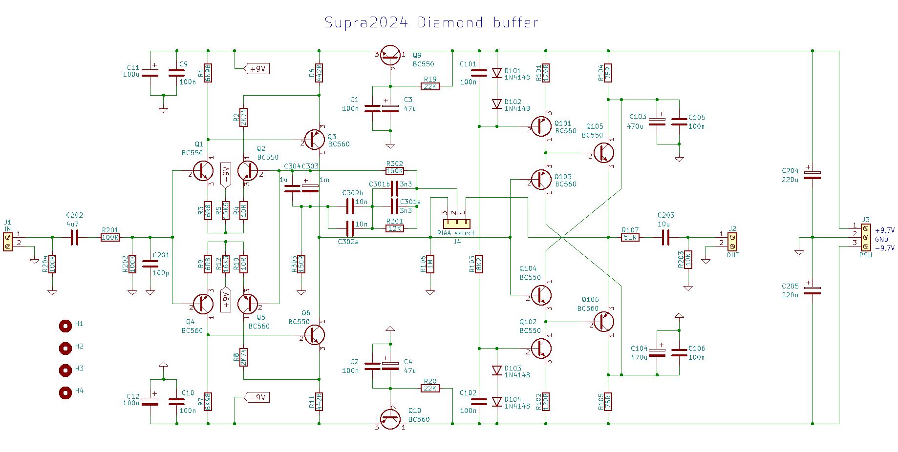

C103 = C304 greater or equal 220µF - i will use 470µF /16Vdc.
R201 < 100Ohm
Resistor (J1) between PIN1 and PIN2, at the input is still missing 😉.

Difficult decision - decide for y-ourself and freely from your gut, no matter what reasons guide you ... a surprise from the layout designer.That said, what is the preferred PSU?
I'm happy with your feelings what is or should be the best one; there is also catd's PSU-Board or other SuperRegulators.
No, it is an additional resistor so that C202 can also find a way to charge or so that a reference to the GND is established.Do yoy mean moving R202 to J1? Between J1 and R201?
1MOhm optional

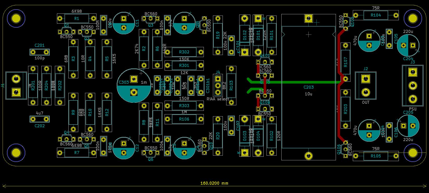

One general comment on modern PCB's.

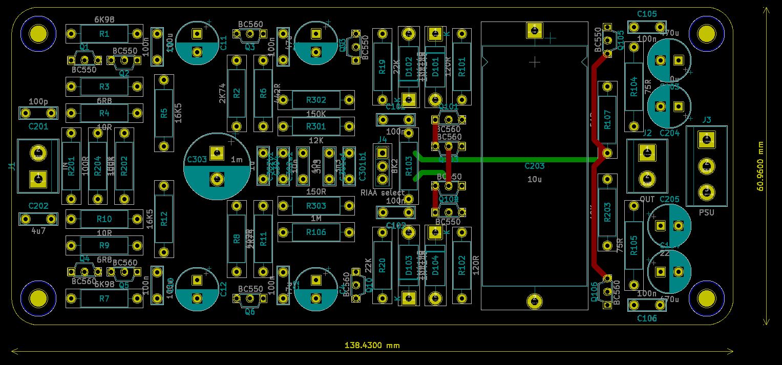

In the old days DIY boards were home "developed" single layer. You had wire bridges and sometimes extended the component leads to make conductor passovers. Capacitors were often axial. These exposed leads were often handy to attach oscilloscope probes to. If it's not too big of a hazzle or this comment is late, would it be possible add some test points? Like common ground, power rails, maybe signal. before the EQ.

Answering without any authority. I for one will use the @catd PSU from the OREAD thread. Others may want to use some super-regulator (suitable name for Supra2024 😀) I think it's to overdo it to include a PSU in this stage.power supply decision
Preliminary attempt Supra2024 PCB. I want to shrink it a bit, though.
