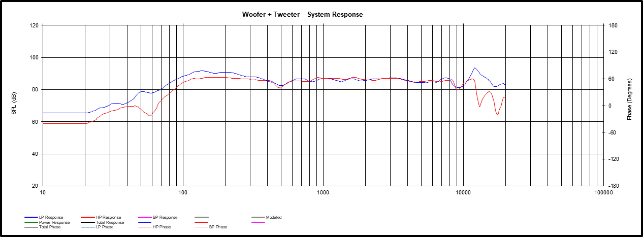

Since you have the miniDSP, why not do a broad notch to bring the 800Hz to 6kHz down?
Here's the Harsch XO thread and how to do it using miniDSP.
S. Harsch XO
1. Set the low pass filter for the woofer as a 4th order Butterworth at central frequency, fc for the XO centerpoint.
2. Set the high pass filter for the tweeter as a 2nd order Bessel at fc.
3. Set the delay of the tweeter equal to 1/2 of the period of one cycle at fc.
4. Use all positive phase on woofer and tweeter.​

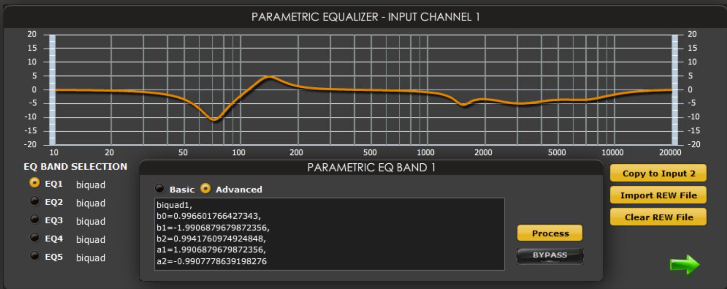

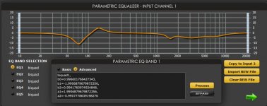

I have just been fiddling and this EQ setup seems to bring the mid-range under control. It also made the top end a bit bright so I brought that down with a shelf by 1db or so. Thanks for the suggestion, is this what you had in mind?
Also, is my crossover point too low for the Harsch XO to work? The MiniDSP won't support a delay of 22ms as I believe half of 90hz is?
It's a little worrying for me that I have had to apply such heavy EQ to tame these drivers. Am I doing or have done something so very very wrong? I'm a bit of an anxious type so this is going to play on my mind! It's all part of the process I guess!

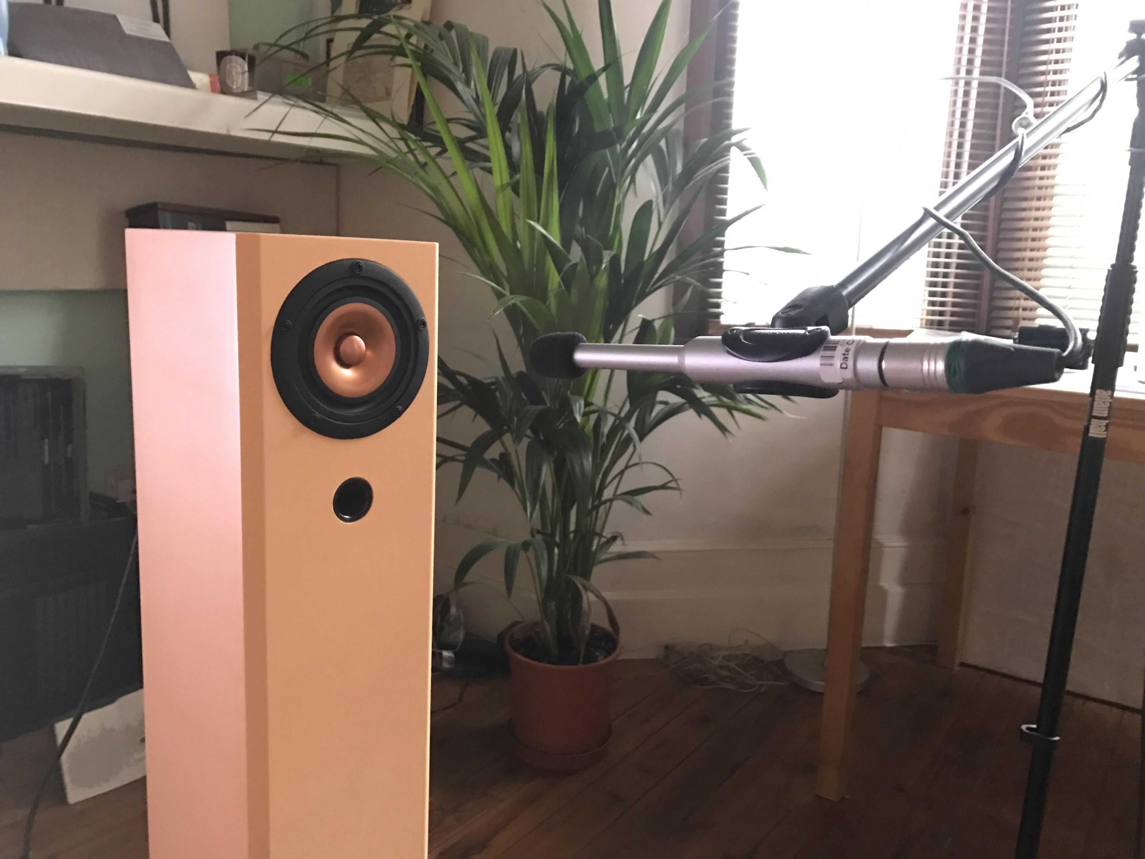

Congrats on an awesome build; the speakers look fantastic.
Regarding the close measurement, I think 15mm is too close for the high frequencies. 80mm (driver diameter) will start to paint a decent picture of the top end, but you might want to try a distance of 185mm. This would put you in the farfield of the frequencies at the top of the spectrum (assuming the entire cone emits high frequencies), and give more consistent results. However, you'll want to position the speakers so the drivers are as far as possible from reflective surfaces. If you can, use the impulse view in REW to determine where the first reflection occurs, and then apply a Hann window with a right hand window length that pushes that reflection down to (or below) -48dB (a good compromise in my experience between reducing ripple and maximizing window length).
A good quasi-anechoic measurement of your speakers would require 3 measurements (the farthest of which would be equal to the baffle diagonal), a lot of tedious post-processing, and difficult to impossible unless you have a huge space or can measure outdoors.
Regarding "omni" measurement mics, I have the Dayton, and 90 deg differs from 0 deg by about 7dB at 20kHz.

Thank you and thanks for your input also!
Interesting, I have a yard I can use to set up the measurement rig. Though, I am not sure I would be able to get high enough or far enough away from my house to irradiate any boundary interference.
I will definitely try your suggestion of 185mm, thanks. Should I be pointing the omni mic at the cone in the way I showed or should I point it upwards at 90 degrees?
Also, just a note: I have 4 Rockwool / mineral fibre panels in my front room. Two 50mm full size panels at side reflection points and two 100mm full sized panels about 2 metres behind my listening position. Could these be employed to help with indoor measurements?

A 45 degree mic position (mic pointing diagonally up) without the boom might help reduce the chance of reflections from the mic/stand itself when doing (non listening position) speaker measurements. Also, if you don't have good mic calibration files, 45 deg should be a pretty safe bet as far as response goes.
The panels could help make quasi-anechoic measurements possible, but if it's simply listening pleasure that you're after, my 2 cents is that you'll get better results (and with *much* less effort) by just working off of a single listening position measurement of each channel.

Graham, If you have not calibrated your mic for 90 degree measurements, I suggest you redo the seating position measurements with the mic pointed straight at the driver as you did for the near field measurement if you want to be able to compare apples to apples.
Even though the omnimic is stated to be omnidirectional, its calibration is done with mic facing straight (horizontal). A 90 degree position (mic pointed up) will thus lead to a falling high frequency response.

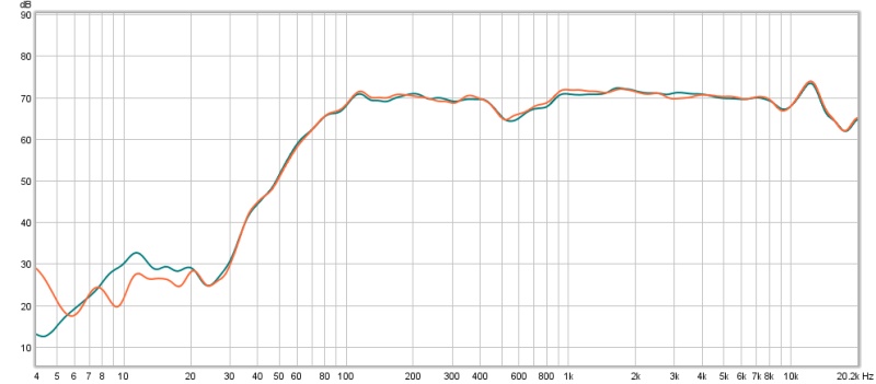

Right! After waiting for a very thorough, noisy and frankly annoying street sweeper and his robotic sweeping van to finish his work this morning, I have finally done some measurements that lead to conclusions!
(It was too windy to measure outside but I am confident of the results)
So...
Measured at 185mm on axis.
Orange is the prototype cab with thick stuffing.
Teal is my finished cab with slightly lighter stuffing as per recommendation from Greg.
attachment.php
I can safely conclude the cabinets are working as intended but for the hump that showed in the simulation at 200hz. This is not an issue however as it is perfect for the intended purpose.
There is so little difference between measurements of the cabs that I can only assume the minute variations are slight measuring differences.
The null assumed to be port behaviour was a room mode as I suspected as I moved the measurement area a little further away from the wall.

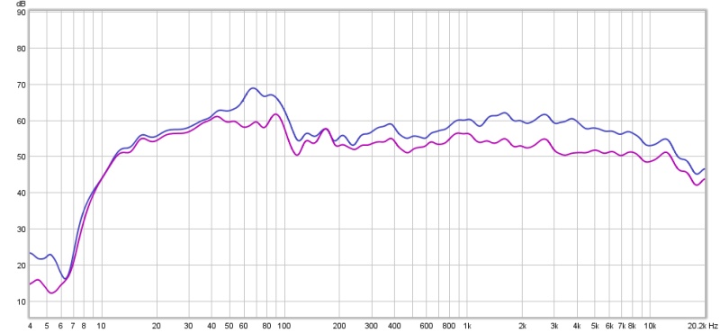

Righty ho, some room measurements have been done.
I measured on axis at listening position for each channel and analysed etc. and and the graph below is the L+R averaged to show the overall difference:
I feel I cheated a bit by using REW to output correction files. They took some tweaking as some of the filters really sucked the life out of the FR. But after dialing back and adjusting I feel I got a much nicer response.
Blue is before EQing.
Purple is after EQing.
attachment.php

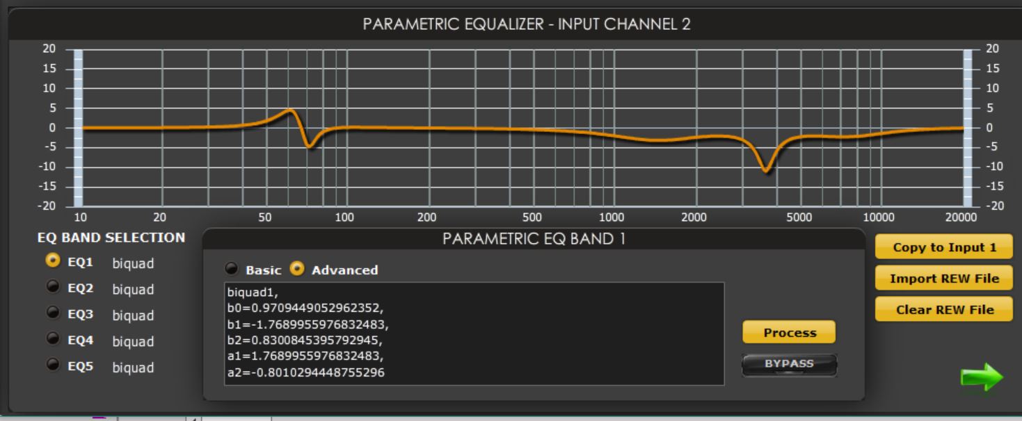

...and these are the left and right EQ applications that have been created in REW.
L
attachment.php
R
attachment.php
The massive adjustments makes me a little twitchy but it does sound very good. Some slight mismatch in FR between the two speakers but I am adjusting minutely every now and then.
Note that the 1500hz-5000hz range as been attenuated quite nicely.
