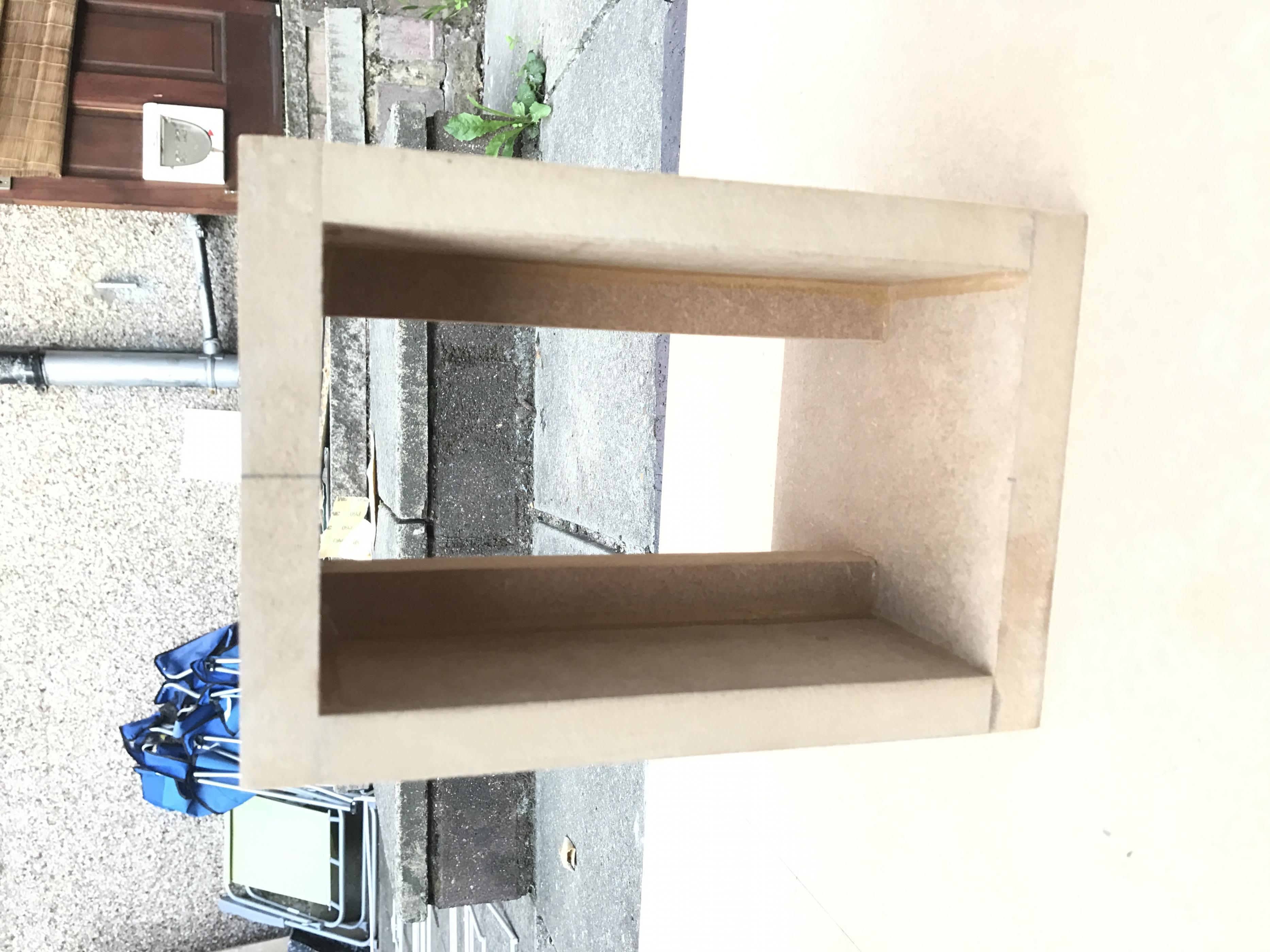

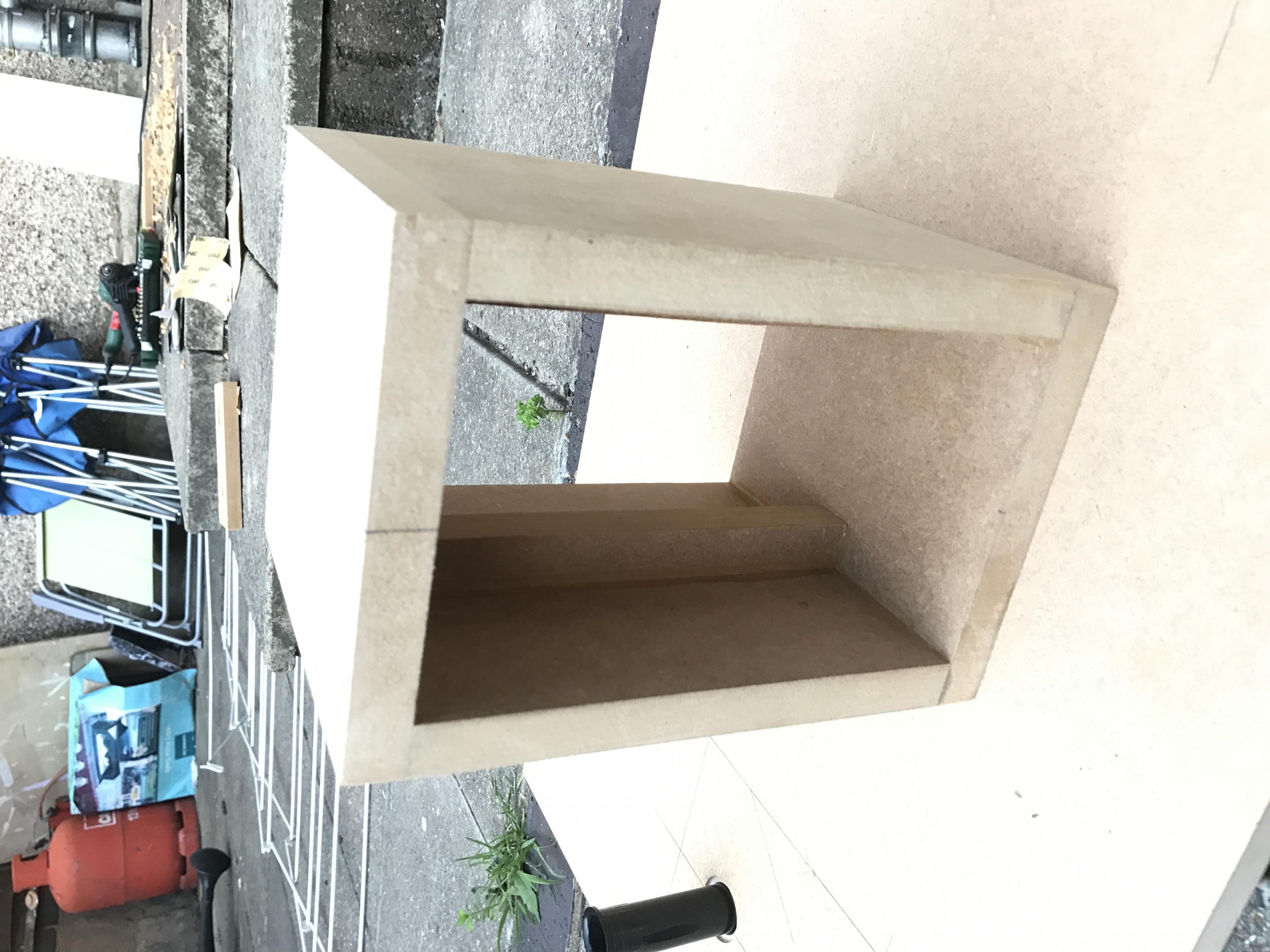

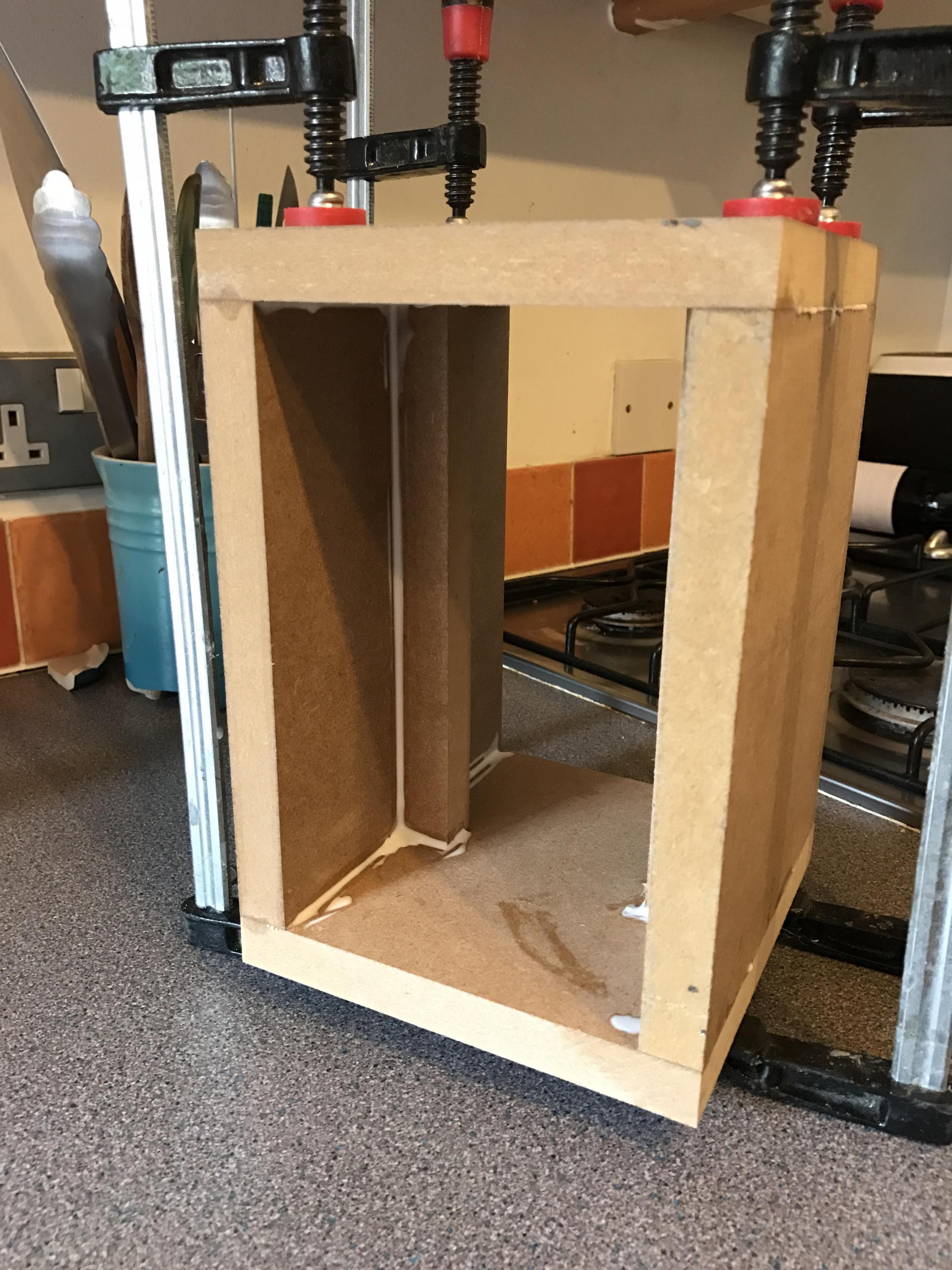

18mm MDF cabinet shells are drying. Baffles will be mounted later then flush trimmed once I have the drivers to make sure my rebates and mounting holes are spot on.
I added some vertical 18mm x 20mm bracing slightly off centre and asymmetrical on opposing sides of the side walls. I hope this will help when employing my idea to bolt the cabinet to the weighted plinth through the bottom of the cabinet by keeping rigidity vertically. I will use an M8 bolt and 30mm washer and spikes inbetween to do this. Please see post no. 38
I wondered if the bracing may disrupt air flow but I (in my limited wisdom) decided it wouldn't. I can always drill holes through them.

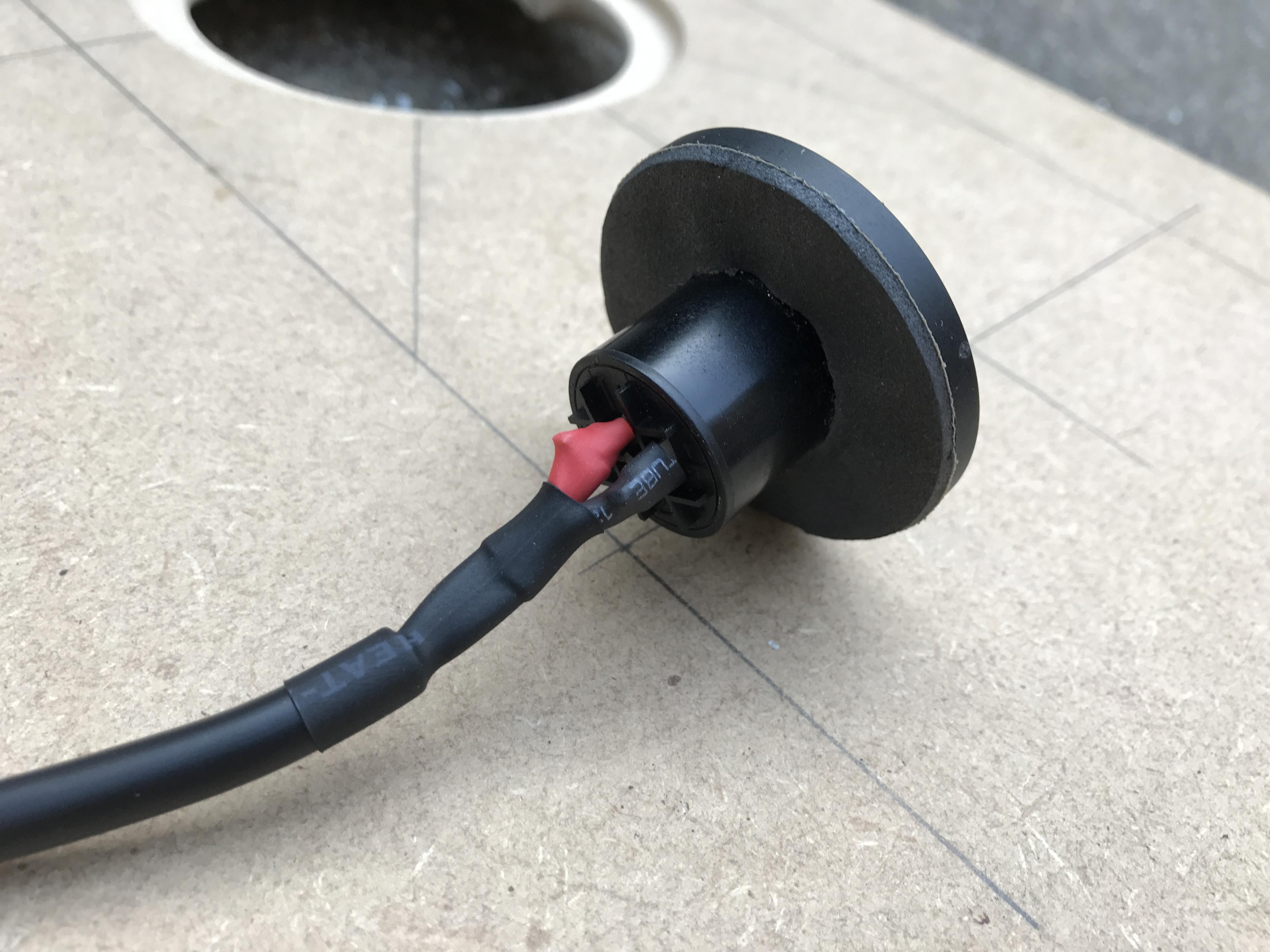

Soldered and heatshrinked my speakons with some leftover van dame 1.5mm cable I have, I managed to get some good mechanical connections and nice flows. The smell of soldering reminds me of something I can't remember but it's a good thing so... great. I also apply 2mm foam around the inside of the speakon socket and tested tight fitting holes for them.

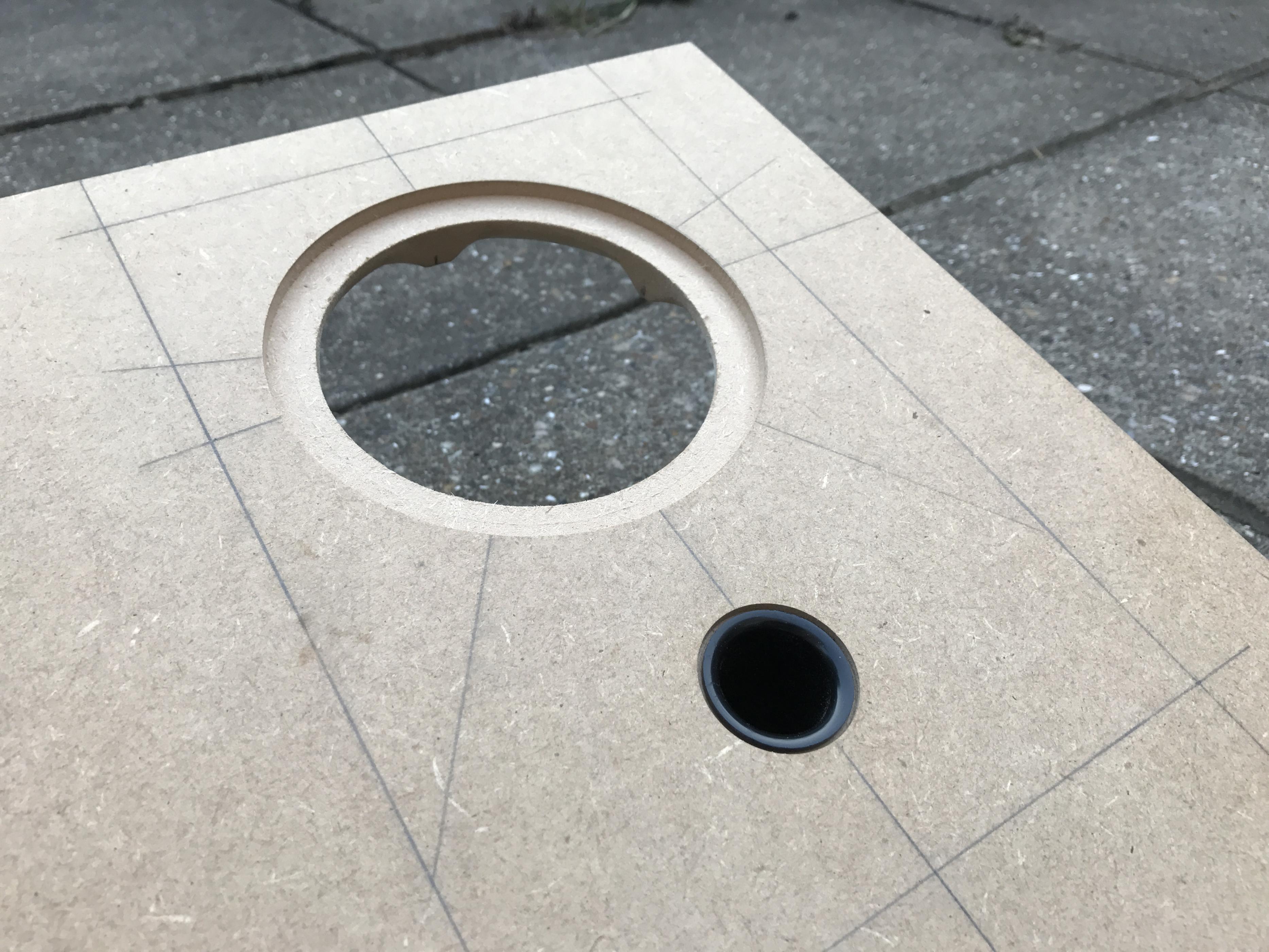

Managed to flush mount my vents. There is about a 1mm gap around the edges due to my router rebate bit not going small enough. I can live with that but I wonder if there is a way to make it perfect?
Also, I'm starting to worry about the braces I put in to the cabs. Will they impede air flow or am I being a hypochondriac. I could (awkwardly) sand them slightly smoother or drill some holes?

Hi Graham,
They are looking great, are you hoping to have the cabinets ready to slip the drivers in when they arrive ?
Re. the gap around the port flare, how are you planning to finish the cabinet ? You could apply some release agent (Vaseline or similar) to the flare & flil the gap with 2part filler, it starts to set in minutes & you could rotate/remove the port before it fully sets, then sand & finish.

7MS, I am waiting til they arrived before I glue the baffle or rear as I have done all routing from the datasheet and haven't measured the actual driver. Hoping it will slip in like... a very slippy thing?!? :)
Excellent idea! I'll investigate that further next month when I have the budget for finishing, thanks!
