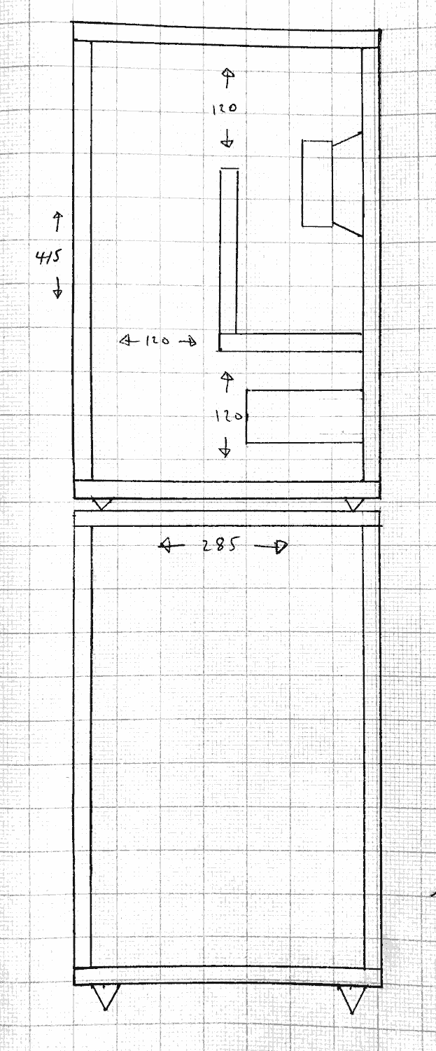

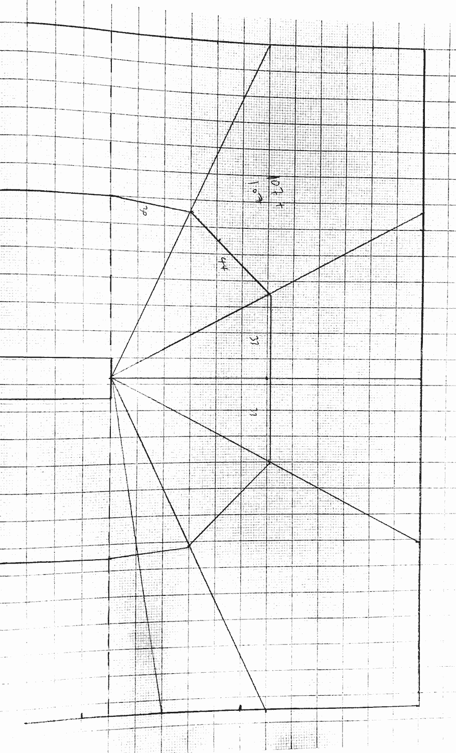

Scott, my solution to my ridiculous constraints I have set myself is this!: I have folded your compact MLTL design and want to take the suggestion of GM to mount it on a weighted base. I took a long look at your Fountek Five folded MLTL and tried to replicate. As mentioned earlier it is the reverse engineering that helps accelerate learning.
I resorted to a 50mm x 110m vent as it goes deep enough to reach your specified 11cm from bottom of the line (actually it is off by 15mm, eek)
My total box volume is larger than the straight MLTL at about 13 litres. The reason for this is that I assumed that you can't simply fold the line, once must account for the path of the wavelength so I drew up a diagram to help me equate the length I should use around a corner. Based on a 12cm line depth I worked out that each 90 degree turn would result in 107mm length. The line adds up to your spec.
Am I on the right track or should I simply fold the line without adjusting the fold path lengths?
Material is 15mm.

7MS is fine for a compact MLTL (an oxymoron in GM & my parlance, but the term will suffice)
~51Hz Fb compact MLTL. V. quick, lightly damped alignment. Internal dimensions:
L = 28.5in
W = 5in
D = 4.75in
St = 5.75in
Sv = 24.125in
Av = 3.14in^2
Lv = 4.5in
Vb (nominal) 11.1 litres [nearly].
Lag all internal walls 3/4in - 1in acoustic fiberglass, SAE-F10 felt, Ultratouch or similar & adjust to preference.

No, I didn't get those fold path length reductions right (if I needed to at all?). I've been searching and searching and I can't find the diagram that shows the difference in measurement for port bends and folds.
I have very little time but that was one of my three abstract queries. The other two being whether the internal vent offset is as specified since the diagram wasn't clear on that front, and noting that the driver & vent locations, notably the latter, will change from the intended positions vis-a-vis boundaries once folded up. The latter is more of an open question & depends on room acoustics & taste; with the vent higher off the floor it won't pick up as much boundary loading.
FWIW, if intending to cross at a relatively high frequency to subs then I'd simply use GM's standmount + high-mass base (with a heavy slab or pot plant added to the top too if possible) as it is better optimised to these requirements.
Note if you want a high mass base for a floorstander, clamp it to a slab of marble, granite or similar as the plinth (and then stick another or the aforementioned plant on top).
Lots of path length discussion in the subwoofer tapped horn threads.
The 71.4 cm plot is currently used: http://www.diyaudio.com/forums/subwoofers/171747-spreadsheet-folded-horn-layouts.html#post2270926
