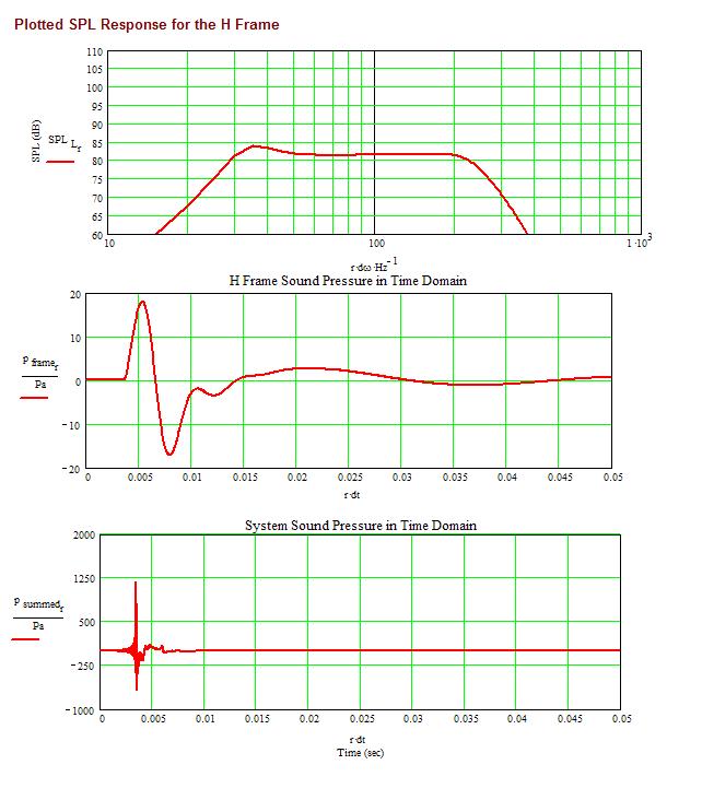

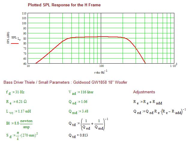

I just substituted the available data for the Davis in the OB+H frame Mathcad sheet.
I don't know if it would be valid without Qes and Qms?
Also I entered 260 mm membrane diameter.
Everything else is unaltered and the dimensions are the same as the ones for the 18 inch Goldwood.
The plots look nice, but I would rather not interpret them as there might be not enough data. If you find full TS parameters, I can run the Mathcad again.

Again nothing except the bass driver parameters is altered. Crossover, geometry, positioning and etc. are as preset by MJK in the mathcad sheet.
If this is true, it would be quite a discovery.
Onform, why don't you send an e-mail to Davis with request for confirmation or a new set of T/S parameters?

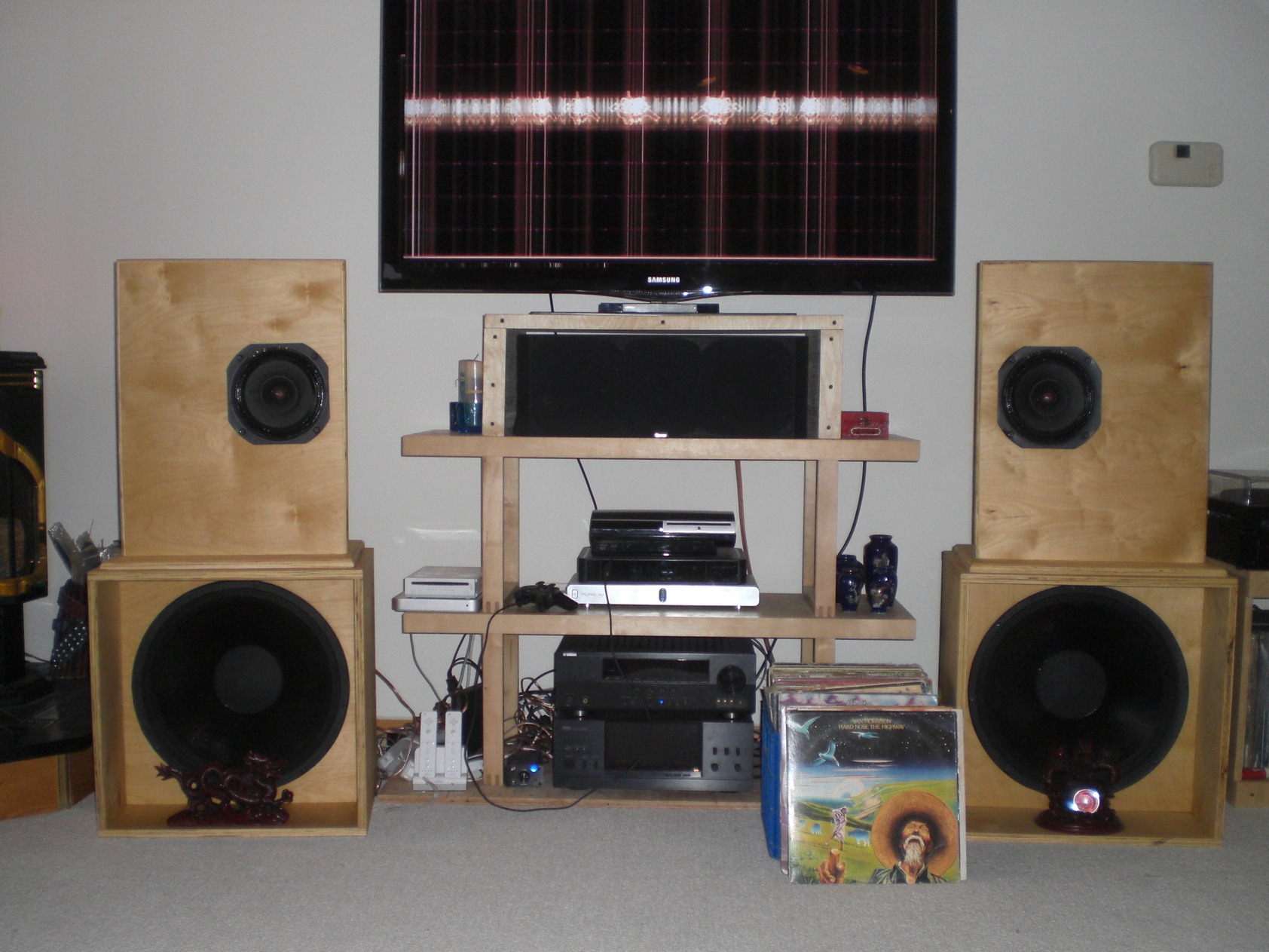

Just finished a pair of Goldwood H-frames (thanks Martin!) with Audio Nirvana Super 8" in a 18"W x 24"H baffle on top. Bi-amping both full range for the moment as I still have not received my miniDSP 2x4 that I hope to use as an active crossover. Dayton DTA-100a t-amp for the top, vintage Yamaha M-65 for the bottom, using each amps volume controls to help balance things out a bit at the moment.

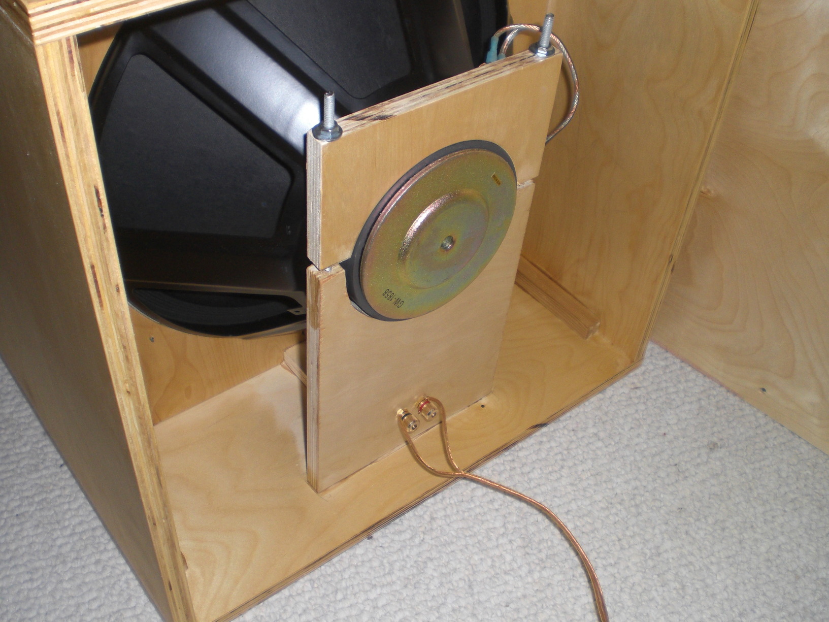

I've also attempted a sort of magnet brace on the goldwoods. Not really a magnet mount since they are still screwed into the baffle but just something to help stabilize vibrations and give me a place to mount the binding posts. Just an excuse to make sawdust really. Thoughts?

They came out nice. Now you have to fiddle with blending the drivers.
I understand my miniDSP 2x4 is shipping today. I have REW, a Dayton EMM-6 cal mic, and a PC. Hopefully between the four of them I'll get them blended pretty soon... although I have to say even with both of them running fullrange I think they actually sound pretty good!
I wouldn't expect much break in difference from the Goldwoods if any at all!
Wait until you hear them with a proper crossover! I have auditioned the goldwoods fullrange, they go surprisingly high and unpleasant too 😀
About the position of the fullranges on the OB, well it seems too off center 😉 this leads to uneven horisontal dispersion diagram. You probably designed the mounting position with EDGE, but it simulates only on axis response 😉 Have it in mind and consider new OB's in the future, especially if you find yourself struggling to align the H frames with the OB's.
