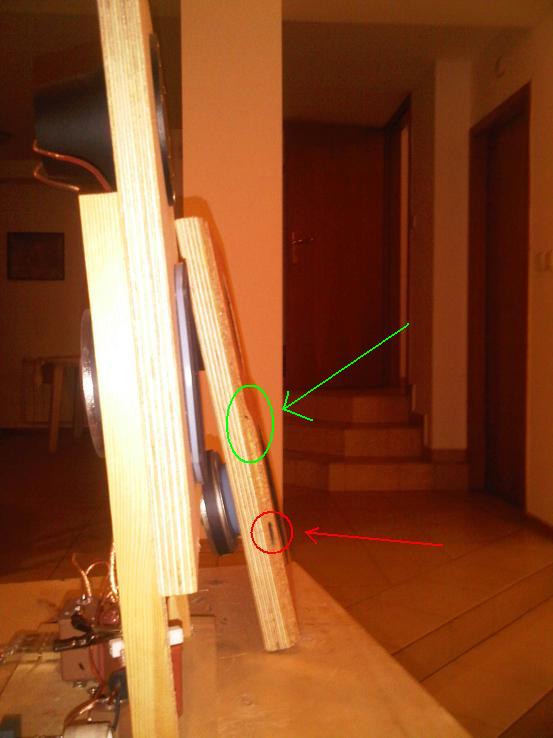

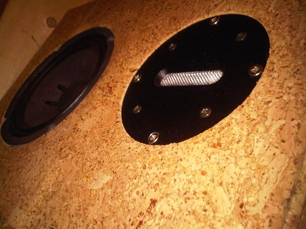

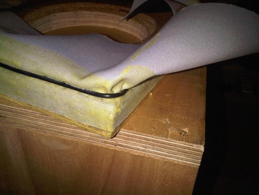

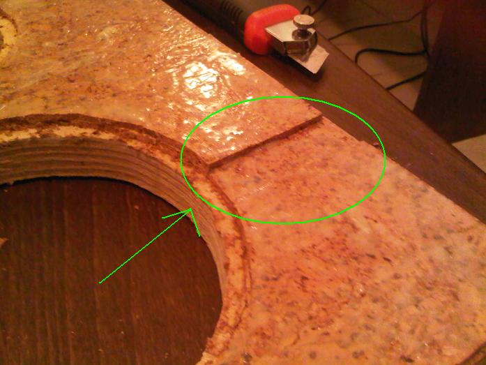

Hi guys, I'm still working on mine MJK H-frames with OB's created using the Edge.
Almost finished the design of one of the speakers. I use Cork and synthetic leather glued with Henkel Moment Universal.
The cork layers on the OB are 3x3mm around the midrange and 2x3mm around the ribbon tweeter. - this in order to make the speakers flush with the front surface.
I don't know what the effect should be, but it seems to me that the sound became more open, natural and even more linear... I'm very happy!
I'm planning to make the rear opening in the baffle for the midrange more slant and wide using rasp file.
For my upholstering skills and considering the fact that I'm not very pretentious and that this is my first upholstering, I'm very happy with the result! Also because of the 3 layers around the midrange and the 2 around the tweeter I got a seamless curvature which I like - marked in green circle in one of the photos.
I also did something completely non-scientific, or anti-scientific... actually it is almost something audiophilic bordering to superstition...
... well: I left two small chambers in the second layer of cork around the midrange... hoping it will enhance the reproduction of solo drums...
and actually solo drums sound better now😕 but is it due to those chambers? Just the pieces of cork left from upholstering of the H-frame were sized in a such way that it lead me to that conclusion... I had all needed material for full 2nd layer, but decided to give it a try...
Now when you test with knocking with finger the front surface this area gives a sound similar to solo drum... 😕 and solo drums sound better and more natural...
Is this a sonic crime what I did? 😱
Here are some photos:
(the chambers are in green circle in the close up and in red from side)

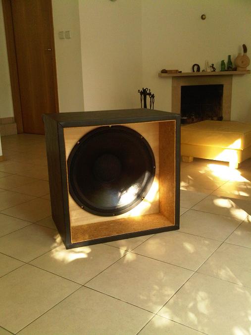

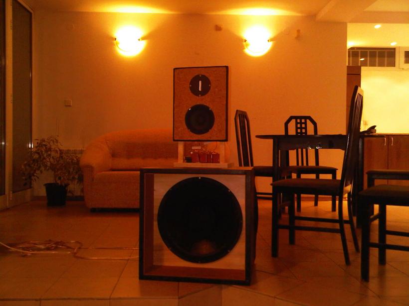

Set up the H-frames again after listening for months to pure open baffles. The H-frames sound better in my room. Fuller, richer with more fine detail. Complicated bass lines can be followed more easily. My son spent a couple hours with me last night (he fractured his foot at karate) listening to 80s music. Lots of synth, heavy bass lines and all sorts of fun nonsense in that great era of music (Yaz, Squeeze, Pet Shop Boys, Blondie, Split Enz, etc). We both enjoyed and he commented that the H-frames sounded 'really good.'

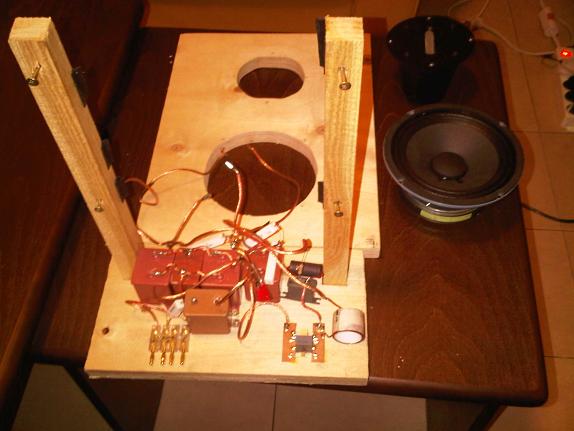

G'day all
I am building a set of these as my first DIY project. I have managed to get the drivers to OZ but I am now having some problems with the crossover components. The inductors are easy as is the 51 uF cap. What I am in a bit of a dilemma about is the 150uF one. MJK's design specifies a 150uF 400V Erse cap, but I can't seem to fine one. The Erse website lists a 150uF 250V cap
ERSE - PulseX
but in the 400V range there is a gap from 130uF to 160uF.
I can see three basic options:
1. Use the 250V cap. This keeps the crossover characteristics but I have no idea of the consequences of reducing the voltage rating.
2. Substitute a different valued cap. This will change the characteristics of the crossover. Will this be noticeable and should I go up to 160uF or down to 130uF.
3. Use two 75uF 400V capacitors in parallel. Mathematically the same, but does this change other characteristics?

Hi Martin
Thanks for the advise. I have gone with the 150uF/250V option. I will post some pics once it is all assembled (though this will probably be a couple of months with shipping and my [lack of] skills).
Tim
