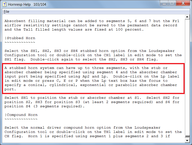

As I recall (speaking under correction) Hornresp doesn't currently have the option of adding a Helmholtz resonator at x distance along the horn expansion path, which is the main feature of Martin's design. I've no doubt David could add the facility in time if it doesn't. Off-hand the only widely available software that I know of that currently has this facility is Akabak and AJHorn.

Hi Scott,
Not a problem 🙂.
I just thought it worthwhile to let people know that an absorber chamber can indeed be specified in Hornresp, if so required.
The irony is, on doing a quick simulation it seems that the absorber chamber used in Martin's back loaded horn design has virtually no effect on the response, if filling material is added to the system as specified.

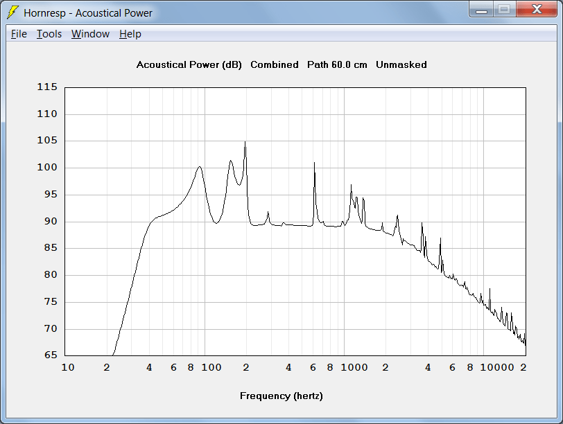

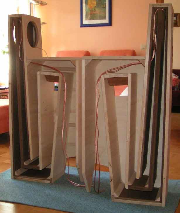

How do I add the chamber?
Horn
Section cm2/length cm
S12 45 /27 filling 6 g/dm3
S23 90 /48 filling 6 g/dm3
S34 158 / 53 filling 6g/dm3
S45 248/ 65
S56 452/ 18
DriverChamber 3.8 dm3 depth 14 cm
ResonanceCahmber 3.5 dM3 with a port area of 62 cm2 and 1.2 cm

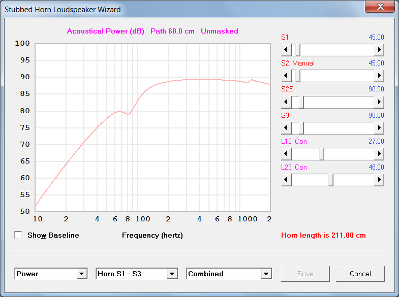

David,
So the filling the the chamber flattens out the absorbance dip. How does the response looks if the chamber is empty or perhaps covered with 10mm felt but with the main body of the air volume free of resistive damping fibers.?

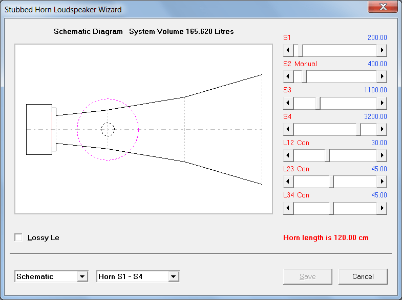

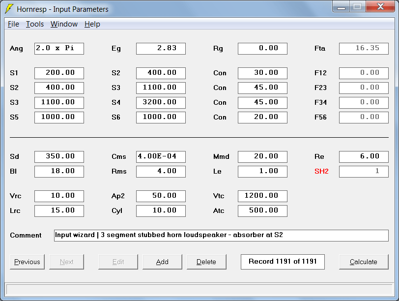

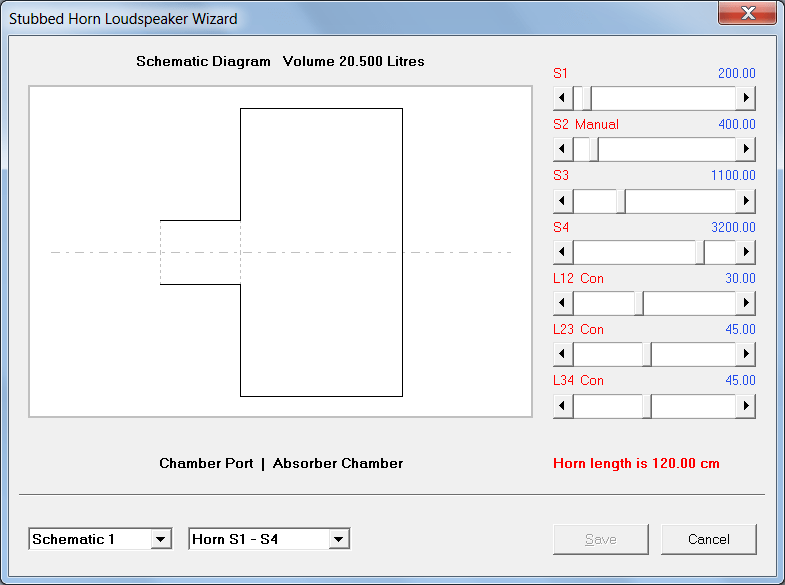

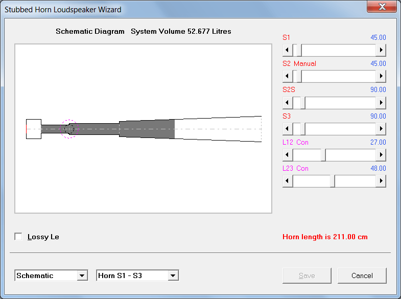

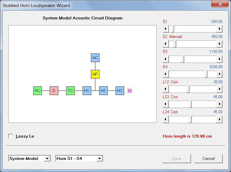

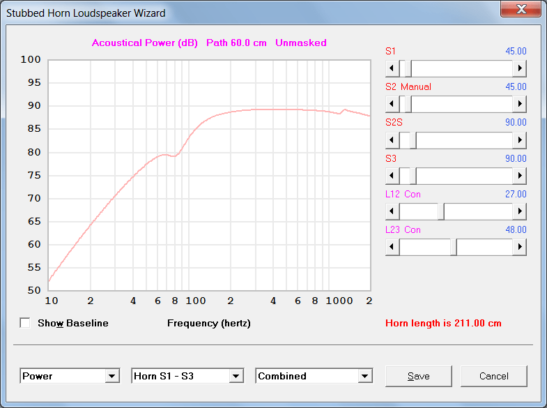

The required input parameter values for the system given above are shown in the attachment. (The Hornresp model has only three segments because the fourth segment is used to specify the absorber chamber).

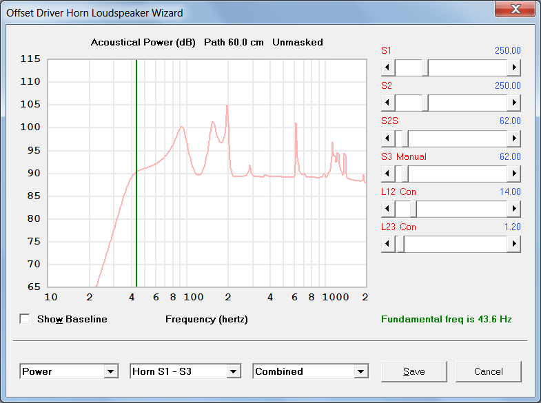

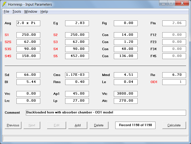

Dear David,
That is a quite scary looking graph!
As I understand it that is with the HR-chamber empty, but is that with fibers in sections 1-3 or are they empty as well?
I will try to make the final measurement in an outdoor corner and measure the summed respons at 2 -3 meters.
Hi DrBoar,
I thought the same thing myself when I first saw it, and was a bit surprised that Martin would use it as the basis for a design. I was a little concerned therefore that perhaps the Hornresp stubbed horn model might not be working correctly, so I simulated the same system using a completely different method. Reassuringly, the results were identical so I am confident that the model is okay.
Attachment 1 shows the input parameter values I used to check the model. An OD1 loudspeaker configuration was used, rather than the original SH2 one. Attachment 2 shows the original SH2 (stubbed horn model) response and Attachment 3 shows the OD1 (offset driver horn) response. As you can see, the results are identical.
I interpreted "but with the main body of the air volume free of resistive damping fibers" as meaning that segments 1 to 3 were to be empty as well.

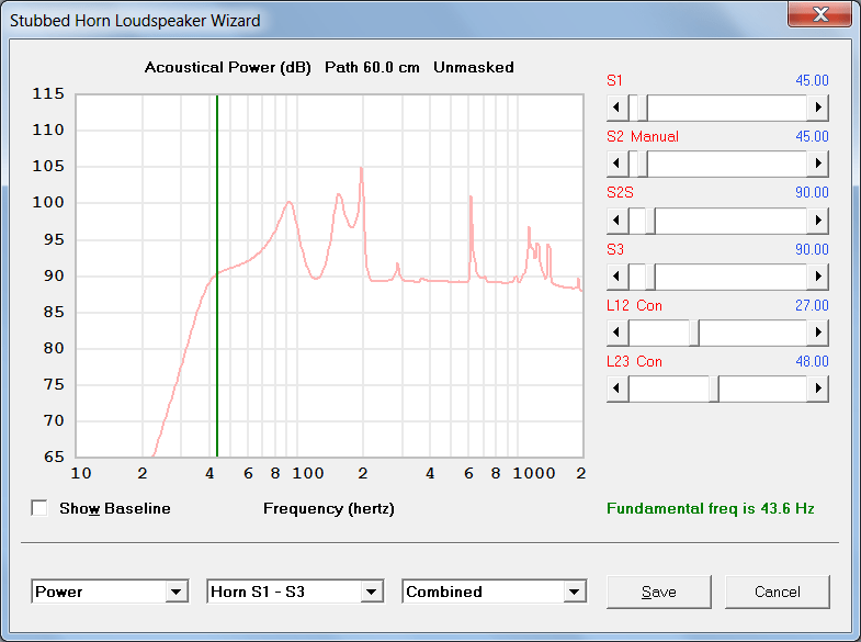

With filling material added to segments 1 to 3 as specified in your earlier post, but with the absorber chamber empty, the response becomes significantly smoother. Attachments 4 and 5 refer.
With filling material already in segments 1 to 3, there is no virtually no change to the response if filling material is then also added to the absorber chamber, as shown in Attachment 6.

David, my hero!
Thank you for your tireless work with Hornresp.
I am currently at a chromebook but when I have my PC I will try to look on how much the horn with and without fibers reduce the output of the driver.
As I see it the purpose of a horn/quarterwave pipe is to incresease the radiation resistance of the driver to enable more output/lower distortion. If it does not what is the point of such complicated construction? A bassreflex box offers incresed radiation resistance over a limited range, to be meningful the CBLH and any other complicated design has to be "better" than s simple one. And in this case with 5" fullrange drivers with small surface area and very small x-max, "better" is more radiation resistance with a resonable tradeoff in resonances, peaks and dips.
With regard to the HR chamber, a online calculator suggest the resonance frequency to be 650 Hz.
