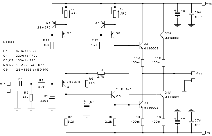

But please, don't say that the MJ15003 poses a problem, it is precisely this output set that I chose for my amp which has been running almost 24/24 365 for ten years with 23V dc 1.4A bias and I am very far from be the only one to have chosen these output transistors.

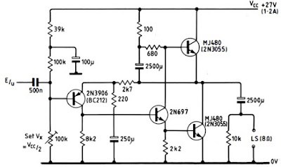

I'm only highlighting what I see from the datasheet. From my comments, you should be able to see that a change in standing current is about 30% which I should have added is for Tj 25C to 175C. That is the extreme, so if your heatsinks are large enough, that should be enough to prevent thermal runaway. It does mean ensuring the heatsinks are able to handle the heating which I suggest should be reckoning on keeping the junction temperature as low as possible. I typically aim to keep heatsink temperatures below 75C (hotter than 50 or 60 (I'd have to check) is now a recognised safety hazard and needs a cage if it is hotter).
Of the JLH's I've built, I must say that I've never used a heatsink with a thermal resistance higher than about 1C/W. Test circuits I have explored have been with old Redpoint 0.55C/W, (both devices on it though) and the worst case I've measured is with 2N3716's which showed an increase in standing current of about 20% over an hour's warm-up time. Though I have not tried MJ15003's, I've seen stable circuits (i.e. not thermally running away) with MJL3281A's and 2SC5200's.
Never had the inclination to test Chinese kits. Would not be surprised if the heatsinks are too small.
If using the original JLH circuit, then some form of current source in the driver only, as shown in huggygood's post, can be applied without using split rails, so the rest of the circuit is more like the original. Q7 could be mounted on the heatsink and would provide some compensation, though I think the actual bias circuitry should be better designed. The possibility for a shorted potentiometer (VR2) is not good practice, but the downside is that the CCS will eat into the voltage margin and may need a higher rail voltage (or the driver rail higher than the main supply) to maintain the output.

It should be possible with most present day, genuine MJ15003 product, to adjust the bias level with the arrangements shown in the original magazine articles. You will need to check that bias with no signal remains stable over 1 hour or more, however.
www.keith-snook.info/wireless-world-magazine/Wireless-World-1969/Simple%20Class%20A%20Amplifier%20-%20.pdf
The problem I found with MJ15003 was considerably higher gain, higher at least than any 2N3055 examples I had in the parts box and it was unstable at 1 amp. collector current and on a heatsink which was comparable to JLH's, as shown in the magazine article. Check the comments on this power transistor gain matter here by John Ellis at #10.
A larger heatsink may have fixed the overheating but I was unaware of what was wrong and it was about 30 years ago, so it had to wait for answers until more recent times.

Circuit posted by huggygood is penultimate high power JLH version. Nice sounding amp. Capable up to 45watts classA, depending on power supply voltage. I biased mine at 1.6A and still use forced air by fans on top of heatsinks. Someone on that page discussed the sound and recommended 4A bias! I do not like to run things hot, i like reliability.

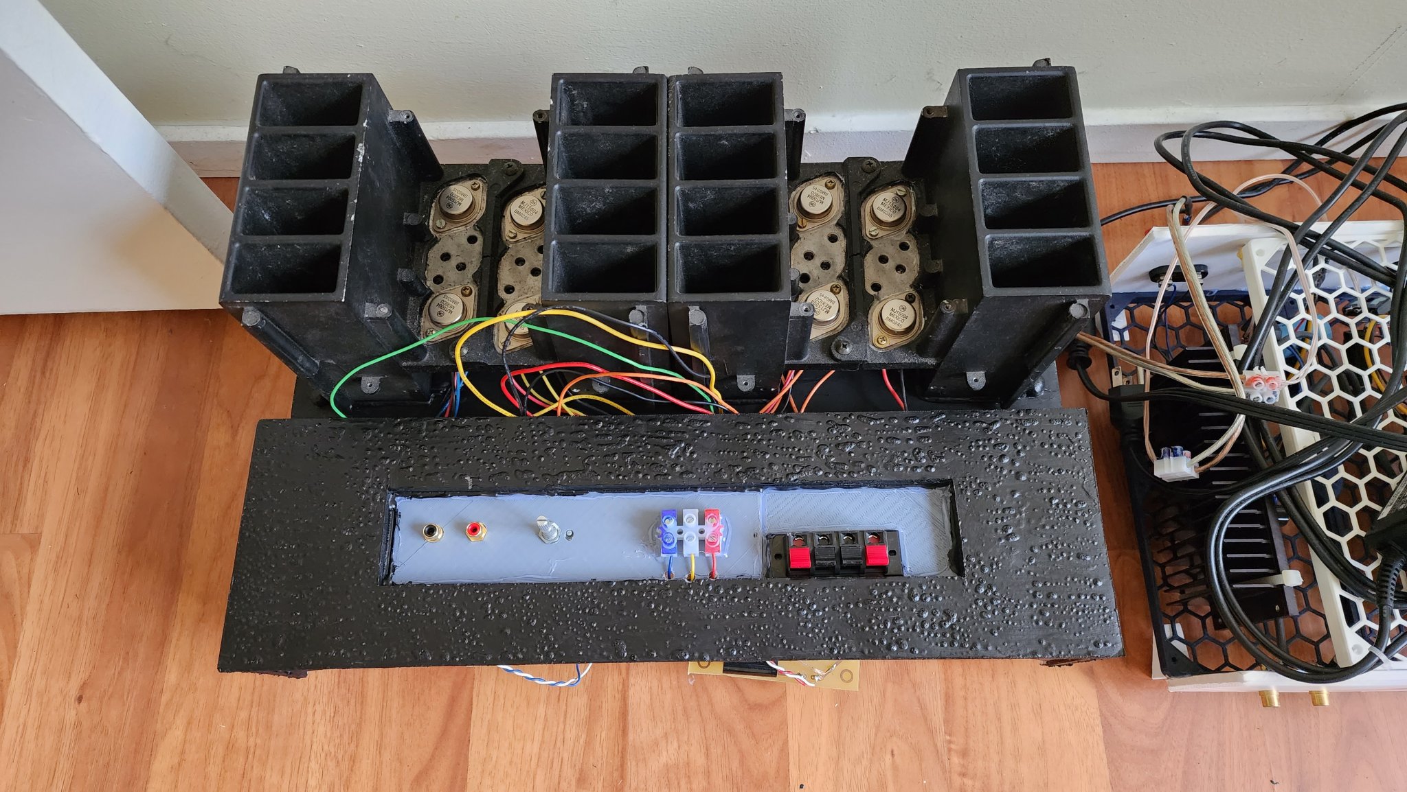

I built this one two decades ago, with original outputs from digikey. Occassionaly i fire it, just to enjoy the sound. Yes, its ugly.
