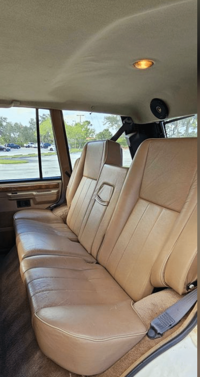

The vehicle has 4.5" speakers in the rear above the hatch in the headliner. I wanted to run those too, but substitute 6.5" somehow.

Attached is an example of someone putting a Kicker 46CSC654 in the headliner.
