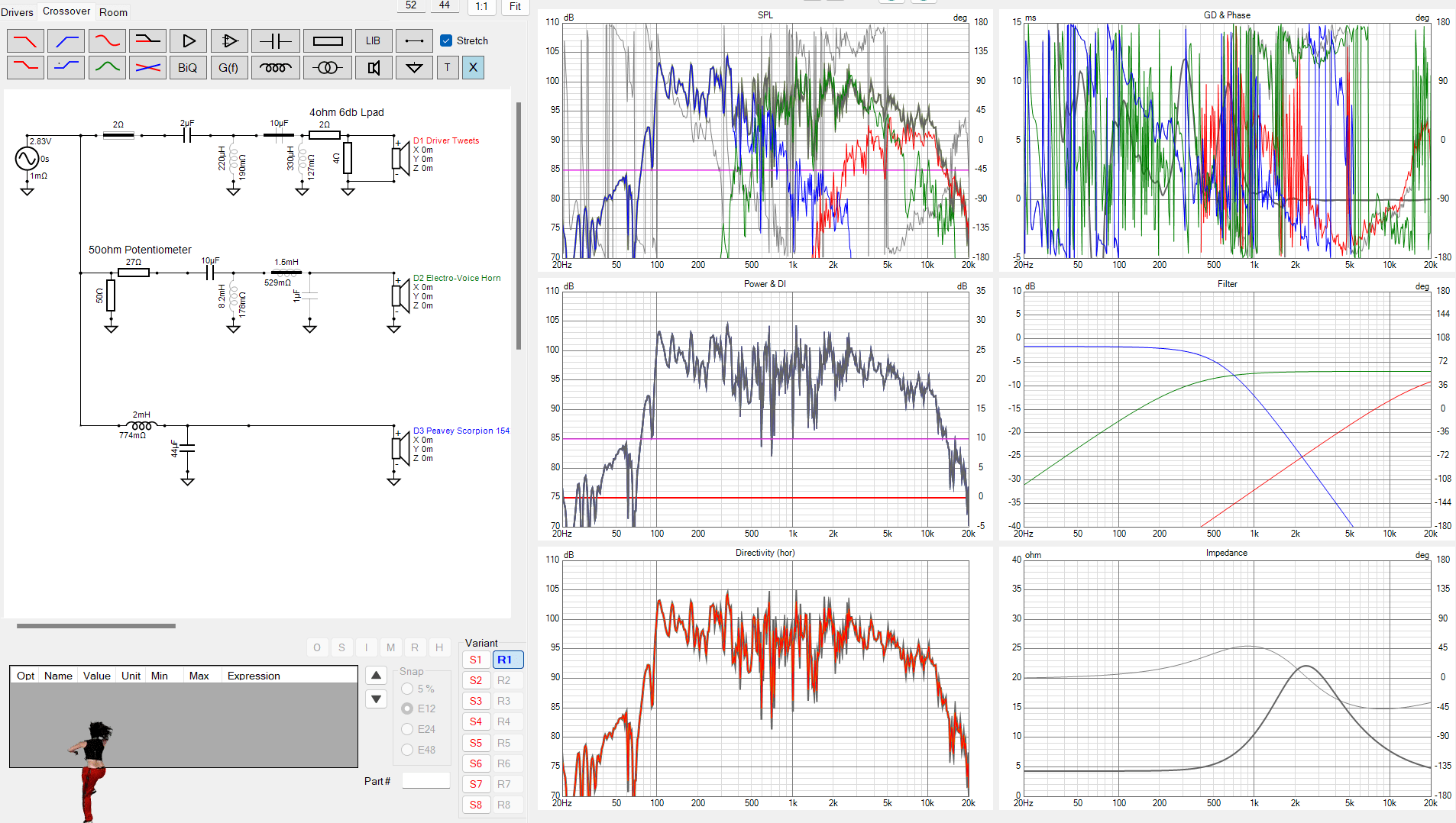

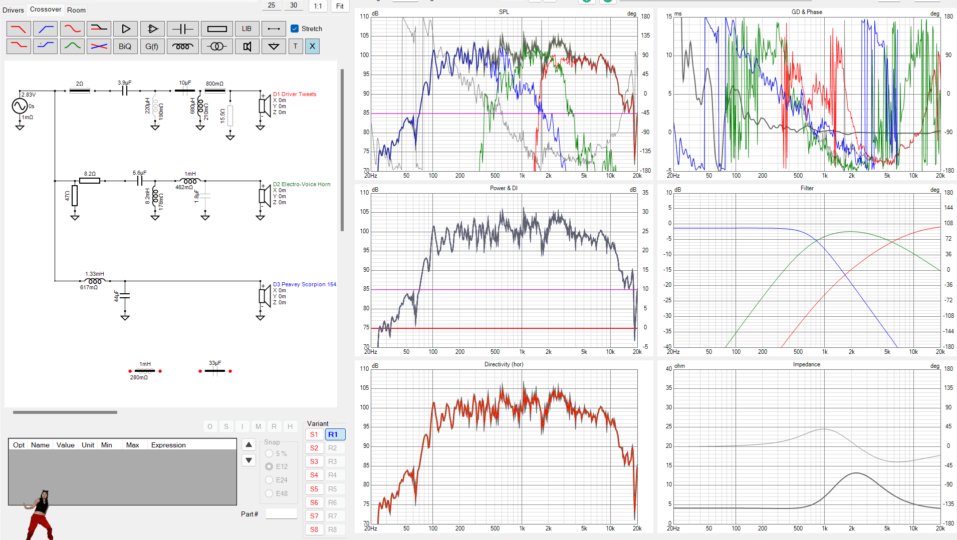

It's been interesting. The horns just cause questionable problems. I have 2 (of many) crossover renditions I modeled. They are slightly incorrect since I don't have an SPL meter. Still notice the first graph that looks terrible in comparison to the second actually sounds better than the second. I guess it goes to show sometimes response isn't the only most important factor. The biggest problem is definitely that 50-ohm potentiometer and horn setup. Do you think that huge impedance spike is okay? I look at that and just assume its going to blow up amps, but it's basically how Peavey had it in the first place other than the Piezo's coming off of it as well. Definitely need it to turn down the horns. I'm not sure what route to go. If this is acceptable impedance I might just leave it like that. If not I might just have to remove them. Thoughts?
An impedance of 20 ohm is not going to blow up anything. I'd more worry about the 4 ohm base impedance if I had a one transistor pair output amp, but you have a tube amp. Tube output transformers can develop too high voltage running into 2000 ohms or more. 20 is much less than that.
Honestly yeah I think I have the kink's worked out mostly. Looks like because of that potentiometer, the amp always sees 45-ohm on the horns. Might exceed that or be less in circuit like we were seeing. A couple of other things really helped the sound out a lot. One was a problem with the midrange xover not actually being a complete 1st order. Once I put a 1mH coil on the signal the weird reverberation effect seemed to go away. Really other than the tweeter section is all new since the old piezo's didn't have anything on them, which I will kinda miss but not that sibilance spike they did. The woofer I also adjusted with the larger 2mH coil. It loses a bit in the 500hz area but it makes the bass hit so much more smooth and deep its worth the sacrifice. So now I have some parts to order and and just time to build out the rest. Thanks for all your help!
Personally I would be more annoyed by 10 db loss at 80 hz and 20 db loss at 60 hz, from a 15" driver. I would build a bigger box tuned at 54 hz with a port. I listen to piano & organ media that go down to 60 hz frequently and 30 hz occasionally. The SP2-xt is 3 db down at 54 hz volume is 185 L or 6.53 cuft less the drivers volumes.
I completely agree! Part of my goal was to push a bit more 50-80hz out of it. I still have to turn up the bass in an equalizer but you can actually hear it now and it sounds good.

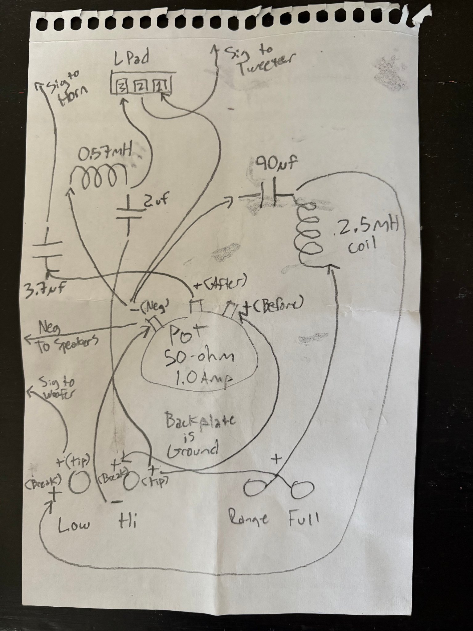

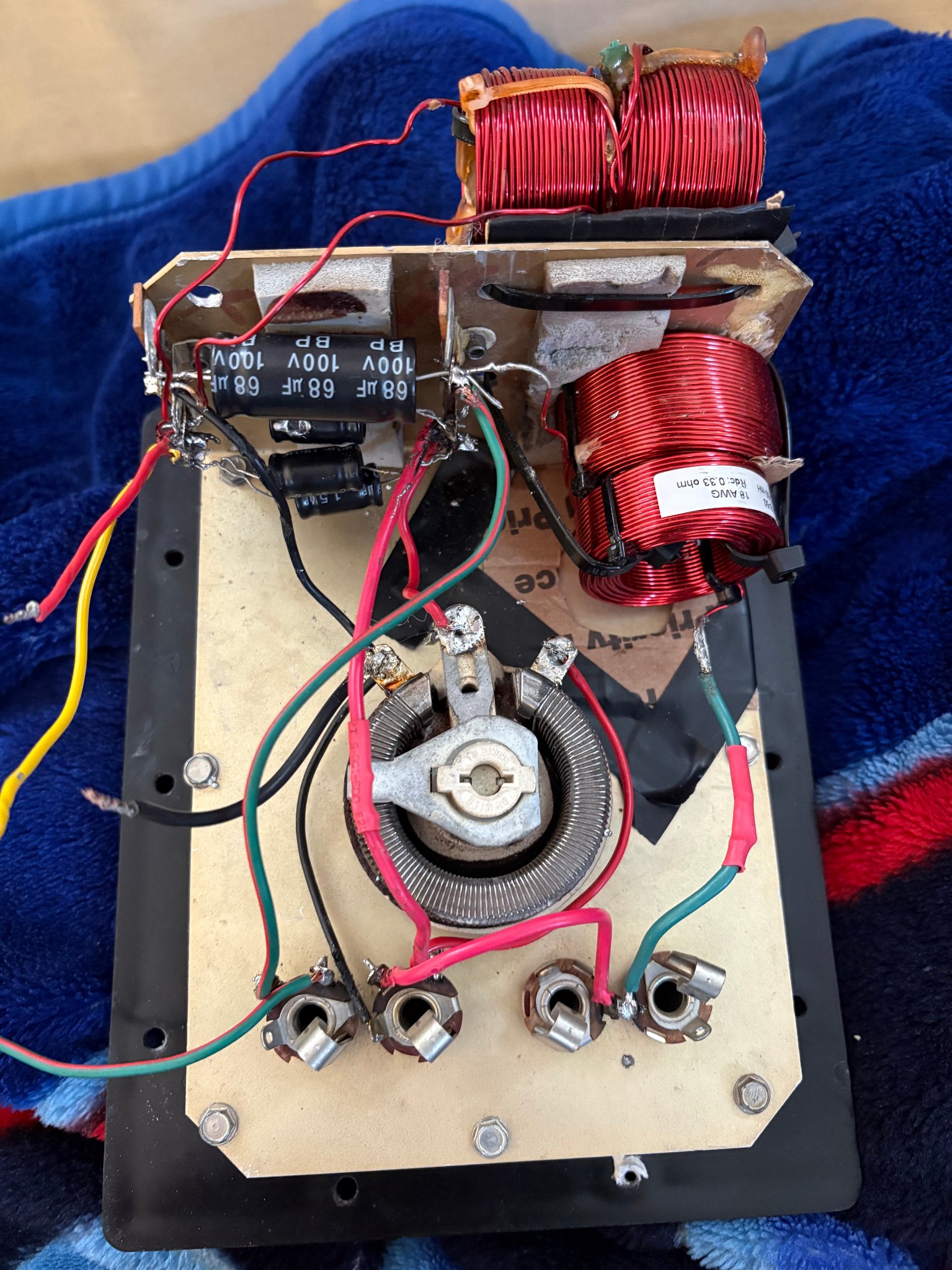

So I thought I would return and give an update for anyone interested. I made some adjustments. In the photos you will see a diagram I drew up if someone is actually wanting to mess around as well. Basically it is updated so the Bi-Amp feature could still work, although if running this way the woofer just bypasses the its filter to let you get all you want out of it. Also note I haven't tested the Bi-amp so be weary. I don't have any more graphs and that was mainly due to my microphone was never really made for the measurements I was taking but I have managed to get it sounding great. The boxes I built are tuned to 50Hz via port, this really helps and the box's are pretty big about 36" by 20" by 13" so by turning up your bass you get some really great low-end that I wasn't even aware these bass-guitar speakers could do. Other adjustments include I went back to the original spec of 2.5mH coil on the woofers and found at least with the old Scorpion woofers that it was just very slightly interfering with the horns. So on the shunt to ground cap I raised it from the originally what they had 50uf to 90uf. Next change was I pegged the horns down to a 3.7uf cap, they are picky and I actually had to go Janzten brand and use 3 different caps to get there each. Next the recommended cap for the JBL tweeters I bought for this project was 2uf and I did end up preferring it and additionally used a 0.57mH shunt coils setup I had laying around which really improved them. The final thing I can't remember if i explained earlier but i put a seperate L-pad on the tweeters since they were rated at 106/db spl rather than the woofer i believe is rated at 98 or 99/db. So yeah you can turn the tweeters down which I'd rather have them matching ratings but not even the original piezo's were rated right, they were too low and unfixable mostly. Not to mention the Horns are something like 125/db spl? and they retain that original 50-ohm potentiometer so you do have a way of controlling everything. It was a fun project. If i were to do it again I may have gone another router tweeter-wise. I did see a piezo tweeter that was correctly rated on a website somewhere so that could be an option. In which case instead of using nice air coil inductors on the woofers like i did i think you may need to use the original choke's that had put on there to deal with noise interference. Anyway that's about it!

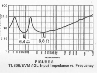

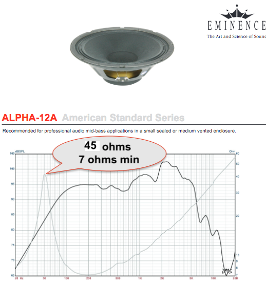

Most "8 ohm" speakers have a low frequency impedance peak well ~45 ohms at their free air resonant frequency (which raises in frequency when put in a sealed box), for instance an 8 ohm Eminence Alpha 12's Fs is ~45 ohms at 49Hz, and 20 ohms at 4kHz:
It's minimum is ~7 ohms, and it's DCR is 6.3 ohms.
When in a bass reflex cabinet, the single impedance peak is split either side of the tuning frequency (Fb), like in this EV12L, 6.4 ohms at 70Hz 31.6 ohms at 35 and 120Hz, dropping to 6.8 ~350Hz, then rising back to over 30ohms above.
Impedance is not one number.
Crossovers made with the assumption speakers are a fixed impedance won't cross at the predicted frequency or slope.
