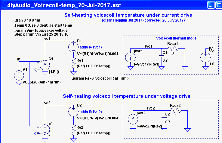

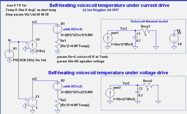

The attached circuit shows my thermal model to feed a current source (B1) that emulates a resistor which adds to resistor Re1 which is a fixed resistance at ambient.
I have used thermal model values from Zuccatti (JAES Jan 1990 p34) and neglected the other slow time constant (1000s for the heating of the magnet and yoke). The Zuccatti model is for a 130mm diameter speaker rated for 16W continuous sinewave power or 100W burst for 1 second.
I step input the voltage to a current source (the power amp) with 30V, 40V and 60V giving speaker power of 150W, 270W and 600W respectively.
The yellow line shows the rated maximum temperature limit of 150C (Class-F). It is reached in 1 second with 30V drive, and 0.2s with 600W drive. Note V(tvc1) is the thermal model temperature (rise above ambient) as Volts for degC.
The circuit also includes the case for voltage drive. With 30V drive it reaching 90% of the final temperature (360 degC) in 3 seconds. But with current drive it takes longer to reaches 90% of the final temperature (10 seconds) and the final temperature is twice as high at 650C.
I was interested to see if thermal runaway occurs with current drive. It does above 9A drive (55V input or 500W) and the temperature bows upward and never flattens off. But below 8A the temperature bows downward and tapers off.

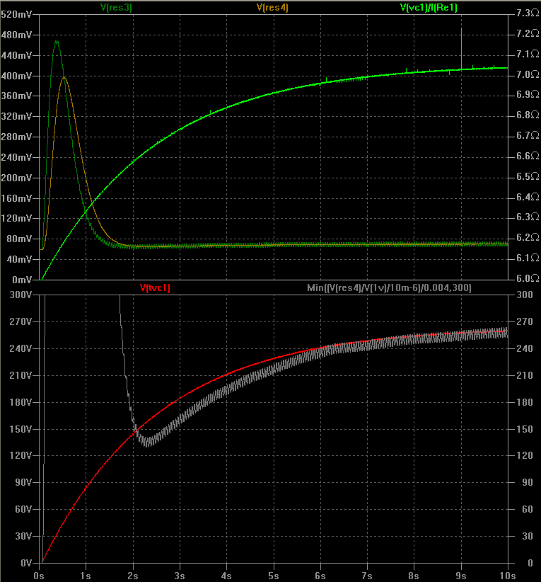

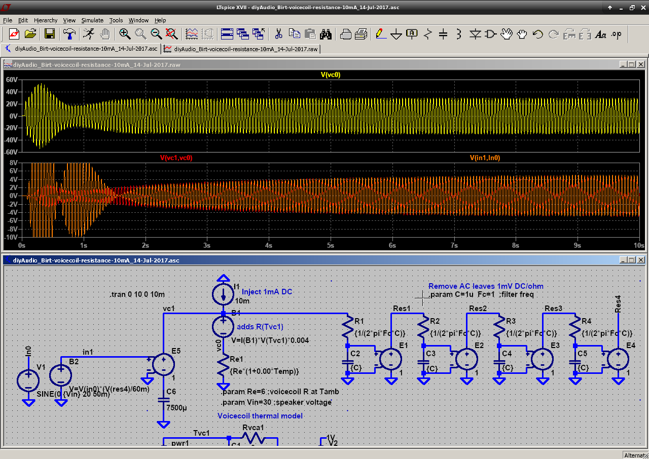

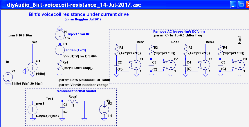

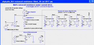

Birt's voicecoil resistance measurement simulation
The attached circuit shows the previous thermal model with a 1mA bias current and a filter to see how many stages are needed to get 20Hz ripple low enough and the response time to measure the voice coil resistance. Birt's circuit was designed for operating from 300Hz and did not need a high-order filter. But for use down to 20Hz we need a very high order filter.
With 1mA DC through 8 ohms we have 8mV DC. There is 32uV/degC change and I'd like the filter's remaining ac from 20Hz to be less than +/-5 degC or +/-150uV.
With 80V peak audio the filter rejection in dB is 20*log(0.15mV/80V) or -115dB. But we only have one decade (or two decades) of frequency for -115dB rejection because we want it to settle in around a second.

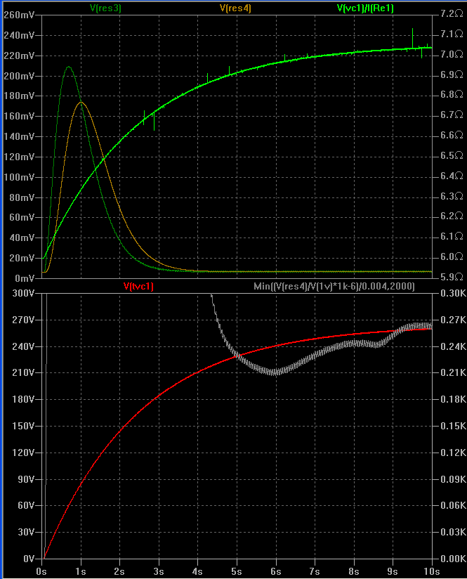

The attached plots show the filter outputs for 30V and 60V drive voltages. I found 4 stages are needed using an fc of 0.5Hz to get the 20Hz ripple below 150uV which as mentioned represents a resistance variation of +/-5 degC.
Notice the large transient of around 200mV. The sinewave starts from 0V. It takes 5 seconds for this transient settles to the 6-10mV range (recall it's 1mV/ohm with a 1mA bias). Then another 5 seconds for the filter to get within 10 degrees of the final true temperature.
Changing the DC bias to 10mA helps to reach the true reading faster (see 2nd plot). Reducing the filter to 1Hz gives +/-5 degC ripple with 4 filter stages and the transient settles in half the time. Instead of 10 seconds to settle it is now settles in 5 seconds.
There may be a better filter alignment that would settle faster. But even if we use 10mA bias, can a better filter settle in less than 1 second with 20Hz and +/-150uV ac (+/-5 degC)? It seems to a big ask. That's why I was hoping to use the self-heating resistor in series with the speaker to predict the temperature over the first few seconds.
From the previous post (thermal simulation) it needs to have a response time of 100ms to respond to a very high power, eg a (faulty) power amp with 80V DC to the speaker, and I think that is possible since the secondary wire is twisted with the heating wire for quick heating. But I have yet to measure the response time of my 7 ohm secondary prototype (see posts #30-32).
BTW my circuits in post #31 and #32 do not use the Birt method and they are only intended for proof of concept to show how a variable negative resistance can be generated without a multiplier or LDR to cancel the voicecoil resistance increase with temperature.
My compensation approach can be applied to both pure voltage drive and mixed drive, like Idrive and Vdrive at LF. When it is used with Idrive and Vdrive at LF the compensation does not need to be as accurate as with pure voltage drive because it is only around resonance where temperature affects need compensating. I hope to do bench tests soon to see how it all pans out.
...In a following post I use this thermal model with a filter to remove 20Hz leaving the voice coil DC voltage for temperature reading to see how fast (or slow) it settles.
diyAudio_Birt-voicecoil-resistance-30V-1mA-plot_14-Jul-2017.png20.9 KB · Views: 422
diyAudio_Birt-voicecoil-resistance-30V-10mA-1Hz-plot_14-Jul-2017.png21.4 KB · Views: 413

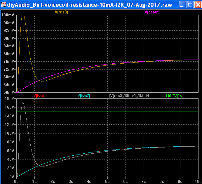

Removing Birt's massive filter transient
Zero D, Thanks. Do you have a link or anything to share like a Crown circuit?
@All, has anyone tried a better filter?
For the 10mA simulation I tried a Salen/Key 4th order Bessel alignment. With f-3dB at 0.3Hz and for the same ripple as before I got the same transient peak and the same settling time of 2 seconds to within 10 degrees, then it slowly settles to within a few degrees after another 5 seconds. That seems to be the best I can get so far.
The large initial transient (when the 20Hz starts) is a big problem. (I don't think it is something wrong in the simulation). It obviously needs to be blocked out until it has settled to prevent unwanted strange effects and false tripping! But how do we control blocking it?
If we had the rough but fast response of temperature reading from the self-heating resistor then we could use it by differentiation (dTemp/dt) for control to inhibit the Birt filter output until the rate of change falls, then switch to the Birt filter. While the Birt filter is inhibited we can use the self-heating resistor temperature reading. Maybe worth a try.

To show the response time of the Birt method of measuring the voice coil resistance using a 1mA DC bias I have first made a voice coil model with electrothermal feedback.
Oops😱. The voicecoil resistance temp. co. was not correct in post #46. Source "B1" needs to include "Re". It was out by a factor of 6.
The attached files are the corrected ones for post #46.
Fortunately it doesn't change the time to reach 150 degC vc limit.
But it does change the power level to the speaker where thermal runaway occurs using current drive; it should have been 100W (not 600W).
This mistake also affects post #47 for the Birt sims. I will update them as a following post.
My apology to all.

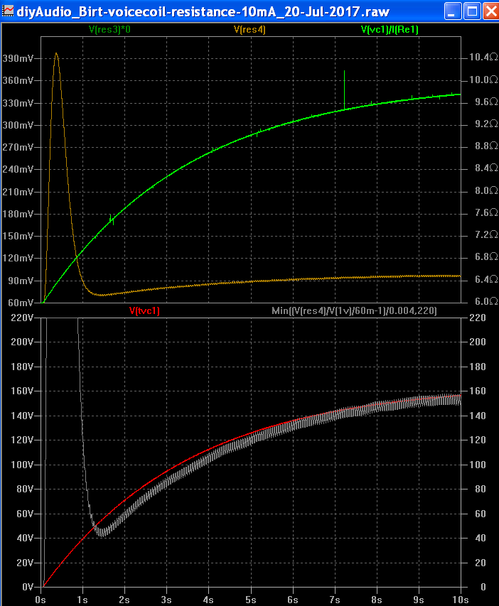

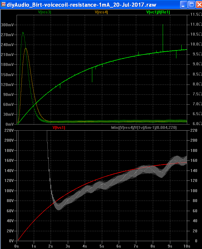

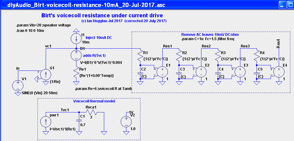

Oops in post #47
The mistake in post #46 fortunately does not affect the time constants so we get similar outcomes with the mistake fixed.
But the power levels of the sim need to be reduced to stay below thermal runaway; in this case below 100W.
The corrected sims are attached.
There is still the large initial transient when the 20Hz starts and about a 2 second delay to settle to a reasonable temperature reading.
I'm still thinking of a way to suppress this transient. Using a Bessel filter didn't seem to help. Any ideas?

diyAudio_Birt-voicecoil-resistance-20V-10mA-cct_20-Jul-2017.png35.8 KB · Views: 466
diyAudio_Birt-voicecoil-resistance-20V-1mA-1Hz-plot_20-Jul-2017.png30.9 KB · Views: 467
diyAudio_Birt-voicecoil-resistance-20V-10mA-1Hz5-plot_20-Jul-2017.png29.2 KB · Views: 455
diyAudio_Birt-voicecoil-resistance-corrected_20-Jul-2017.zip93.7 KB · Views: 93

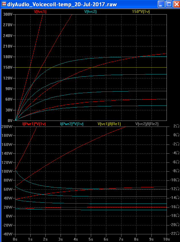

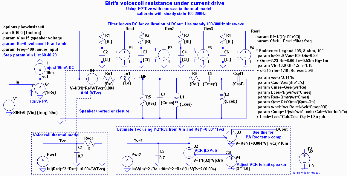

Update
Hi All,
Recap: This thread covers using current drive of loudspeakers at MF+HF and with voltage drive at LF -- current drive at at MF+HF reduces speaker distortions which mainly occur in the MF region while undamped resonance boominess that is the problem with pure current drive. It does not need an equaliser to remove the resonance boominess of pure current drive and is not sensitive to T/S parameter drift with temperature and aging. But there's a problem -- voltage drive at LF brings back volume compression and reduced damping at high power -- two effects which which pure current drive eliminates. So what to do? To overcome volume compression and damping loss at high power we can build compensation for voicecoil resistance change into the power amp feedback path -- this can be done by generating a temperature variable negative resistance to 'eat up' the extra resistance of the voicecoil as it heats up. But to do this compensation we want an accurate estimate of the voicecoil temperature in real time otherwise you get unwanted gain modulation a.k.a. distortion. The Birt method was suggested as a simple way to obtain the voicecoil temperature in real time without any calibration, by forcing 10mA DC through the speaker and use a 1Hz LP filter is used to remove the AC music signal. But with a 20Hz tone-burst we get a massive DC transient and it takes a few second to settle. This is unusable for compensating the voicecoil resistance change in real time. BTW David Birt's compensation worked well on a mid-range speaker (>300Hz), but for a woofer down to 20Hz we get this massive transient a few seconds settling. After trying several ideas none were able to suppress the transient to less than 10 degC, and the shortest settling time was 0.5 second which is still not fast enough for real-time compensation and fast speaker protection.
So what to do? I have returned to my thermal model (Post #30-32) but now with a RC thermal model instead of the self-heating 0.1 ohm resistor.
But a thermal model needs to be set to suit the speaker. Some bench tests are needed to see if we can get away with using typical thermal model values, possibly based on diameter, power rating, etc. Anyone interested? Unfortunately, I am still several months away from any bench tests.
Until tests are done I'll include the Birt method for use with with a steady test tone for calibration.
The extra parts for the Birt measurement and tone generator are minimal; they could be part of a speaker protection PCB. To calibrate a speaker you flip a switch to engage the test tone, wait 10 seconds and read a DMM and adjust a thermal model trimpot to get the same voltage as the Birt temperature. Then return the calibrate switch back to Run and it's done.
The attached simulation shows the basic circuit in operation with a woofer in a cabinet. The top plots compare the Birt temperature reading with the thermal model reading (these plots are after after calibration). Notice the Birt plot transient (brown) and then several seconds to settle to within 10 degC. This is with a 100Hz sinewave starting at V=0 at t=50ms. Notice also the thermal model reading (pink) has no transient and no settling time delay. Nice😎.
The lower two plots are the same information as the top plots but scaled in degC (1V/degC). The input voltage to the power amp was chosen as 15V to give a final temperature of 70 degC, which is safe for calibration. The green line at 150 degC the limit for most speakers. BTW T(vc) red plot is under T(vc2) plot, showing the excellent accuracy from the I^2*Rvc estimator after calibration. Nice.🙂
As for the basic circuit (attached):
This temperature estimation method can also be applied to a pure voltage drive power amplifiers -- to remove driver compression, damping loss and crossover misalignment issues. Once this temperature estimation method has been validated by bench tests, a separate thread could be started for those who want to apply it to voltage drive power amplifiers and speaker protection.
...There is still the large initial transient when the 20Hz starts and about a 2 second delay to settle to a reasonable temperature reading.
Hi All,
- The 1st thermal model is for generating the voicecoil dc resistance change with power -- it is not required for a practical circuit when a real speaker is used.
- The 2nd thermal model is for estimating the voicecoil resistance using I^2*Re*(1+0.004*Tvc2) for a compensation circuit (not included here). The 2nd thermal model can use a MOSFET for squaring and another MOSFET for the temp. co. multiply to keep it simple.
- Voltage source V4 is for thermal model calibration -- B4 changes B2's resistance. In a practical circuit B2 is a trimpot for calibration of the thermal models thermal resistance. B2 could be an E2Pot so a micro could do the calibration automatically.
