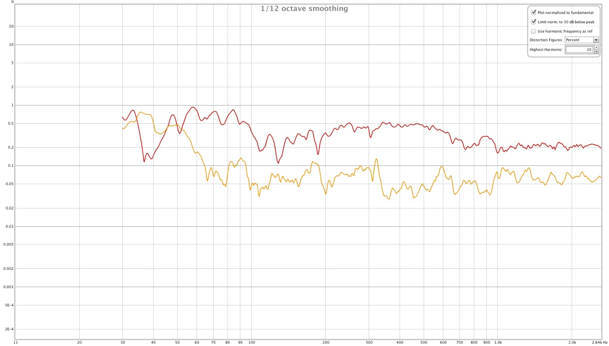

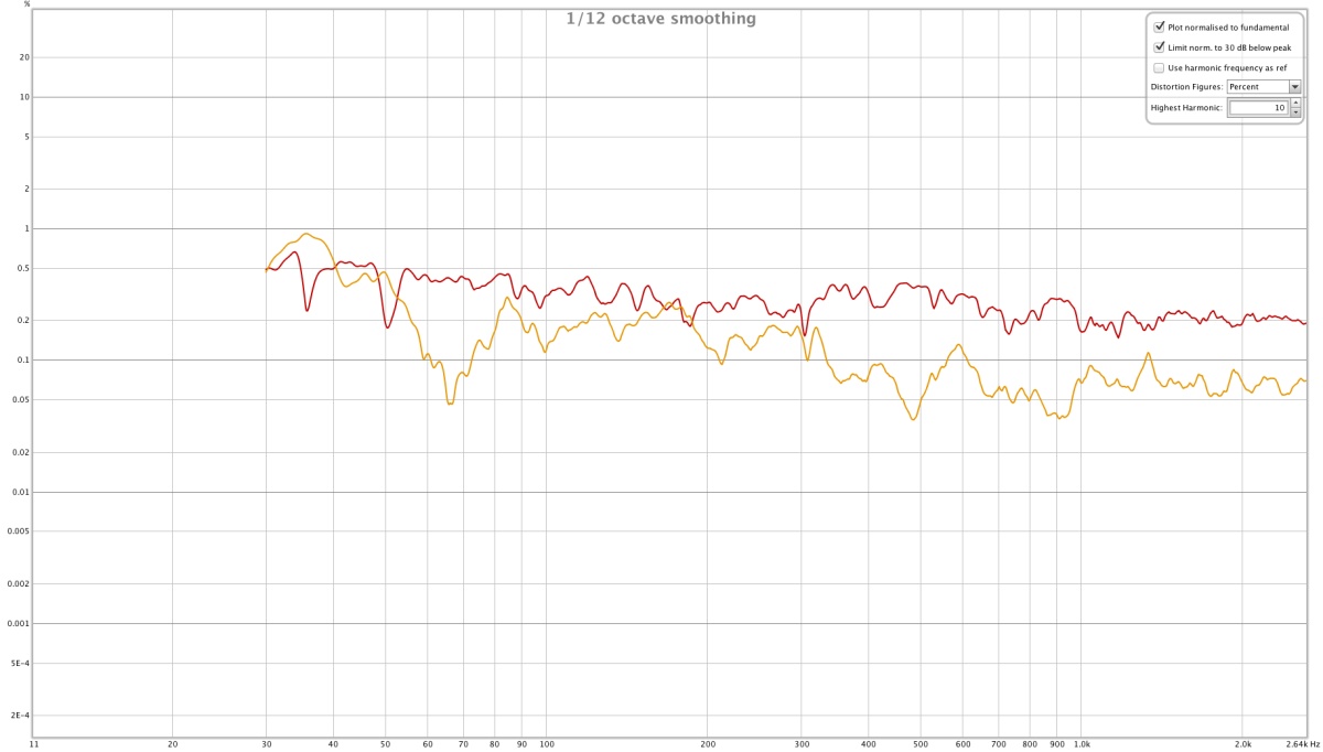

These ones would be easier to compare, first VFET, second IcePower. RED 2nd, Yellow 3rd.
Interesting results !
moschfet mentioned AceBass, & i agree it does seem to share some similarities etc. But that's a good thing ;)

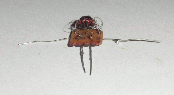

Hi Jan,
I was not thinking of sensing the voice coil temperate in-situ but via a small DC bias current through the voice coil like David Birt used in his AES paper (sorry, I misspelled his name in post #24 - my apology to David Birt).
But measuring the voice coil resistance this way is too slow to catch sudden transients (<1 sec) so I was thinking of adding a self heating resistor in series with the speaker as a thermal model to fill in the first few seconds of temperature reading. This extra resistor reading does not need to be very accurate because the other DC measurement gives good long term accuracy.
With a 0.1 ohm series resistor at room temp the power is around 1/60th of the nominal VC resistance, so this resistor needs to be about 1/60th the speaker power rating, or about 1/4 watt for 20 watt speaker (which typically handles 100W music with a PMR crest factor of 10dB). We also need a thermal mass of 1/60th of the VC. (There are several AES papers dealing with speaker thermal models, I have Zuccattit Jan 1990 but there's a better one here).
The attached shows a 1/4 watt resistor with 150mm of 0.2mm wire wound on it for 0.1 ohms.
There is a secondary winding of 600mm of 0.07mm wire twisted into the other wire to sense the wire temp with minimal time delay and it's resistance is around 7 ohms so 10mA would give enough voltage change. This fine wire is folded back on itself twice to 150mm for ease of winding and is noninductive to the other winding. Not too hard to wind, but soldering the fine wire to terminals required a magnifier. The resistance increased to 11 ohms when I passed 2.5 amps through the 0.1 ohm wire or about 0.6 watts reaching about 150C. I haven't done a transient test to see if the time constant of the sense resistor is like the voice coil of a woofer yet. But it seems to be in the right ball park.
The temperature information is then used to compensate the power amplifier to remove compression and damping changes. Compensation can be used for either voltage drive amps or mixed current drive (Vdrive at LF). And it can be used to dynamically limit the power to a speaker and turn the PA off if that fails.

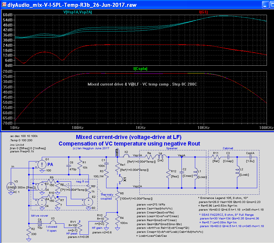

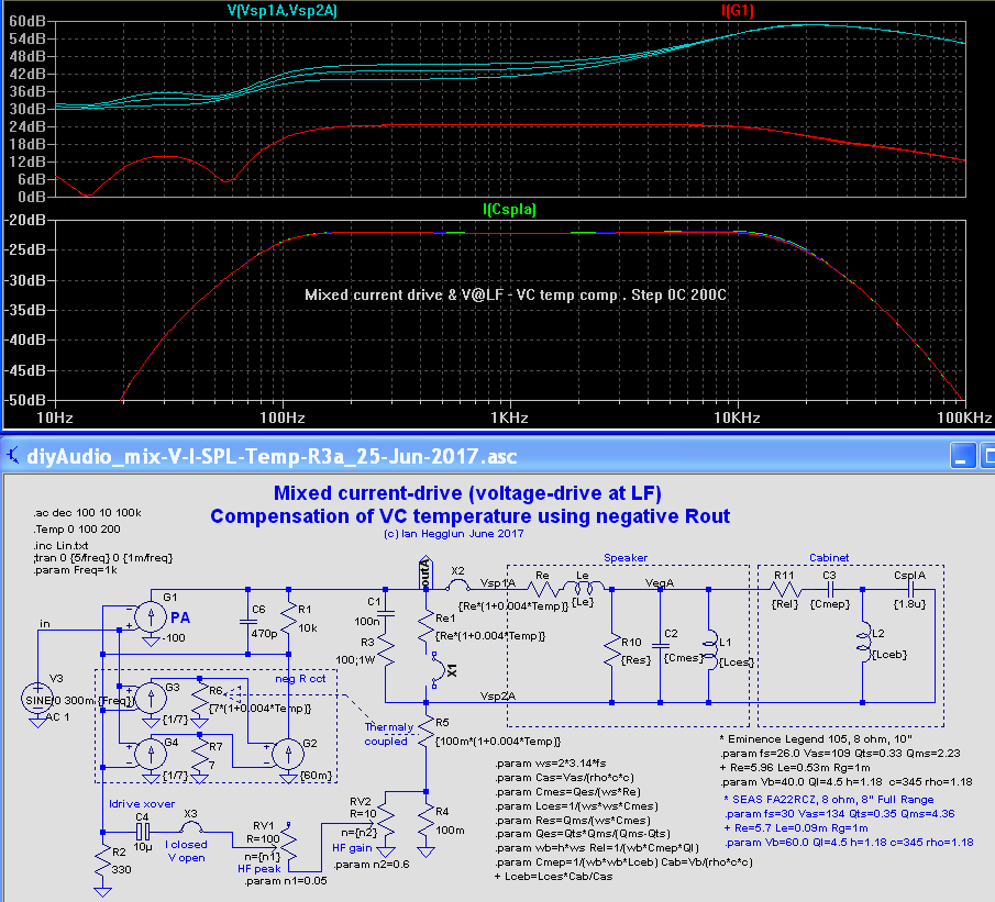

Hi All,
Here's a way to use the 7 ohm winding (see previous post) to compensate a mixed current drive (V drive at LF) for voice coil temp changes.
A generic power amp circuit is attached.
The capture shows SPL plots at 100C and 200C plots overlay the 0C plot --showing the correction works. Notice the speaker voltages are different due to higher VC resistance at 100C and 200C.
This circuit generates a negative resistance equal to the VC resistance increase above 6 ohms at 0C. Resistor R6 is the 7 ohm temperature sensing winding wound together with R5 of 0.1 ohms of wire that connects in series with the speaker. Note R4 is another 0.1 ohm resistor with no temperature coefficient for current feedback.
The Gm of G3 and G4 are 1/7 A/V for unity gain with a 7 ohm sense winding. G2 is 60mA/V from Gm1*Re(0)/R1. Note G3 and G4 can be scaled down if G2 is scaled up.
This circuit uses the 7 ohm sense winding as part of the signal path without extracting the temperature as a control voltage and does not need an analog multiplier which reduces part count and is more reliable. Since G2,3,4 stages are fixed gm they can be implemented using 3 Howland current pumps with standard opamps, or CMOS inverters in linear mode.
BTW you can also use this generic amplifier circuit to compensate for a voltage driven loudspeaker part of an active system. Open the link in my LTspice circuit to disable the current drive and you can see the speaker is temperature compensated in voltage drive mode as well. Nifty
To extract temperature as a voltage a small and equal bias currents can be passed through R6 and R7 then a LPF with gain can be measure the dc voltage between R6 and R7. This voltage proportional to temperature can be used to dynamically limit the amplifier power to the speaker (eg by reducing the clip level of a soft clip circuit) and if necessary turn the PA off if that fails to limit the VC temp below it's maximum safe value.
To recap:
  • Mixed current drive (with voltage drive at LF) gives the benefits of distortion reduction from current drive above resonance -- and the voltage drive at LF gives the speaker damping at the low end.
  • Mixed current drive allows a speaker to have different inductance values (Le) without needing to change the HF/LF balance setting -- allowing random speakers (something that is not possible with pure current drive) which is needed if we want current drive amps and speakers to be interchangeable like voltage drive amps and speakers are at present.
  • With temperature compensation we now get the same damping and roll-off f-3dB over the full temperature range of the speaker -- it can also be used remove compression and crossover misalignment that plagues voltage drive speakers.
  • You can easily switch from mixed drive (+Vdrive LF) to pure voltage drive -- so you can drive either standard speakers with this power amp OR (custom) current drive speakers. It's a universal voltage/current drive system that could be attractive to the commercial Hi-Fi industry (and DIYer's!).
  • diyAudio_mix-V-I-SPL-Temp-comp_25-Jun-2017.zip
mods to temp comp circuit
.... G2,3,4 stages are fixed gm they can be implemented using 3 Howland current pumps with standard opamps...
Here's the same circuit using ordinary 10mA opamps to replace current pumps for G2,3,4 for the negative R circuit. Easier with standard opamps.
  • diyAudio_mix-V-I-SPL-Temp-comp-alt_26-Jun-2017.zip

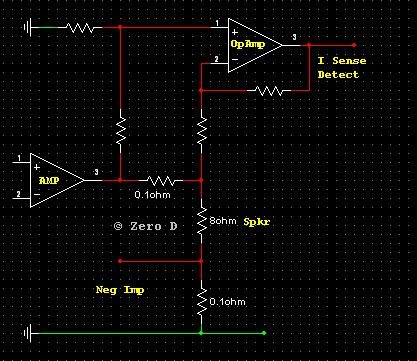

Hi, nice going :)
So the thermally coupled idea seems to work ;)
Could you not just have R5 for both purposes, & illiminate R4 ?
I use Multisim in place of LTSpice, so i'm unable to make use of Any Zips etc you & others post ! Can you please post the Opamp circuit as an image
@ IanHegglunHi, nice going :)
Could you not just have R5 for both purposes, & eliminate R4 ?
... Can you please post the Opamp circuit as an image
Thanks. As mentioned in post #30 I tested the 0.1 ohm wire wound resistor with the 7 ohm secondary wire. That works, it went to 11 ohms with 2.5 amps or 0.6W which is about 38W into a speaker and my 11 ohms converts to 150C. Since the actual vc temp will depend on each speaker, just increase the 0.1 ohm wire length of R4 to increase the indicated temp to suit each speaker. As for the compensation circuit, that works nicely. I haven't built it yet, but sims say it should work.
Having two 0.1 ohm resistors is not absolutely necessary but helpful because the self heating one is copper wire and has the same temp co as the vc which means it models thermal runaway. When you compensate for vc compression with a circuit like I use you can (will?) get thermal runaway in the vc. So I think it is safer to model thermal runaway at this stage until we test if it is safe to not model thermal runaway, and if over-temp sensing must? be used. This means two 0.1 ohm resistors (R4 & R5) because the other one (R4) does not require a temp co, because current drive naturally removes vc resistance compression above resonance.
The LTspice circuit image is now attached. Sorry, I thought everyone had LTspice:eek: . The "opamps" are generic voltage gains which can be implemented using the standard 4R "diff-amp" using an opamp. Once I have bench tested one I can post a buildable circuit, but that may take a month or too due to commitments. You are welcome to beat me.:)
