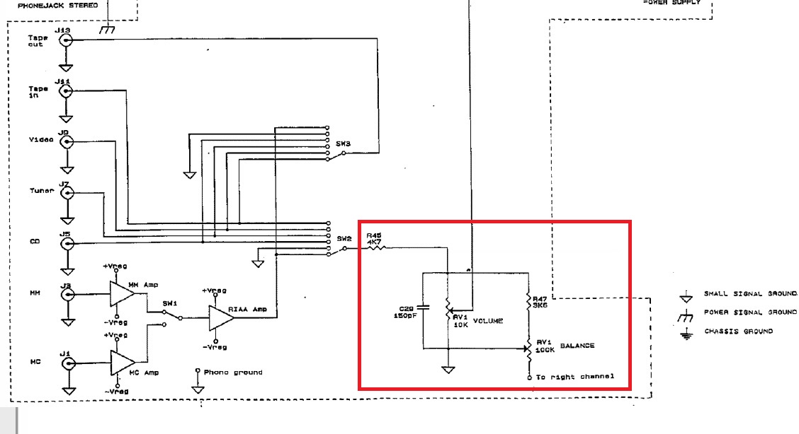

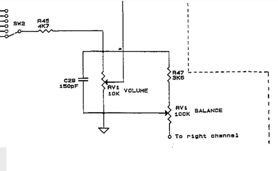

I have a Mission Cyrus 2 Integrated amplifier which I would like to remove it's balance control and install a better quality volume potentiometer to replace the original one.
As far as I see the pre amp stage in this amplifier is passive.
I attached a schematics and would like to know what parts do I need to remove/change after removing the original volume/balance potentiometer.
According to the amplifier's datasheet it's input senssitivity is 0.5mV (line) which is too low for "newer" 2V output sources, how can I modify the ampliifier's input section so it'll be a better match for 2V output sources?
Thanks in advance.

If completely removing the balance control, replicate the circuit conditions with resistors and put the wiper contact at what was the 'maximum' position.
If you want to replace the original balance control with two separate pots to provide individual volume controls, the connections will be the same, and your only problems will be mechanical, and physical accommodation of two pots instead of one with consequent aesthetics to consider.

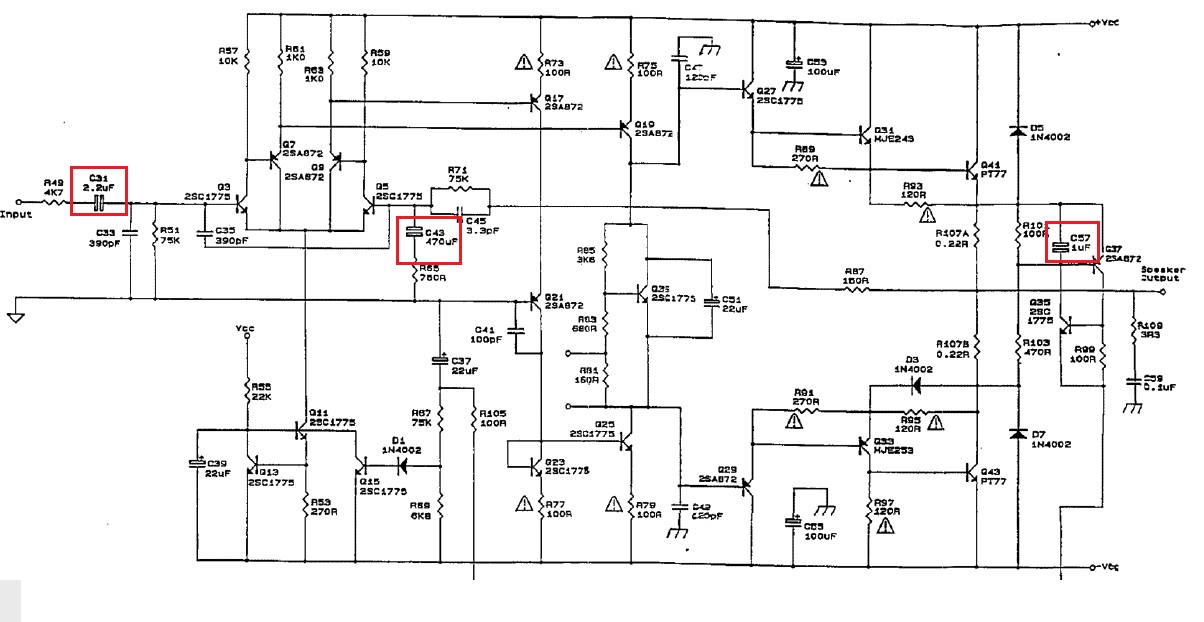

There are 3 electrolityc Bipolar caps in each chanel, it seems that they are in the signal path and I would like to know if it would be better to change it to a non electrolytic caps?
Maybe just bypass it ???
Caps values are: 1uF, 2.2uF, 470uF
if it would be better so what do you suggest? what kind of caps?

There is no room for quality polypropylenes, if you replace them with normal metal film capacitors the sound gets much worse, I tried that at the time.
You can renew them with Nichicon Muse BP in case their characteristics have worsened over time.

Wht´s the problem you are trying to solve?
Symptoms?
Quite the contrary.
You have 3 active sections per channel, dedicated to Vinyl.
You also have an input selector switch, which in 1 position selects the active section.
There is some mistake there, reread Manual
If anything, itmight be too high.
I guess typical input Tape/CD/Tuner/etc. (any non Phono) sensitivity will be around 200mV, in principle send your Digital source there.
IF uncontrollably loud, consider using an input attenuator.
Do it only in a single input pair (say, Tuner ot Tape In) and label it accordingly.
Symptoms?
No problem in here, I just don't use the balance control and the volume potentiometer is "stepped" and I don't like.
Quite the contrary.
Only the phono stage is active, all the rest passive.
The phono stage is always "powered", even when the amplifier is switched off.
You are right, it's 50mV for the line inputs.
Hi, Wima MKS2 in 5 mm are the caps for 1 and 2.2 µF. I would choose Nichicon MUSE bipolar for the 470 uF. When one can replace electrolytic caps for film one should do it. The MKS2 perform better than the average electrolytic cap. Please make sure to replace the 22 and 100 µF caps for Panasonic FC or the like. You can up the voltage rating a bit to have the same physical size as the old ones.
The balance potentiometer can be removed, I am not too sure an Alps blue is really an upgrade... A TKD would be.
The volume circuit has an input filter and the amplifier itself has it too. This is something some high end manufacturers may learn from. Even on diyaudio.com many recent designs lack an input filter which often leads to trouble with signal pickup.
Anyway, IF I would still have such an old device and I would like it a lot I would change the feedback resistors but this has some risks. 50 mV sensitivity is not compatible with normal sources. I did this with several classic circuits only to be able to use sources younger than 40 years. Over sensitive amplifiers may add a certain character (nervous 🙂) to the sound which may alter when the gain is reduced. In most cases it costs some time and is the reduction in gain rewarding. It is way better than any form of attenuating good 2Veff signals only to amplify them again....
To reduce the input, I build interconnect cables with two 4.7k resistors as a voltage divider.

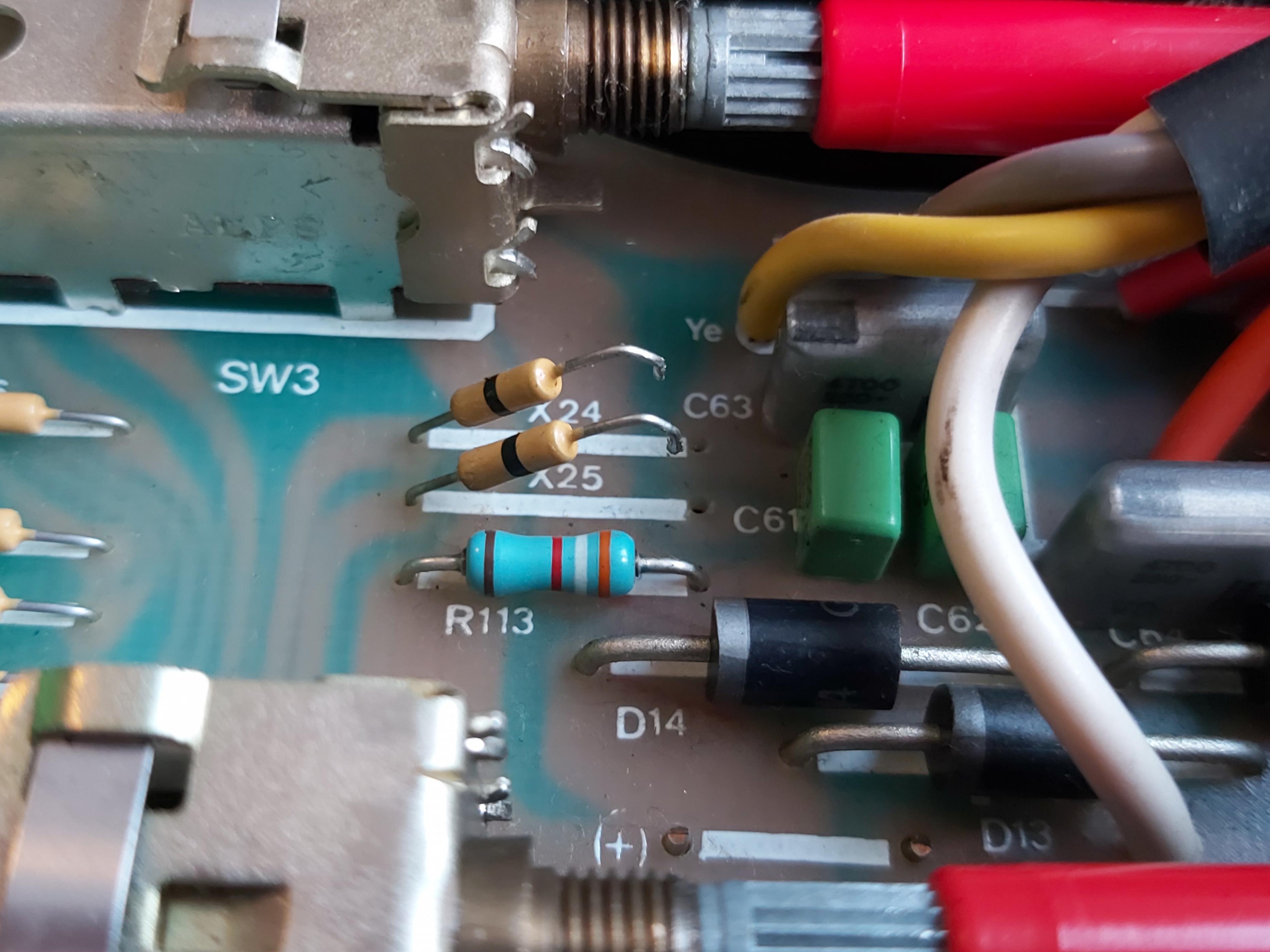

If you are not using vinyl and want to disconnect it, lift one end of the zero ohm resistors located before the two small PSU capacitors.
Are you sure the impedance of the whole will not be too low for the average sources? I am pretty sure many sources will not like this and you'll experience loss of bass. The amplifier itself is already low ohmic. If one wants to keep it simple replacing R45 for a 15 kOhm is way simpler (I would however prefer the gain reduction method). C29 must be lower in value now (47 pF, make that a very good type). The plus of this simple mod is that the amplifier is also a lighter load for sources instead of being a heavier load.

Its X24 and X25 to disconnect the power to the Phone PSU. On my amp some of the capacitors are starting to bulge and disconnecting power is an easy fix as I don't use the phono input.
WIMA 1uF and 2.2 uF fit and look good.
Also replaced C53-54-55-56 with Panasonic FC.
