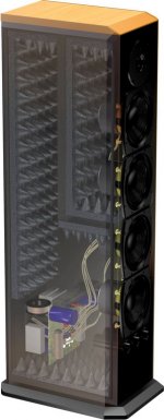

Referring to the cut-out attachment you can see that the tweeter and upper two low frequency drivers (which are in series in the schematics) are in an enclosed box. This acts like a two-way speaker with the two low frequency drivers handling all frequencies below the hand-off to the tweeter (around 2300Hz). However this design rolls off the low end frequencies so the lower two, ported drivers (in parallel in the schematic) are low passed at 200 Hz and add, assist,boost the frequencies below 200Hz that are generated by the enclosed box drivers. These are what I call the bass-boost (You can look up baffle-step correction).
This configuration is often referred to as a 2.5-way speaker design.
