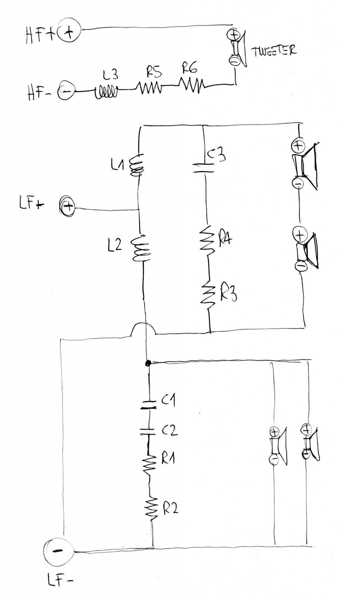

I'm sorry too for writing here in such an old thread but just hoping Justblair or someone else into this can help.
I'm not happy at all with my Mission 753 Freedom's and would like to replace electrolytics and cables. Drawing my crossover schematics I realize it is quite different from Justblair's one and, more than everything, the two lowest woofers are connected in parallel. Since I bought these speakers used, is it normal or did someone do some "magic" into them?
Attached is my schematic

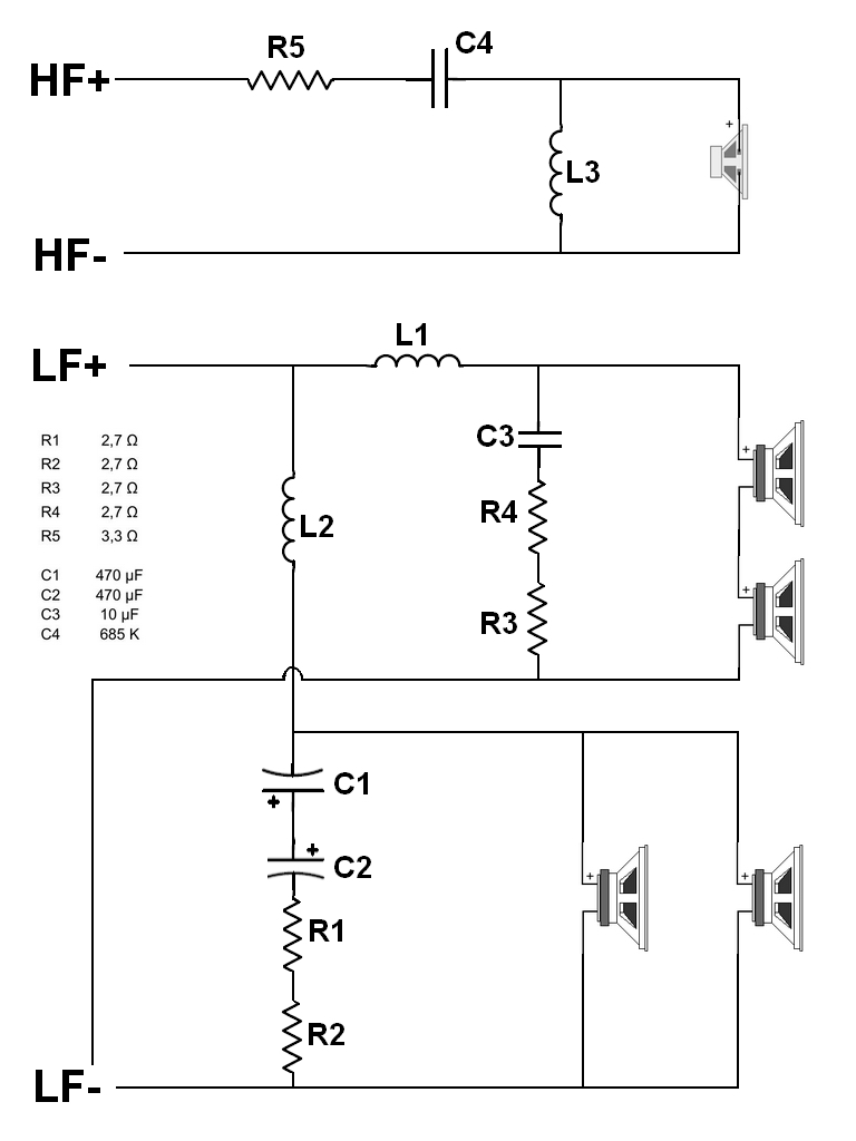

Roppu; I have the 753 Freedoms as well (bought new 1999 so I know only I have modified them). Yours are wired the same as mine, although you still have a problem with the tweeter tracing (the cap should be in series). I have attached my cross-over schematic which contains the component values as I measured them.

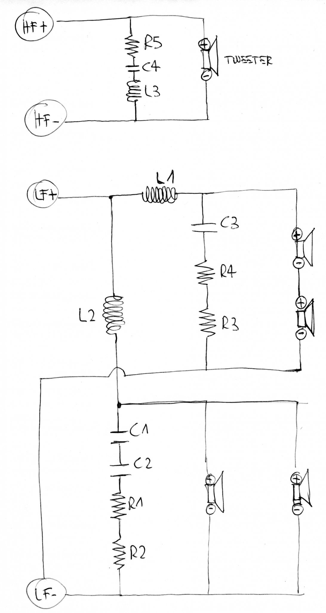

Wow this is great Threndor! Yes, after posting that schematics, someone told me it should have been different and I actually found I did a tracking error. Attached is my correct one.
What did you modify please? Did you maybe happen to have measured the DCR out of the LF and HF?

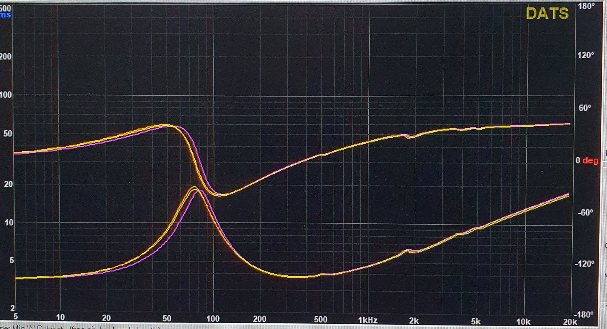

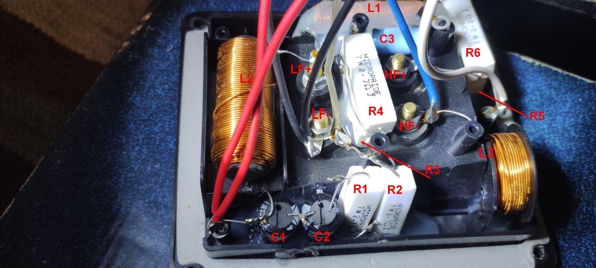

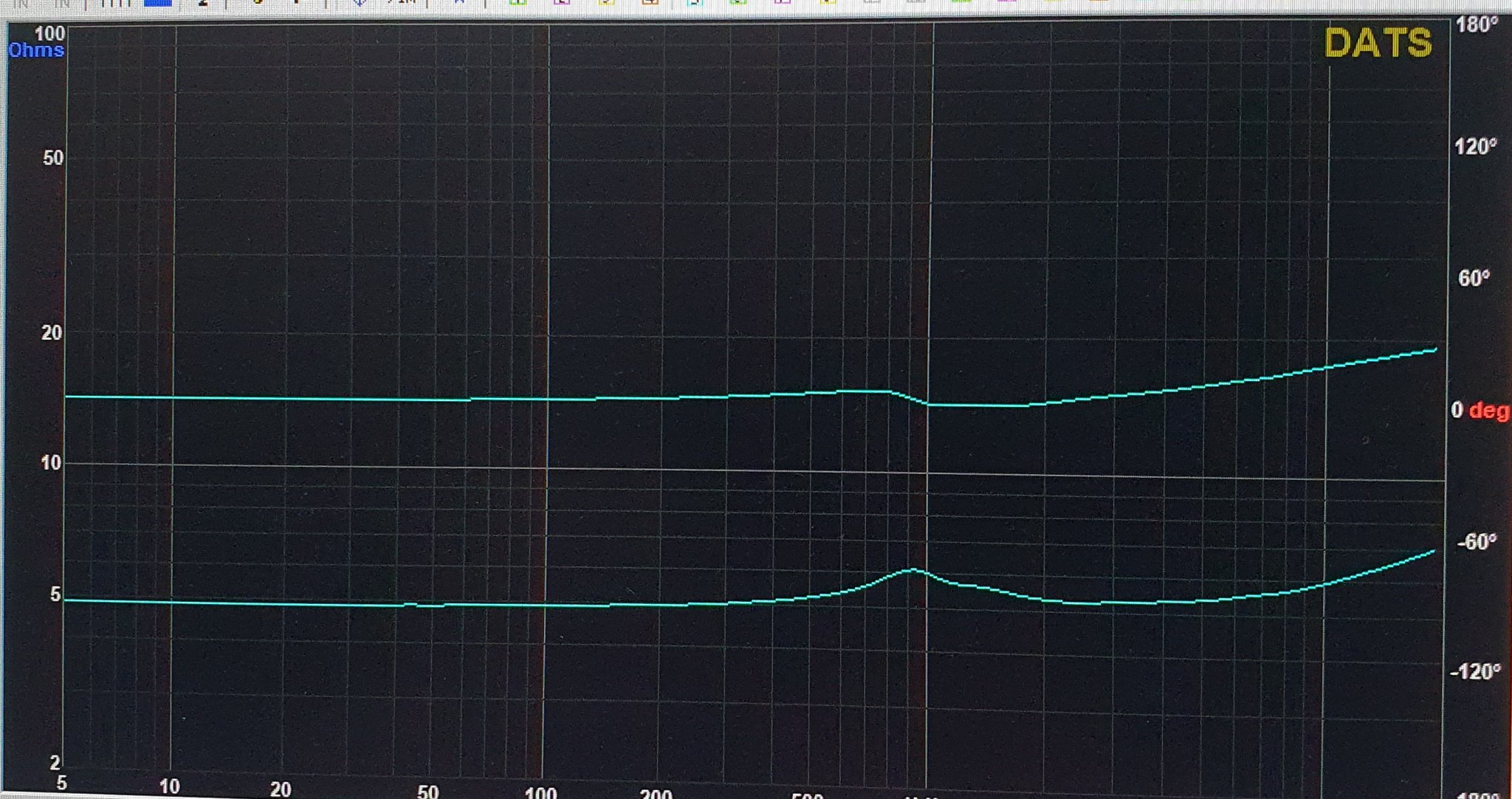

I modified mainly due to age, upgrading all XO caps and resistors, but left the inductors as is, as well as rewiring the cabinet. This also means that all XO inter-connections are new. I use a vertical bi-amp setup so also re-wired the tweeter-and-mids together and to the upper terminals (right amplifier output) and the bass-boost only to the lower terminals (left amplifier output). The result is well worth the effort and small cost. Attached are driver only (no cabinet/no crossover) impedance plots. Looks like the tweeters are around 5 ohms and the mid/Bass units around 4 ohms.
