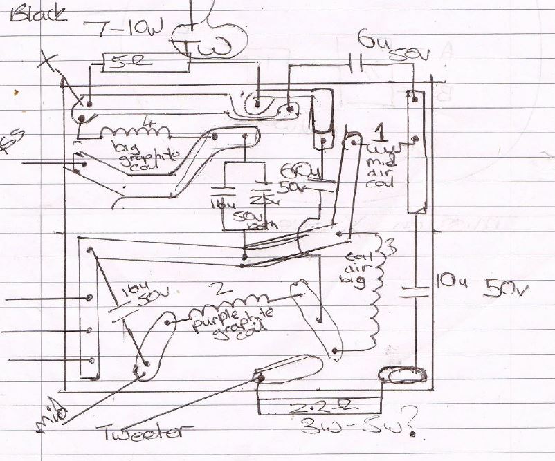

I have drawn the crossover circuit diagram but need to re-draw a little neater and then upload here.

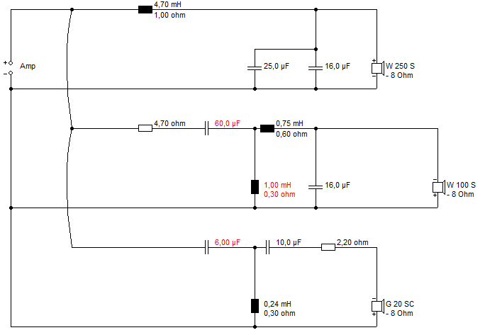

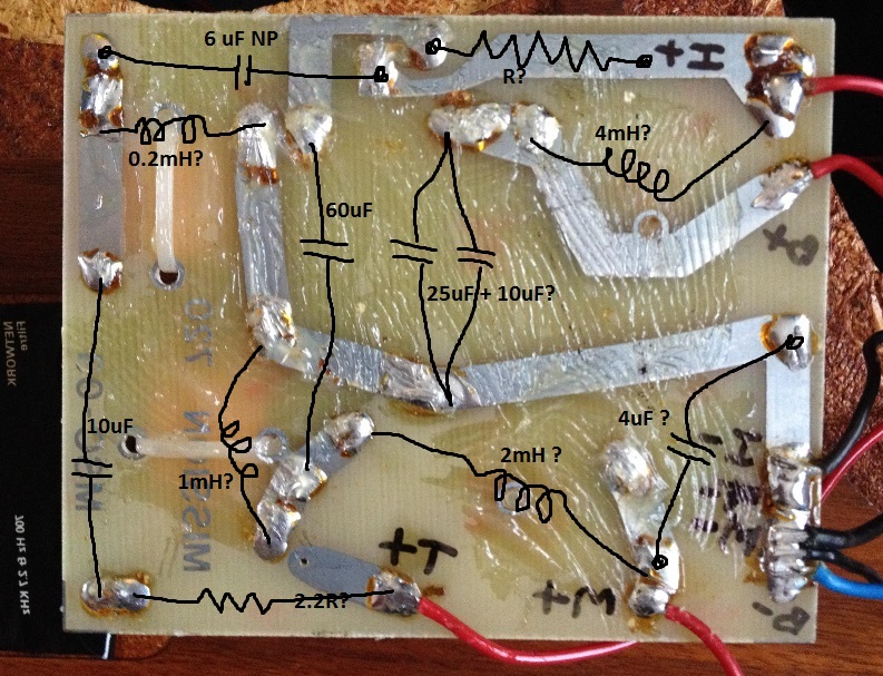

I must have been bored today, but I thought I'd try and trace the schematic... and that is hard with just a few photos. 😱
What I got seems wrong. 😕
I think you Mission 720 enthusiasts should check my work. Because, as it stands I could only get a 2kHz crossover to the SEAS tweeter. Rearranging things got a much more plausible 3kHz crossover.
Ah well. We need the original poster, who calls himself Mission720 to look in.

Nice work, Andy. I had found your schematic, as it goes... 😀

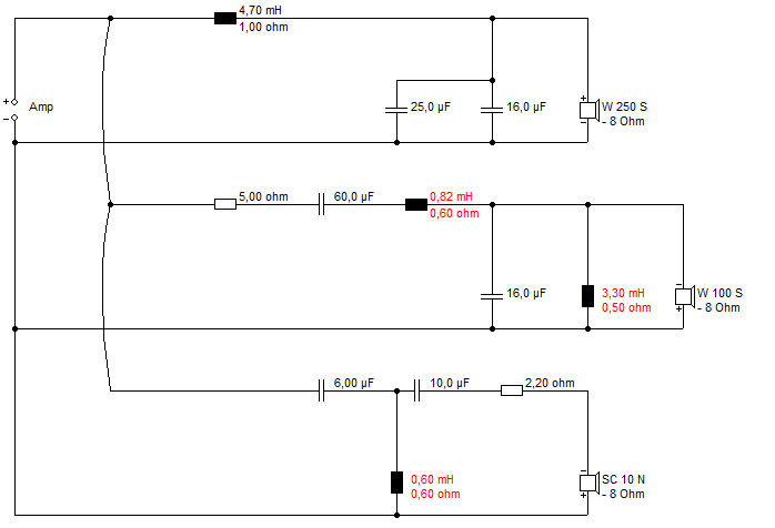

Anyhoo, here's where I am at now. Still that 2kHz crossover. 😕
This is like doing jigsaw puzzles. But we know it's not a million miles away from a SEAS 503:
SEAS Kit 503
If we are right so far, there is room for improvement.

"Nice work, Andy. I had found your schematic, as it goes..." I wondered if you had, there's not a lot online about these speakers.

I don't have this Mission 720. Nearest I have is some ropey old Celestion Ditton 44. They need some work on bass tinsel leads, which I might take on, since Blue Aran stock tinsel.

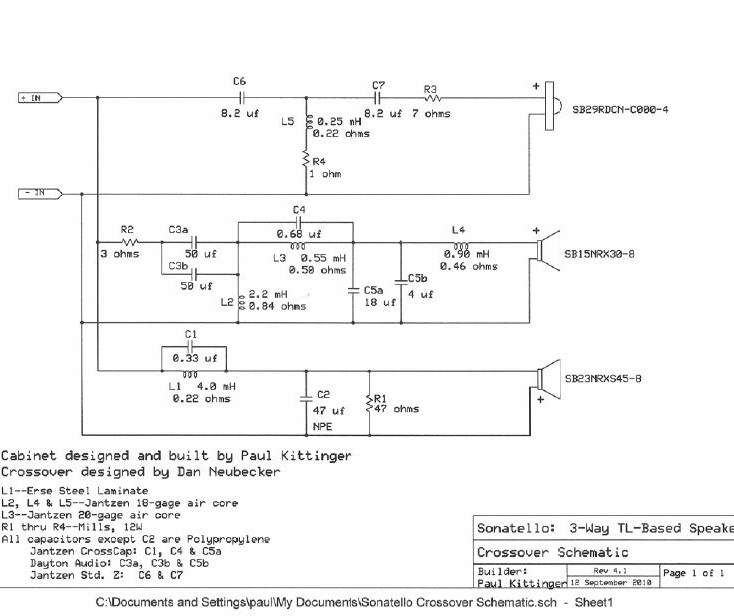

But I'm always interested in the classic 3-way Steen Duelund filter. So is Troels Gravesen, below. After a while, they all look the same.

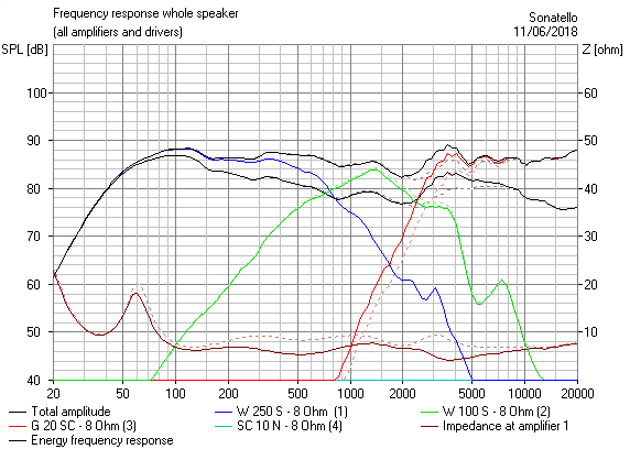

This is potentially a better speaker than the SB Acoustics Sonatello. But the guys in that thread don't want to hear about it, so I'm not telling them. There are about 5 glaring design errors. 😀
But as in the Sonatello, I plain don't like what I seem to be seeing with the Mission tweeter filter. I would fix that. You'd be surprised how well you can sim a speaker using different but similar drivers. I came up withbass 4.7mH and 40uF on the optimiser in Boxsim on the purest guesswork. That wasn't far off, was it? 😎

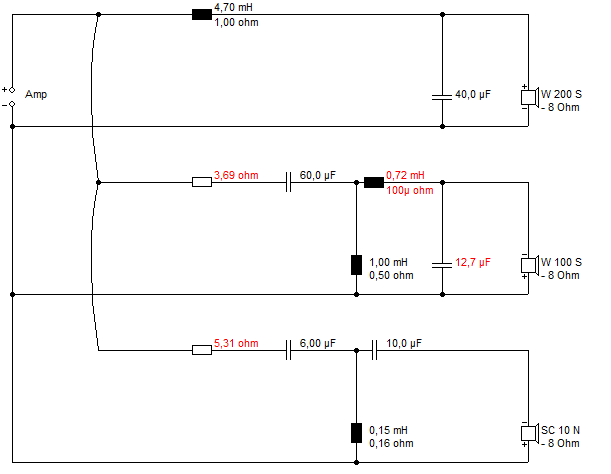

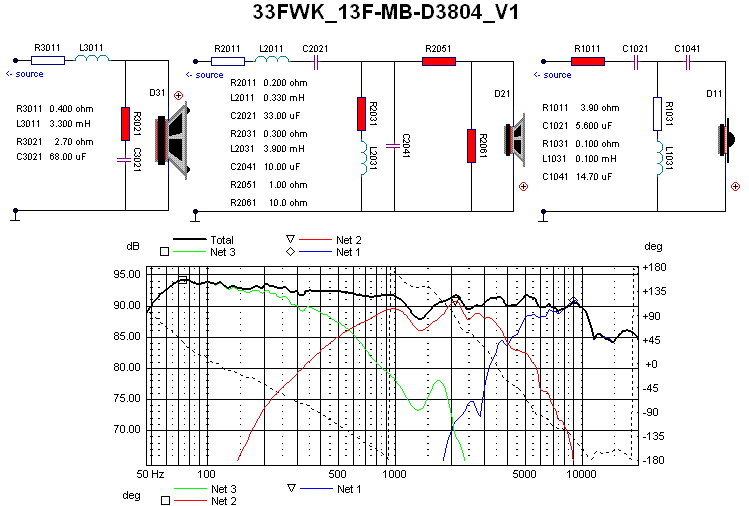

Good piece of work, my friend. It's yer classic Duelund filter.
I might be tempted to replace 60uF/1mH with 30uF/2mH for higher (dotted) impedance. And that 6uF with 3.9uF. Rough sim, of course, but the essential features. Otherwise nothing to criticise. 😎
BTW, 33uF and 1.8mH would do much the same thing... and more easily obtained. I'd stick to NP electrolytics. They are part of what this speaker does.

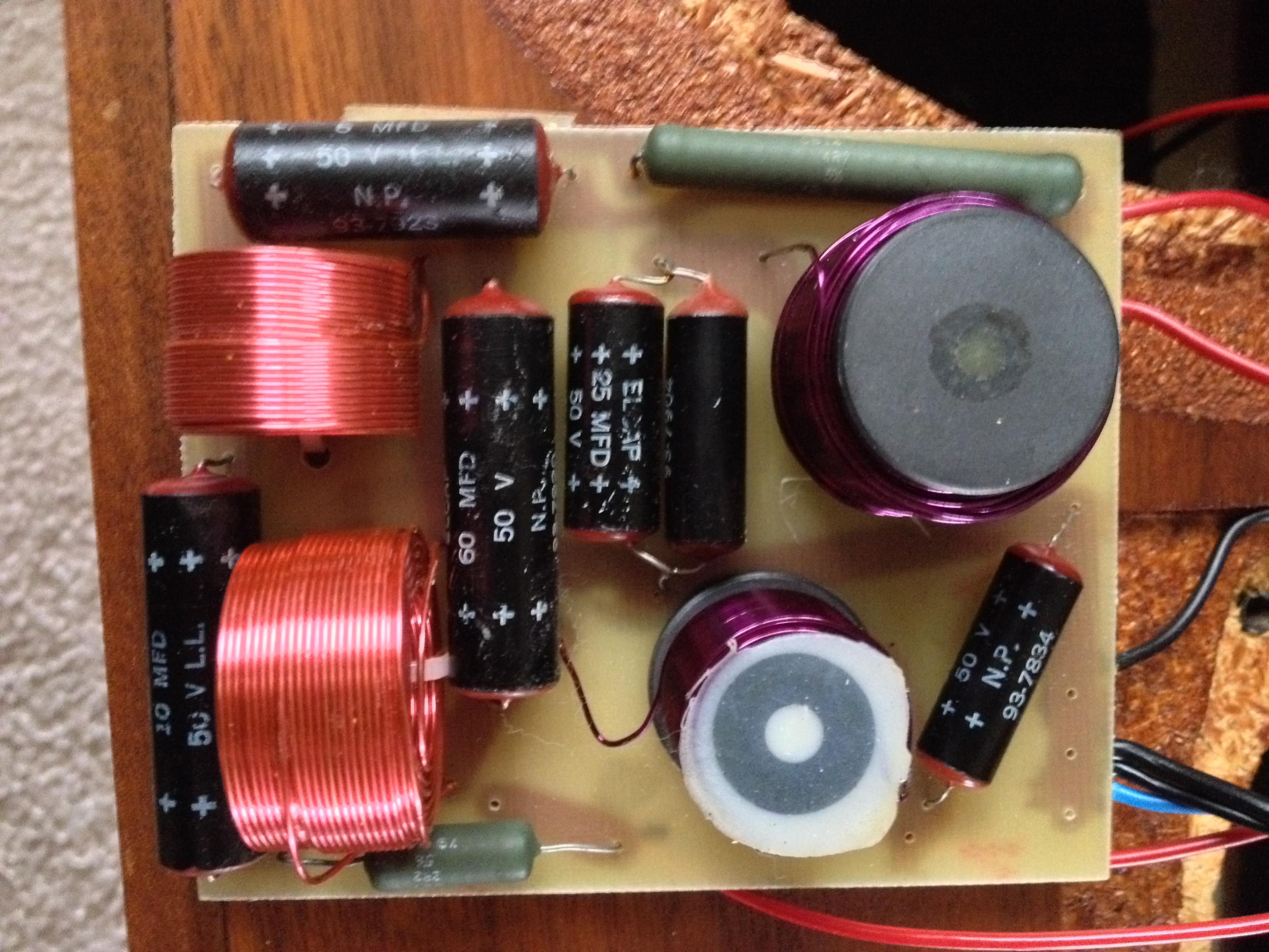

Owners of these speakers should check the capacitors on the Xover for ESR, this is tricky as the Xovers are glued on tight. It takes some gentle prying to get them off.
