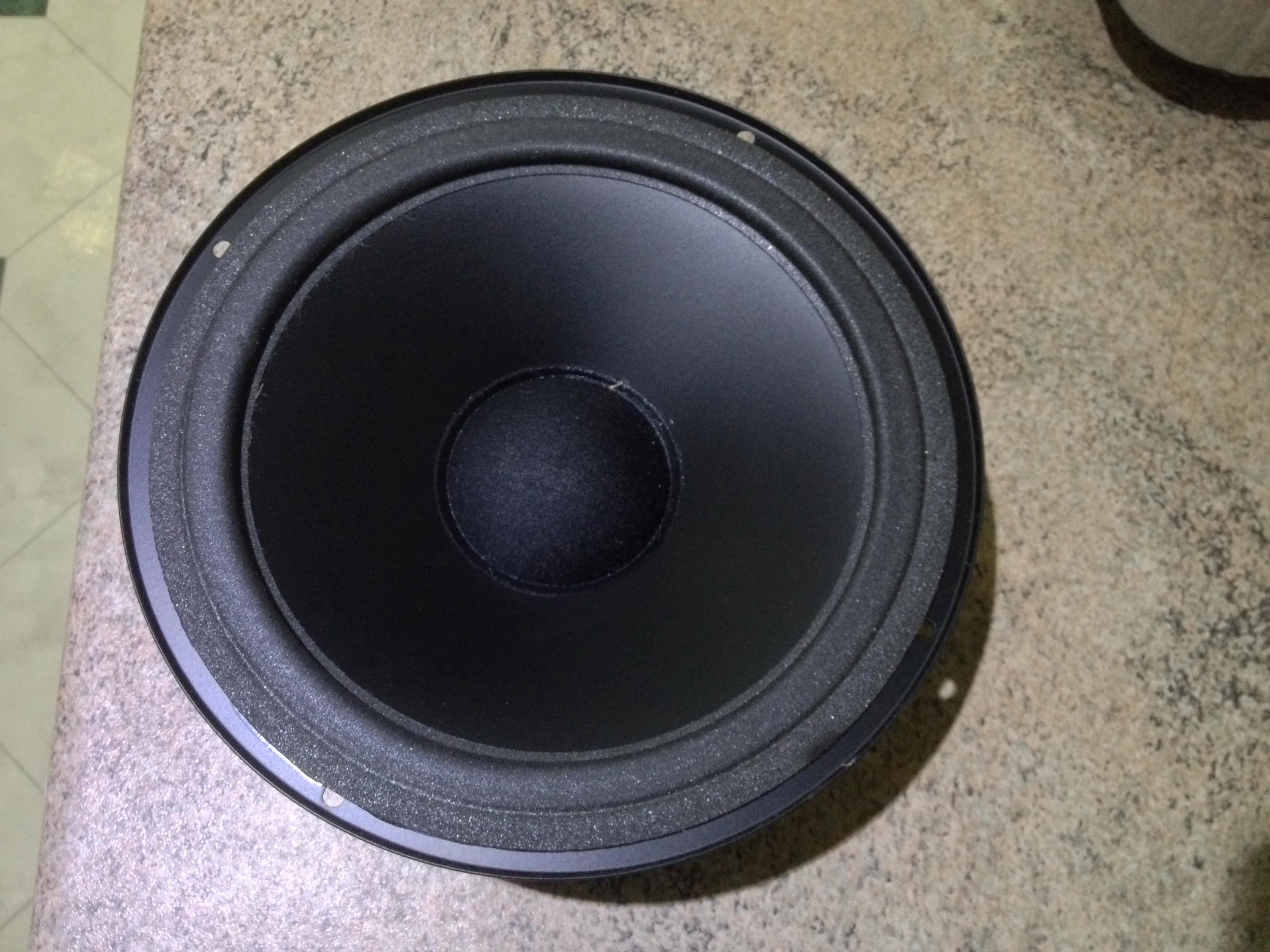

None of the cone surrounds have come unglued and I have been blasting the speakers on occasion to test how good the repairs are.

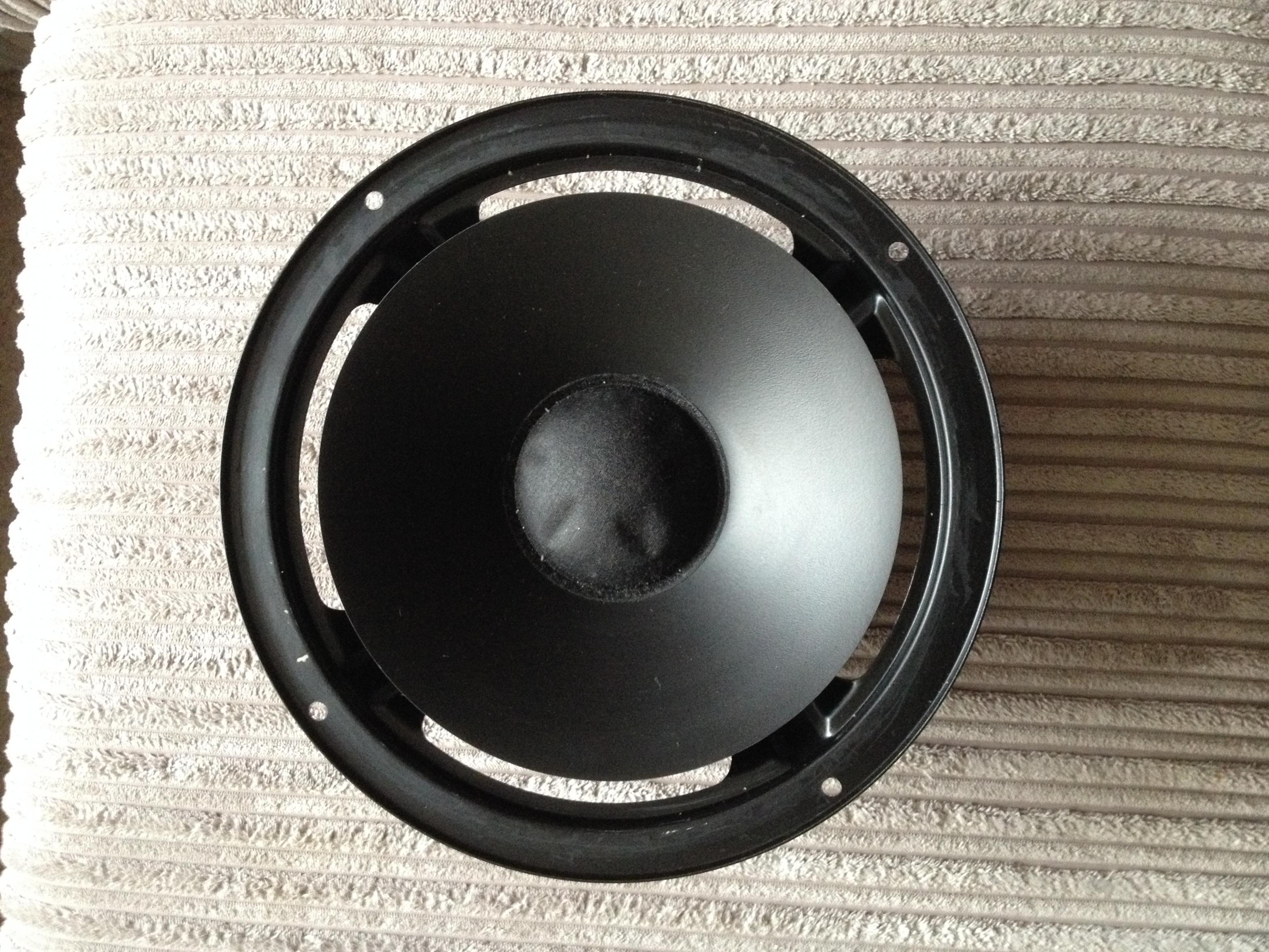

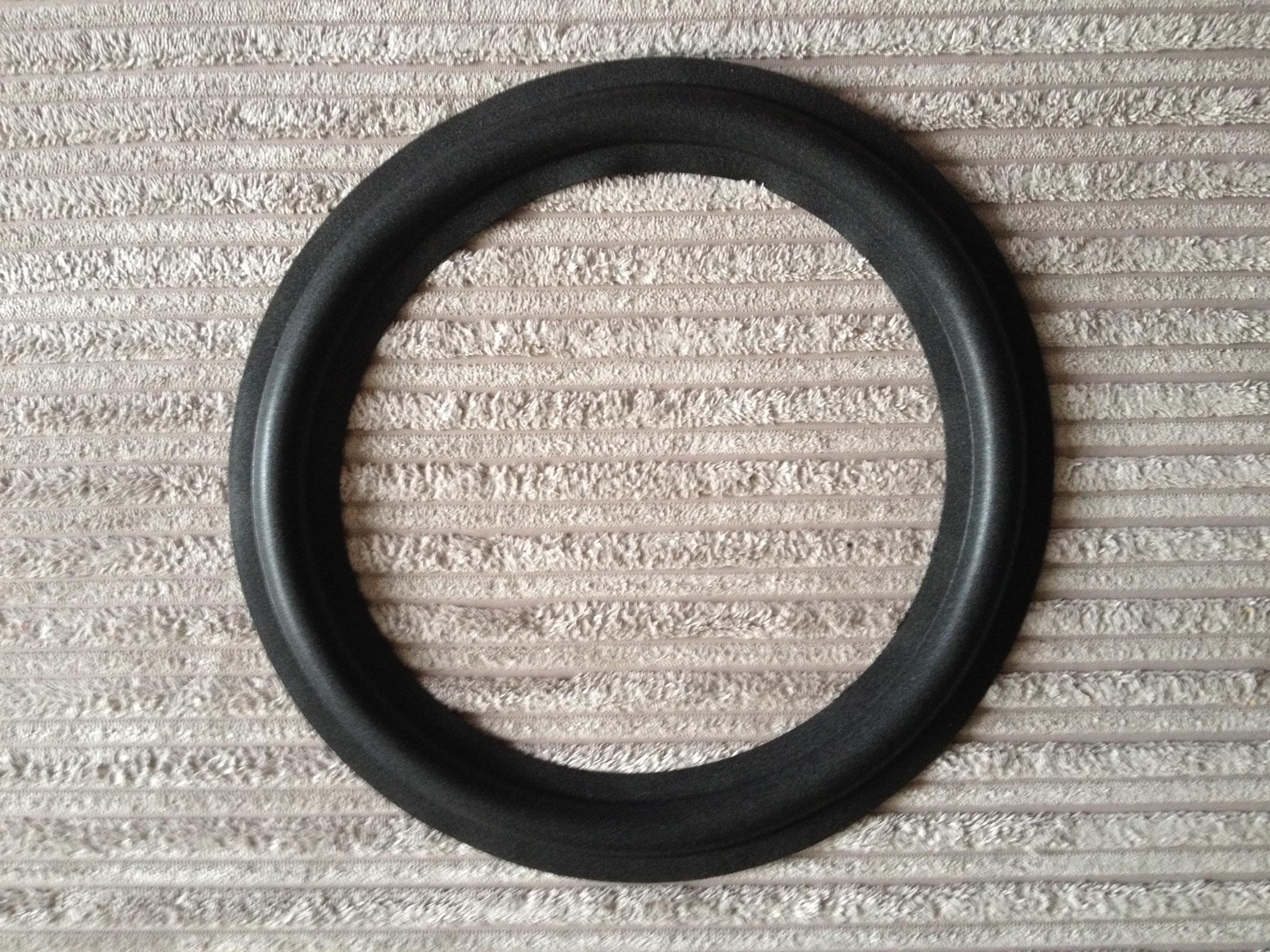

Now I have one brand new in box, never used, Peerless 832531, 10" Mission 720 Bass driver to sell which I'll probably put on the usual place, with a new replacement foam rubber surround for DIY replacement. This is because although this is a totally new and unused driver with totally intact foam it is a bit 'tacky' and I imagine has degraded over the several years I have owned it.

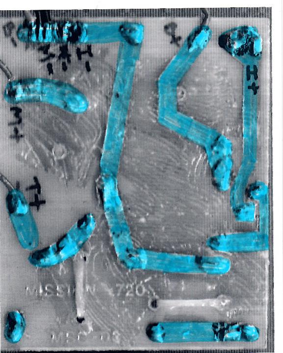

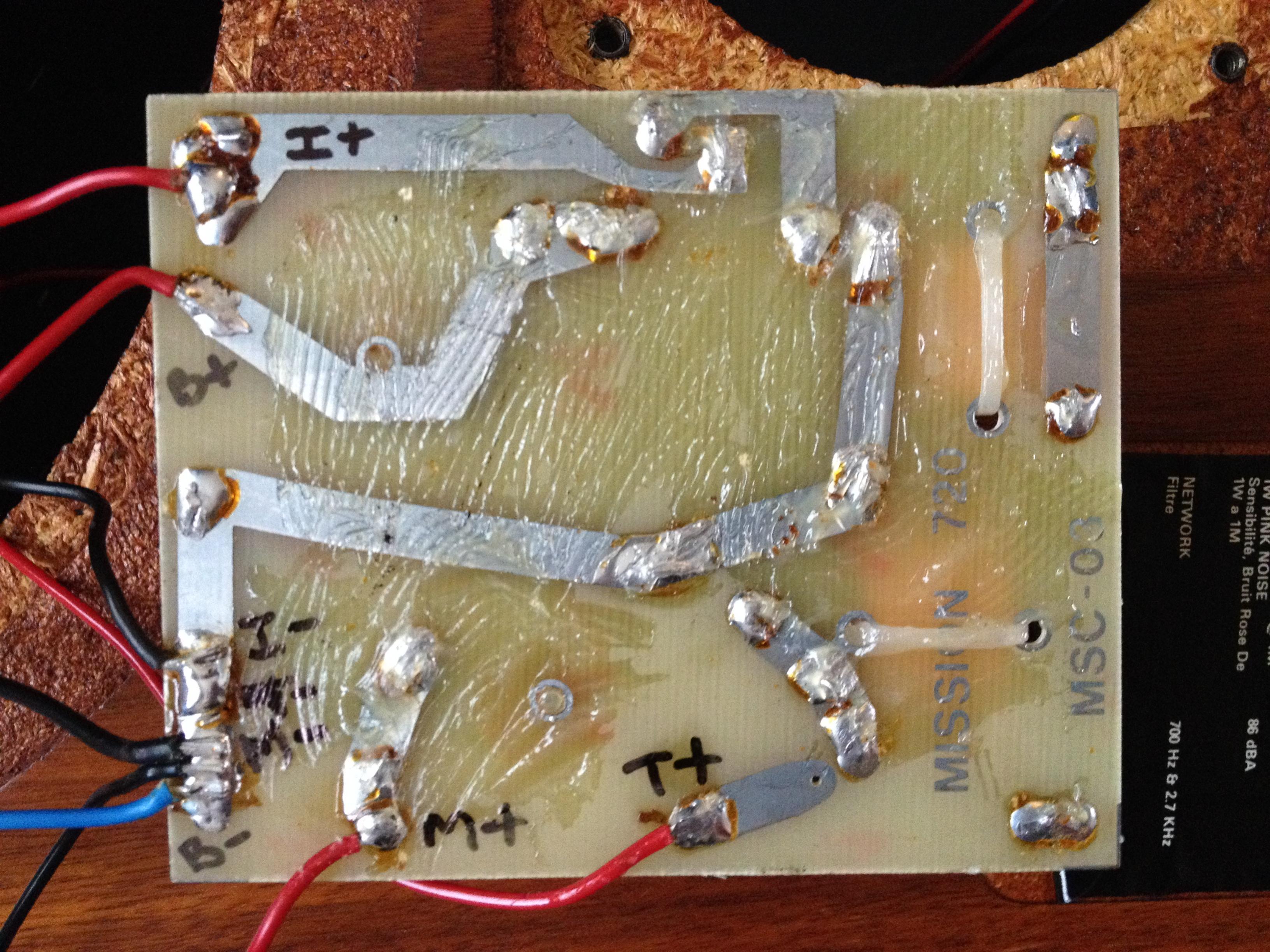

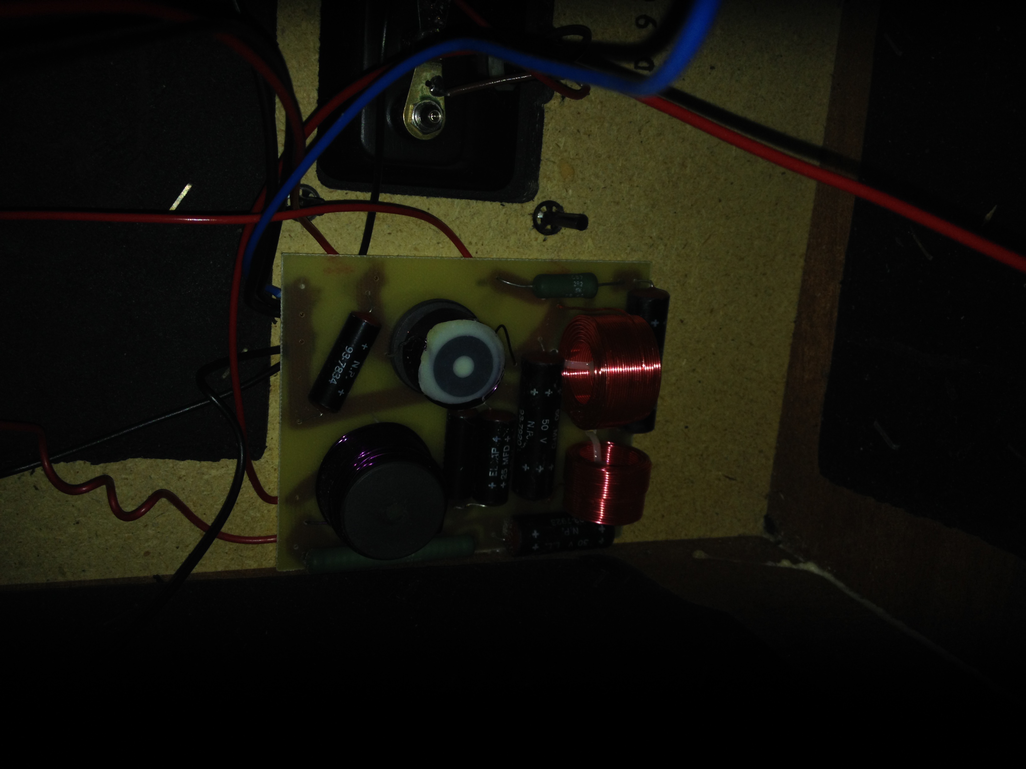

I must have been bored today, but I thought I'd try and trace the schematic... and that is hard with just a few photos. 😱
581200d1479714496-mission-720-refurb-mission-720-crossover-jpg
What I got seems wrong. 😕
I think you Mission 720 enthusiasts should check my work. Because, as it stands I could only get a 2kHz crossover to the SEAS tweeter. Rearranging things got a much more plausible 3kHz crossover.
Ah well. We need the original poster, who calls himself Mission720 to look in.

Nice work, Andy. I had found your schematic, as it goes... 😀
Anyhoo, here's where I am at now. Still that 2kHz crossover. 😕
This is like doing jigsaw puzzles. But we know it's not a million miles away from a SEAS 503:
SEAS Kit 503
If we are right so far, there is room for improvement.

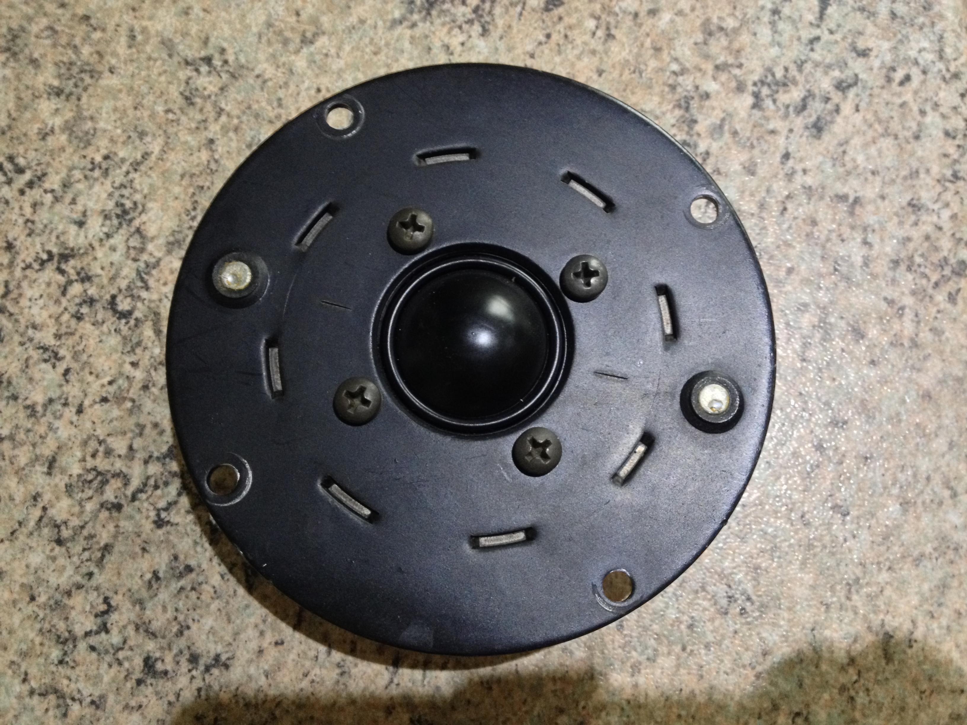

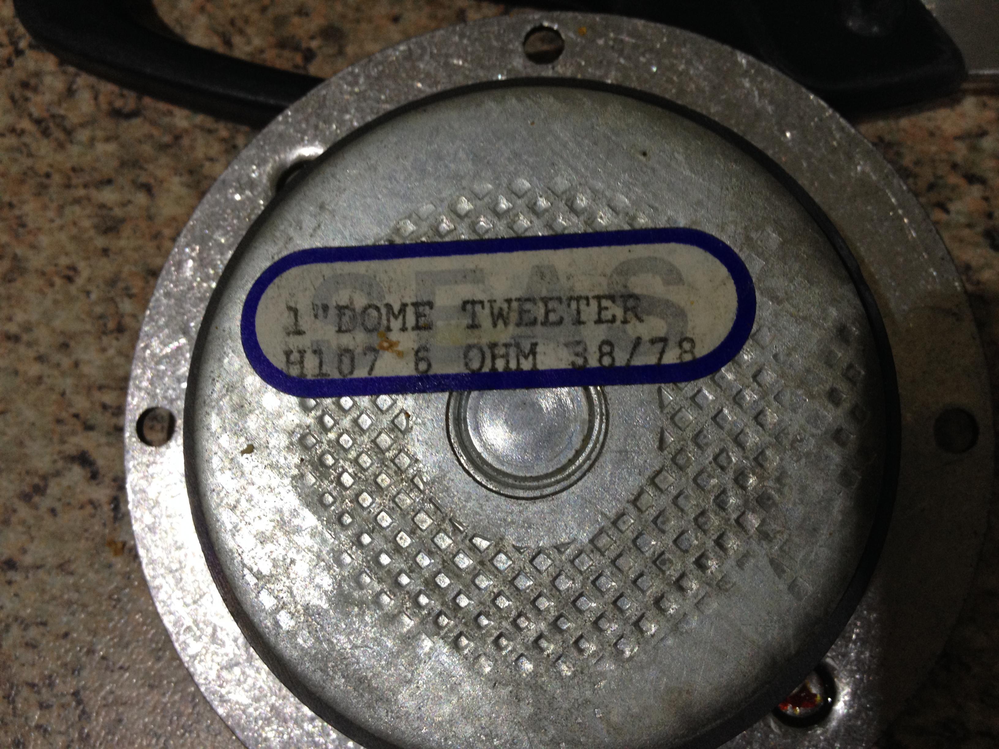

When I got mine the tweeters had both blown, so I replaced them with a similar Seas tweeter, not the H107, so I can't really comment on the proper top end frequency response, but as mine are, the top end is excellent. Apart from the Sonatello graph, do you find yours lacking?

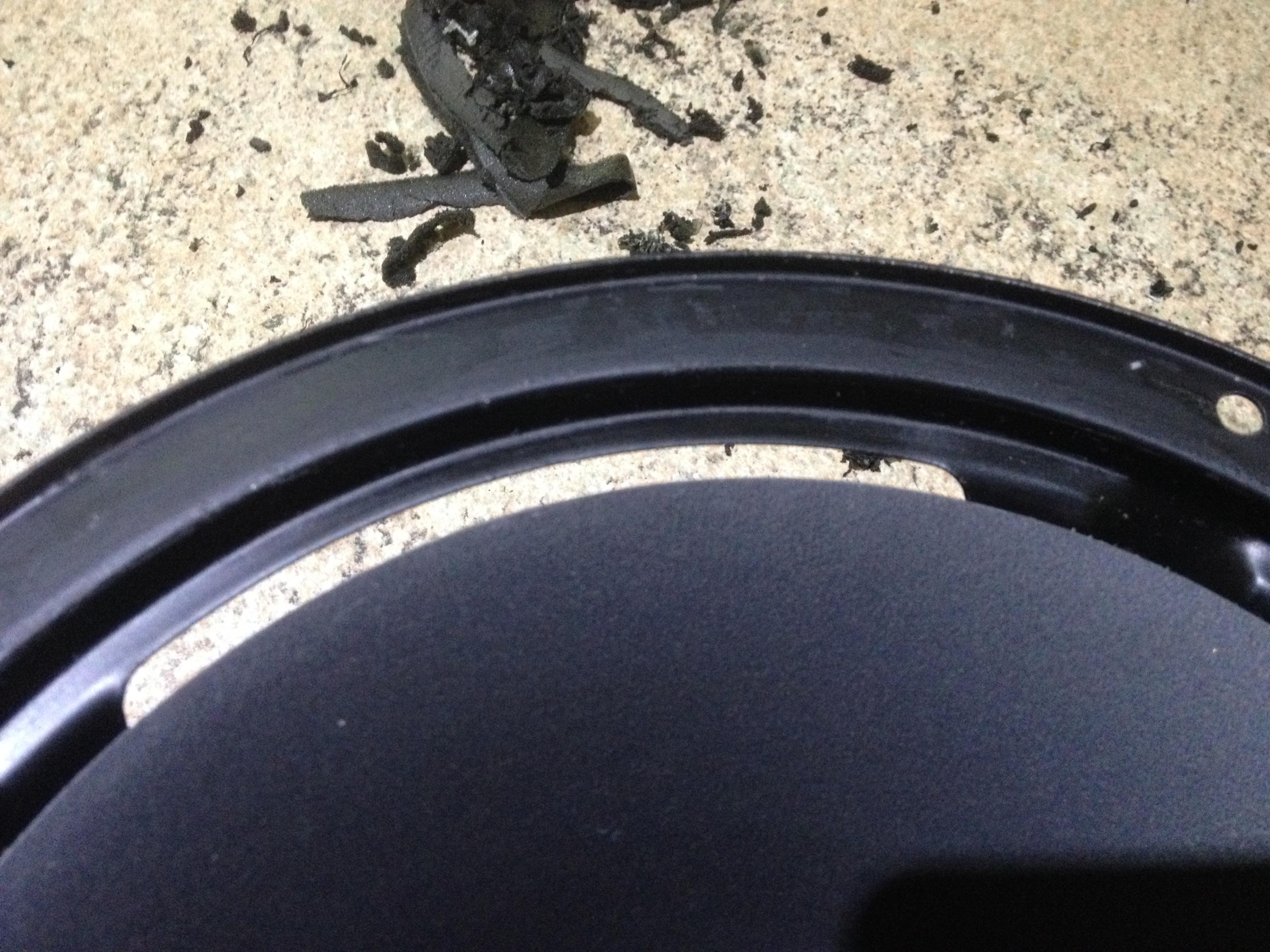

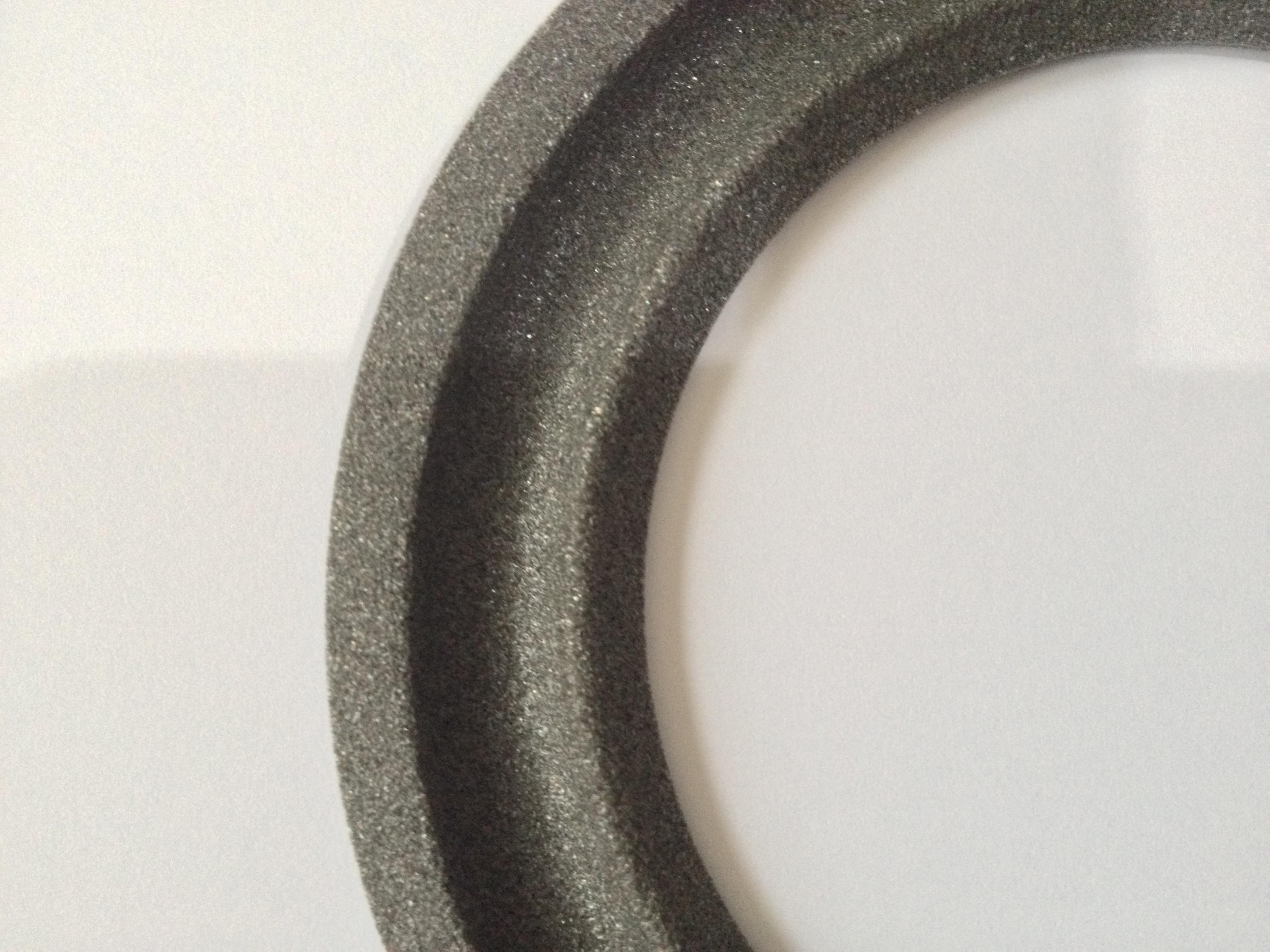

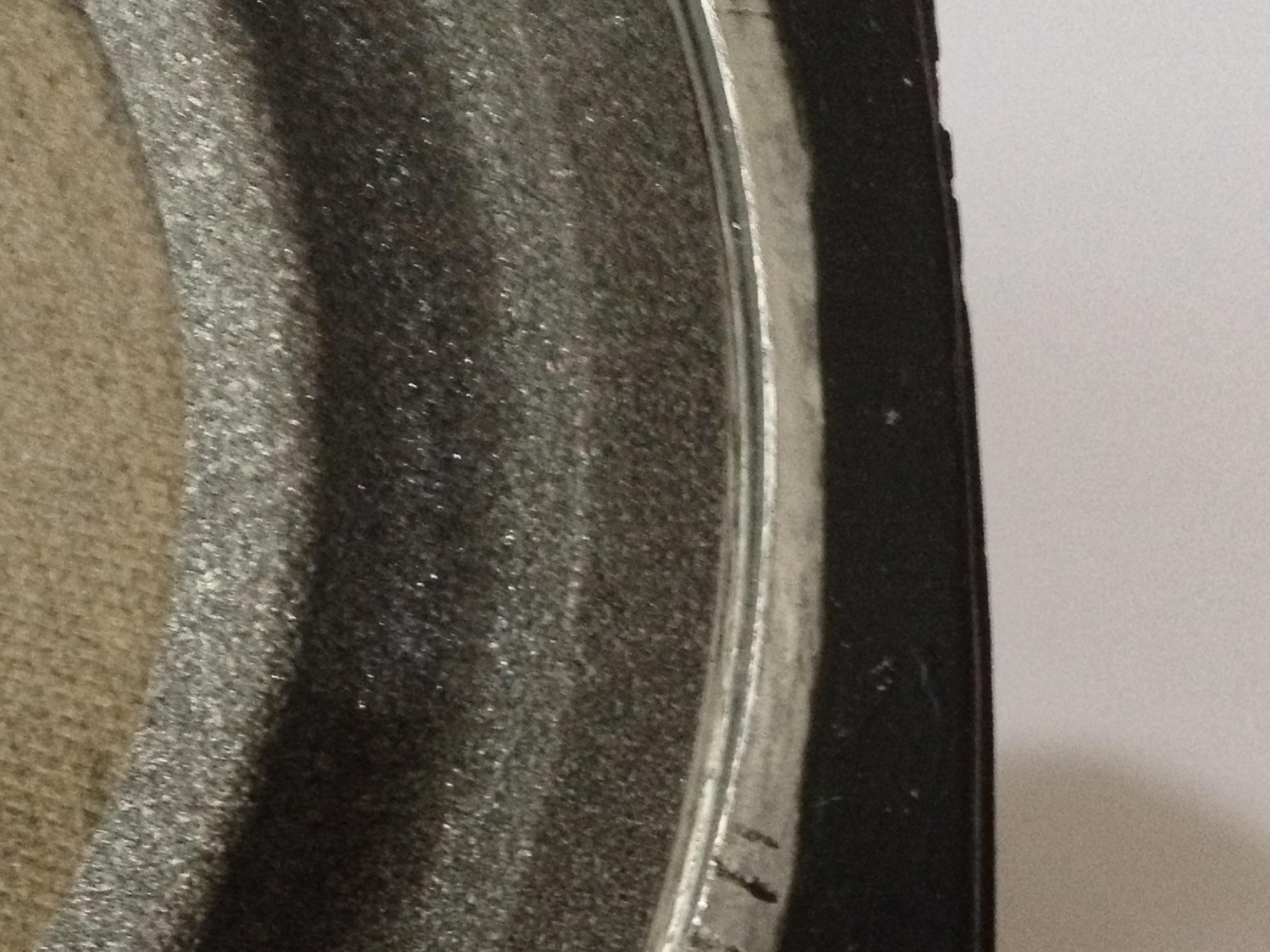

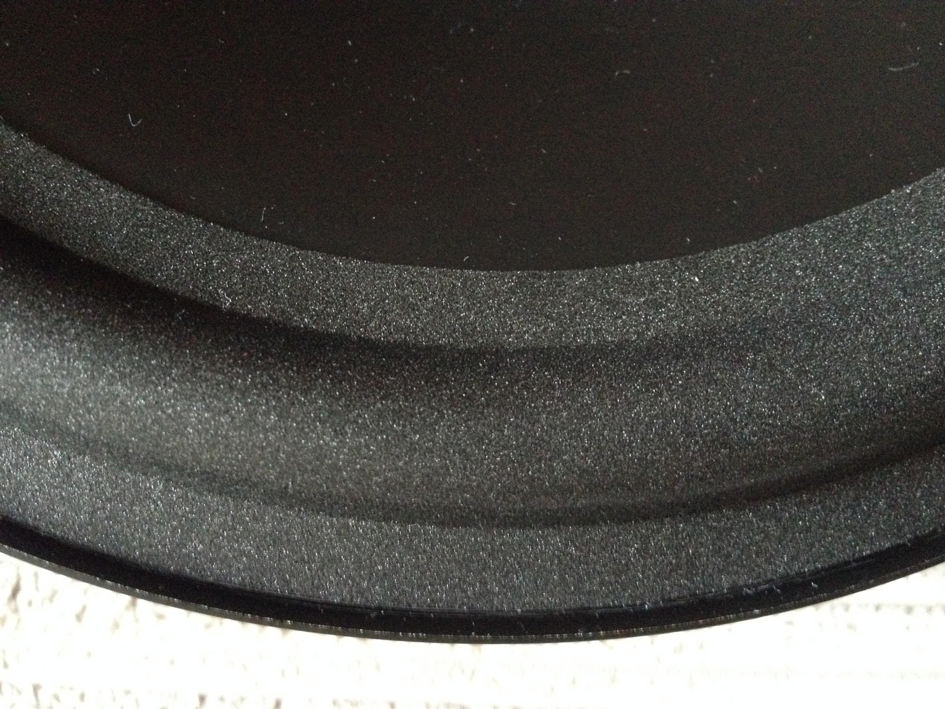

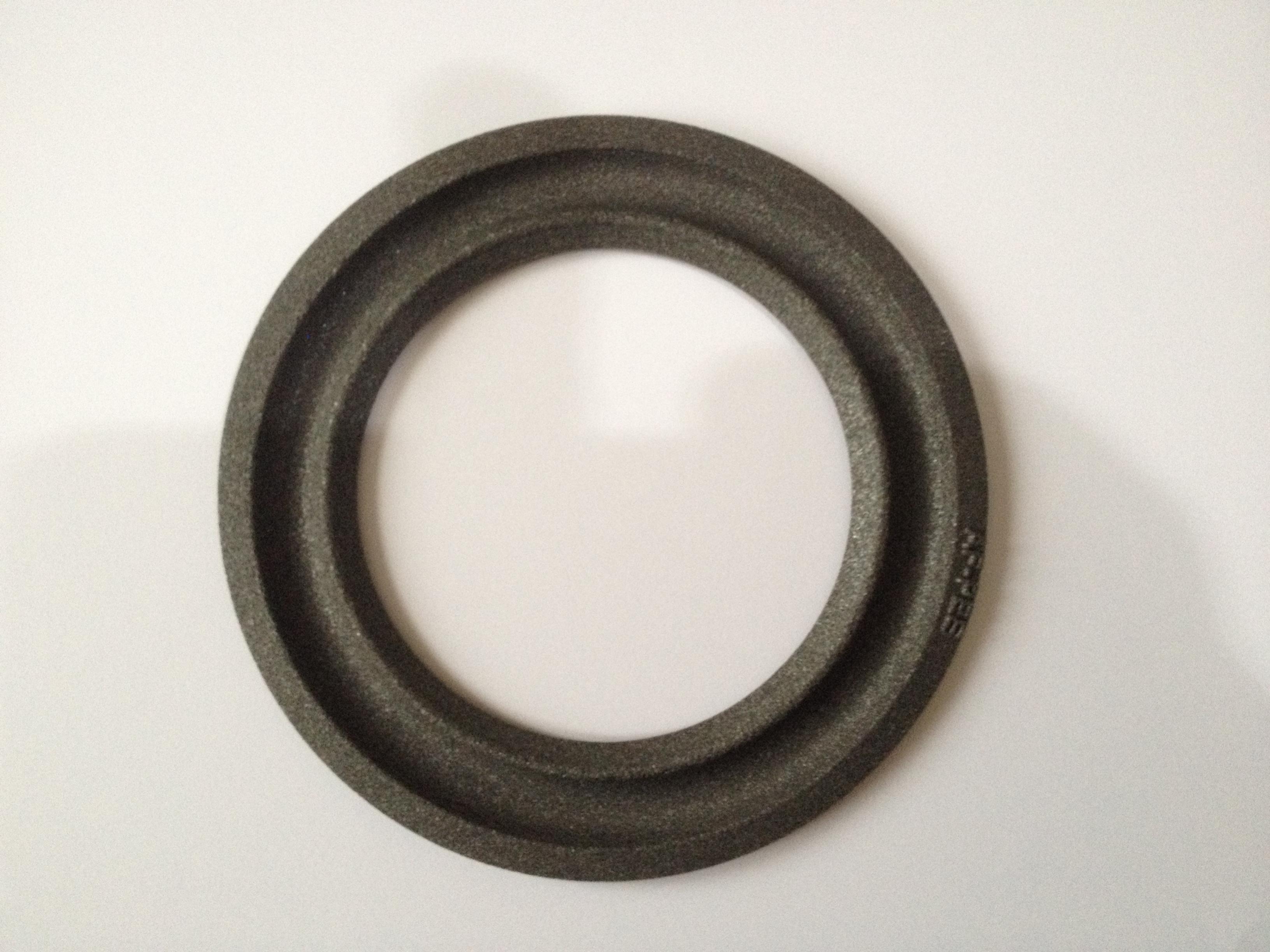

The re-foam kits for the 4.25 Peerless K040MRF Mids arrived from the Netherlands and are perfect. Note, they are of an inverted manufacture and designed to be fitted that way. The original remnants of foam came away failry easily and I used solvent on the parts for the enclosure but not the cone as that's paper.
For the remnants on the paper cone they were removed using finger nails and careful pulling. I'm sure I've taken off a few molecule thickness of paper on the glued edge but can't really be helped.
They cleaned up much better than expected to be honest as I thought the paper cone would be a lot more fragile.
The solvent removed some of the black paint on the surround but as that's covered by the cosmetic bezel I decided not to respray.

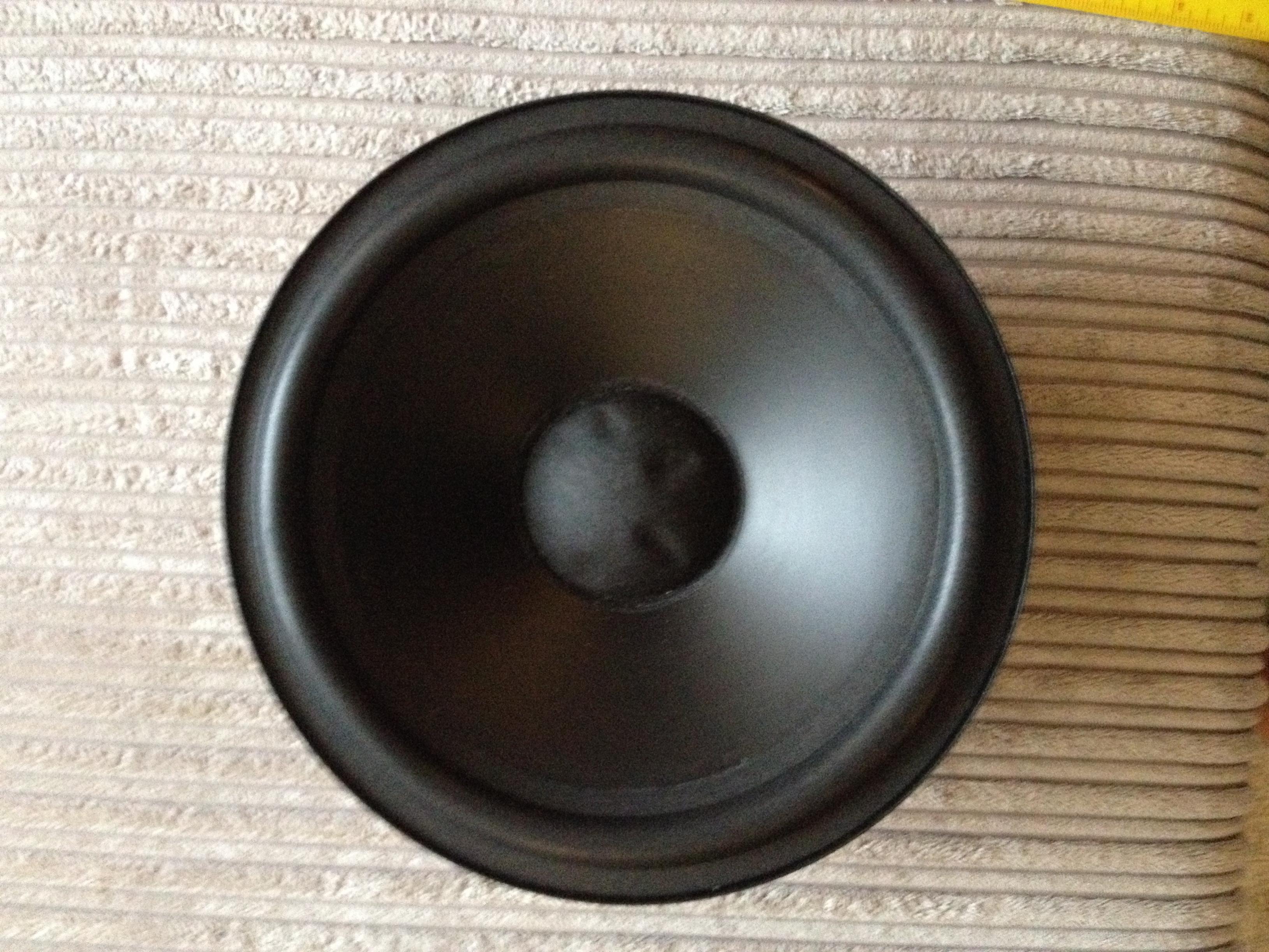

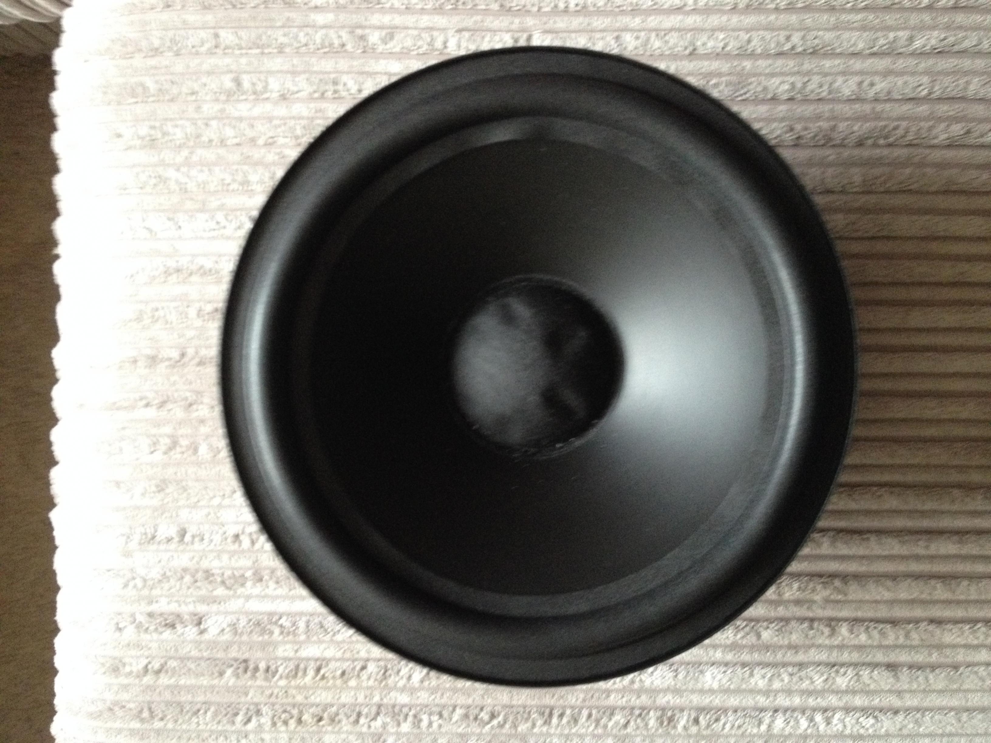

Trying without glue first, the re-foam kit sits very snugly and I could see that just a little weight would need to be applied on the surface interface of paper cone and new foam. A round porcelaim coaster did the trick.
PVA glue was used again with a generous application on the surround housing first. The paper cone needed two applications - the first was absorbed quickly and sealed/primed the surface ready for the next application.
After fitting the new foam surround I pressed it down a few times to esnure it had taken before applying the weight.
Pleased with the results cosmetically I hope it sounds good too.

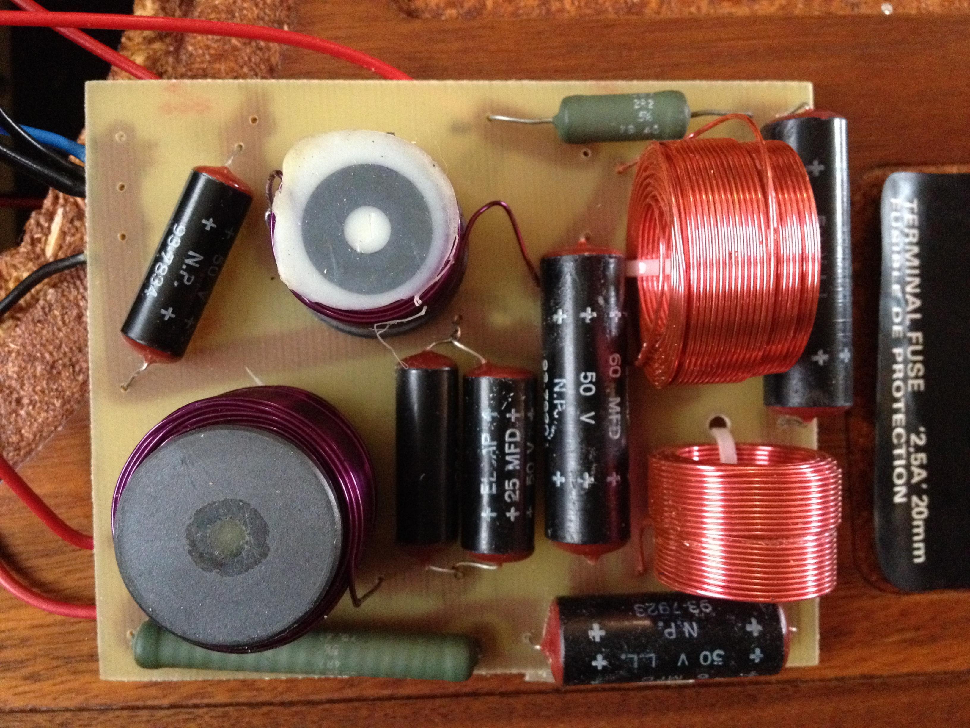

Owners of these speakers should check the capacitors on the Xover for ESR, this is tricky as the Xovers are glued on tight. It takes some gentle prying to get them off.
Andy.
