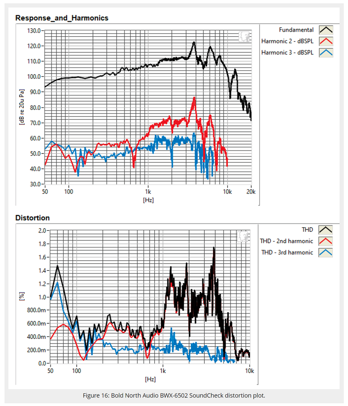

I think the main reason why the phase plug version is less impressive is because the surround is much narrower. This causes the suspension to limit xmax whereas with the non phase plug version this isn't the case.
I think they were trying to create a driver for two way systems but it's high frequency performance is such that I would never want to use it that way.
The Purifi are absurdity with regards to price. As you said there's nothing in the drivers that makes them cost that much to make.
They are state of the art though. If you look at hificompass you'll see that they have the lowest imd and pretty much the lowest midband distortion too. The performance is there but the price is not. Especially when you consider how much the Reckhorn costs, yes I'm sure the Reckhorn is fairly basic in its motor and soft parts, but to swap them out to Purifi stuff would cost almost nothing.
Improving driver performance is admirable but only if it's cost competitive. In my eyes there's no point to improving technology unless it eventually becomes the norm. We don't need more expensive drivers. What we need are the Purifi at SB Acoustics Standard range prices.

Yes exactly although the phase plug version actually has better mid performance than the dust cap. Less dip at 1.2kHz and the upper breakup isn't as bad.
To be honest the only real issue is the elevated 2nd order within this range. This is nothing massively unusual lots of drivers have this with the surround/cone edge resonance. The 3rd order is impressively low though. I do not like drivers that exhibit these resonance issues and associated 2nd order. I do not care that I probably can't hear it. It just doesn't sit well with me.

I have to look into it again.
Unfortunately the measurements at VoiceCoil magazine are meh at best (no higher order harmonics etc, only one SPL etc).
So I would love to see another person testing these. 🙂

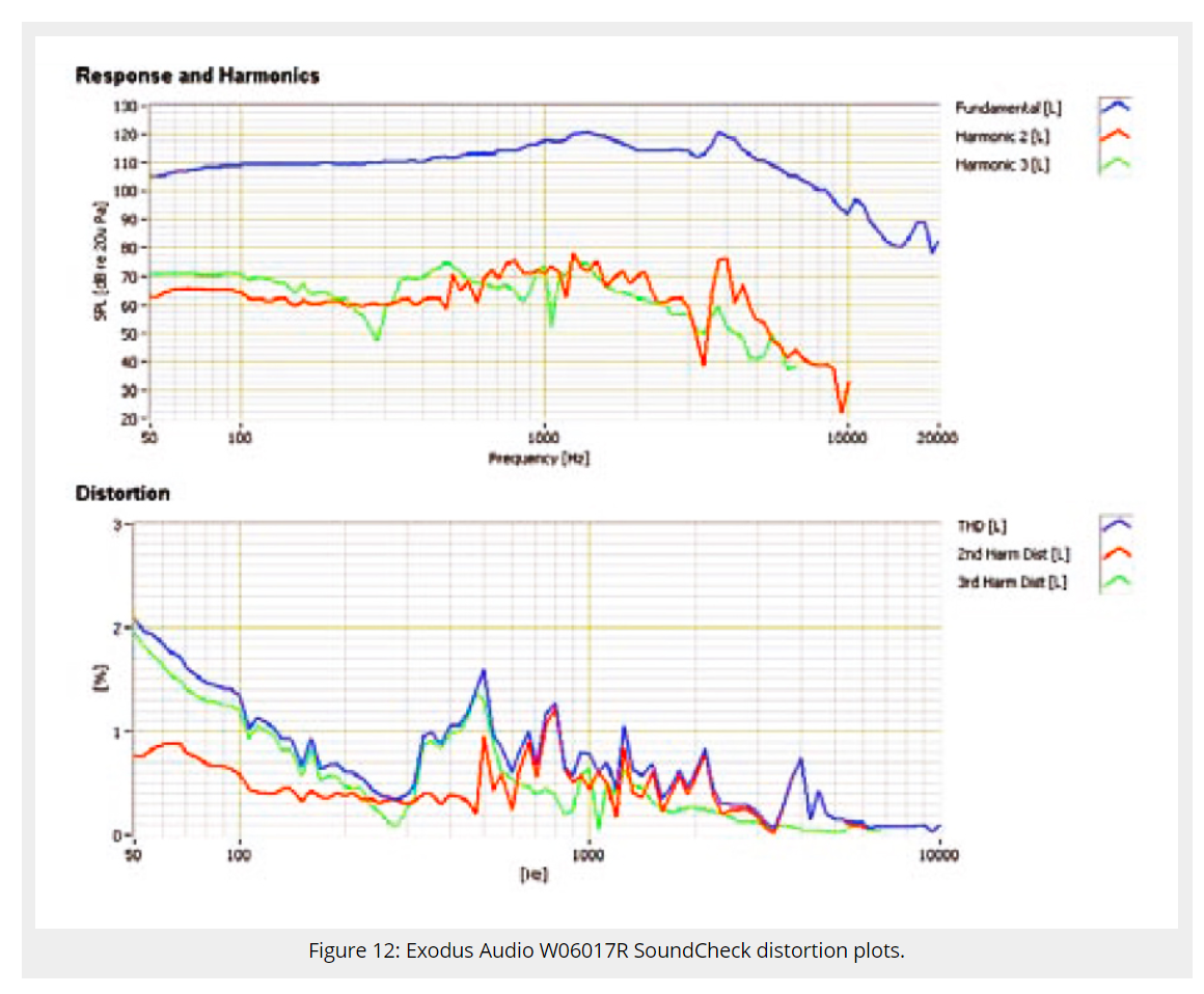

Have you considered the Exodus Audio Anarchy? It's half the cost, it's available now, it has 33% more xmax, lower distortion and XBL2.
https://audioxpress.com/article/test-bench-exodus-audio-w06-017r-anarchy
It's "only" 7.1" in diameter, but with the additional 33% of xmax, I imagine it will compete with the eight inch woofer from Bold North Audio.
  • 2022-05-04 15_43_46-Test Bench_ Exodus Audio W06-017R “Anarchy” _ audioXpress.png
  • 2022-05-04 15_43_59-Test Bench_ The BWX-6502 Midbass from MISCO’s Bold North Audio Line _ audi...png
Reactions: augerpro
John> yep I looked at the Anarchy. Very similar Klippel, but I think the MISCO has optimized soft parts a bit better, with a broader Kms(x). I also like the Le(x) variation is both miniscule and symmetric in the MISCO (also mentioned by Purifi) versus the Anarchy. So the MISCO has better harmonc distortion in the region I'm looking at. That said, if this distortion mechanism is an important and under-appreciated problem, the Anarchy is a no-brainer for a lower cost design.
I agree, if the 8 inch MISCO will be similar to the 6 inch, it could be a potential good candidate.
