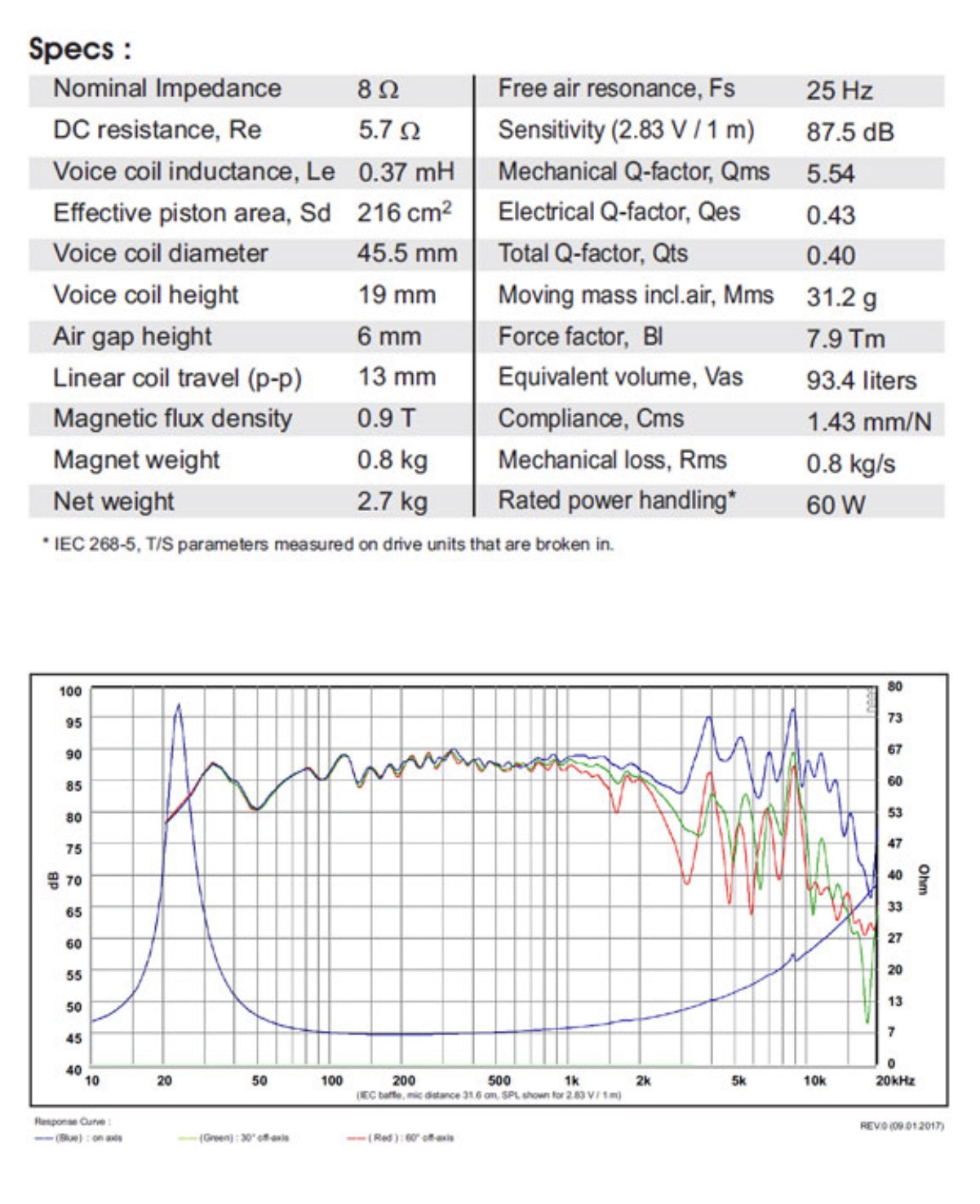

Here is the SB23NBAC data:

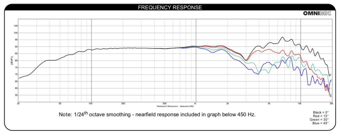

Here is RS225-8’s frequency response:
The RS225-8 has a much smaller 57 liter Vas making for a more compact cabinet.

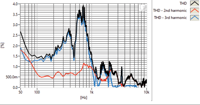

I agree with Earl on the whole “THD is useless” idea. Because all those old distortion studies only look into THD a which is a blunt tool, Or only look at H2/H3 which weighs heavily on THD.
but distortion is far more complex than THD.
in transducers and complete speakers we’re talking 1% or 10% or 20% THD. Why are we using those limits? Because in studies it what’s listener find as objectionable distortion “I hear bad distortion”
But I’m not interested in “hearing distortion” I’m interest in hi-fi in terms of closest to the signal as possible. So all those 3rd orders and higher orders eg. 5th, 7th etc matter.
Why does Earl use a minimum of 10” midwoofer for his speakers. Perhaps when a 6.5” or 3” in a most compact form factor might suffice?
Erin Hardison is the first (as far as I can know) to publish compression testing in a systematic way. Have a look at the JBL M2 and March Audio Sointuva and compare the compression/distortion measurements to something like the Edifier MR4

So in the newest VoiceCoil magazine the E180HE-44 was finally tested.
Usually this article will be free to read online roughly a month later.
Doesn't look as promising as we hoped 🙁
In the BL(x) and Kms(X) graphs the driver seems to suffer from quite some (dynamic) offset as well.
Tested at 94dB as they do by default.
Displacement limiting numbers calculated by the Klippel
analyzer for the using the full-range woofer criteria for
Bl was XBl @ 82% (Bl dropping to 82% of its maximum
value) equal to 11.8mm for the prescribed 10% distortion
level. For the compliance, XC @ 75% Cms minimum was
9.7mm, which means that for the Dayton Audio woofer,
the compliance is the more limiting factor for getting
to the 10% distortion level. However, if we use the less
conservative 20% distortion criteria, XBl @ 70%>12.6mm
and XC @ 50% >12.6mm, showing the Bl number close to
the physical Xmax of the driver.
Practically you will have around 9.7mm at 10% criteria.
So compared with the same 10% criteria, the MISCO BWX-6502 performs significantly better while having roughly the same xmax (at the same 10% criteria that is). See MISCO review here;
https://audioxpress.com/article/test-bench-the-bwx-6502-midbass-from-misco-s-bold-north-audio-line
MISCO only gives the minimum xmax, so I don't know if the 6502 is capable of providing more excursion and/or what the 20% numbers will look like.
For people living in the US both woofers are basically the same price.
So my advice would be to go for the MISCO instead.
I would definitely not recommend the 180HE for any midrange usage.
3.5% K3 distortion is not something to be proud of.
It's unfortunate, relatively speaking the 150HE looks better, but unfortunately that data could not be extrapolated.
I've never seen a 3rd harmonic behave so badly
Me neither, almost makes you wonder if there is something wrong with the sample?
The offset was also quite bad to be very honest.
It's a little annoying that they don't show higher harmonics at VC, because it will give a lot more information about what's causing it. The impedance plot looks pretty fine (not shown here, you have to read the full article)
The 150HE wasn't that bad either; (considering its size)
https://audioxpress.com/article/tes...e-subwoofer-from-the-dayton-audio-epique-line
I think they make good little woofers, but as a midwoofers there are probably better available options.
The PE datasheet had hinted that the H3 was higher than the H2, although you really have to be familiar with Omnimic's colour scheme and a be pixel starer or trainspotter to figure that out.
But this was confirmed by our friends over that HT Guide over a month ago:
http://www.htguide.com/forum/showthread.php?44788-A-New-Design-Study-in-progress&p=641013#post641013
