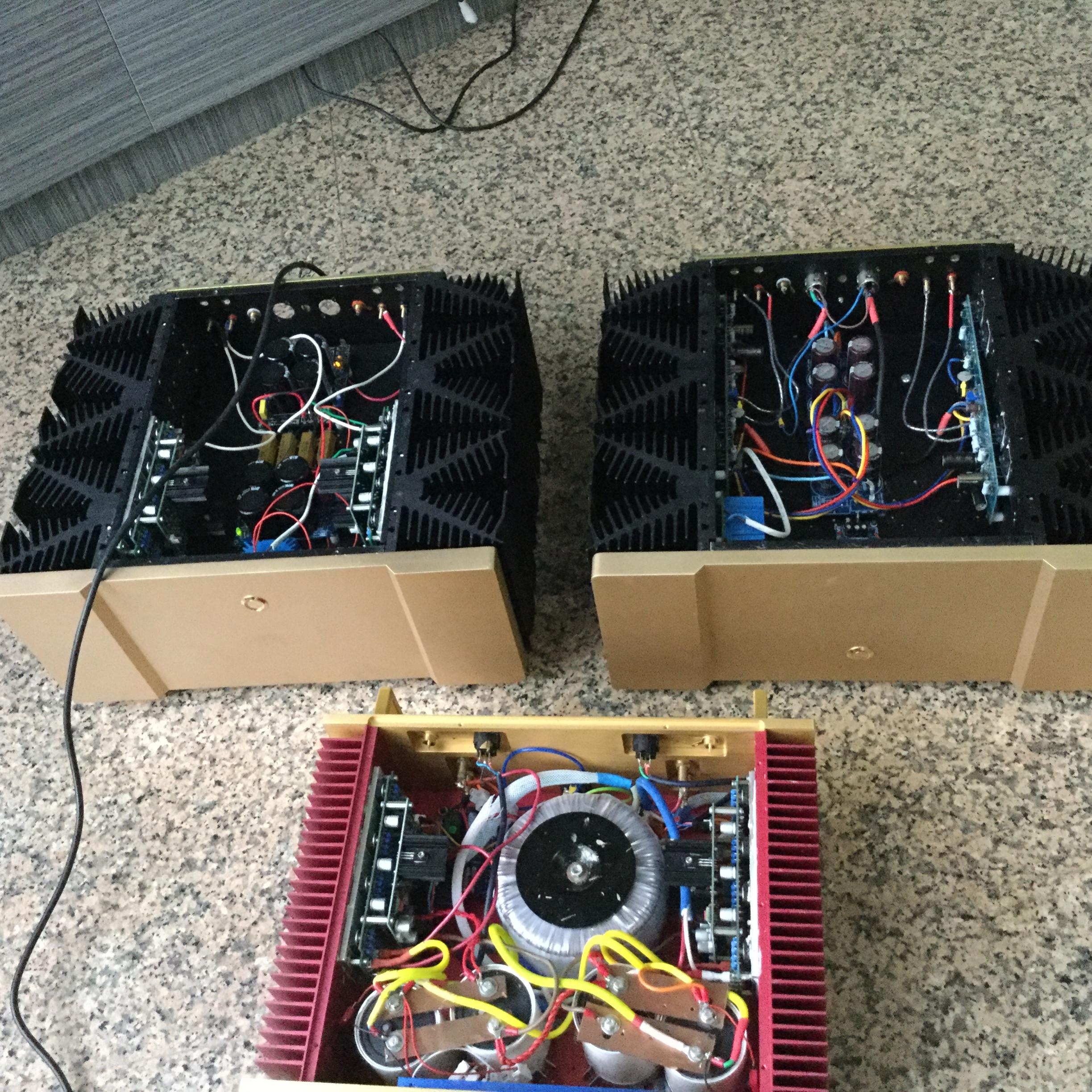

Finally finish tasa v4
Finally finish tasa V4
First one Tasa V4
1x800 va sec 2x30 v basic (0.8)A
Cap 188,000 ur
Second one tasa V4
Dual mono
2x500 va sec 2x25 v basic (1.6)A
Cap 120,000 per Chanel
Third one
Aleph J
Dual mono 1.6 A
Dear sonny sadly speaker protection board not working with 3 amp ..now using cheapo Chinese protection board .

They look really really nice and does not look like DIY at all. Congratulation.

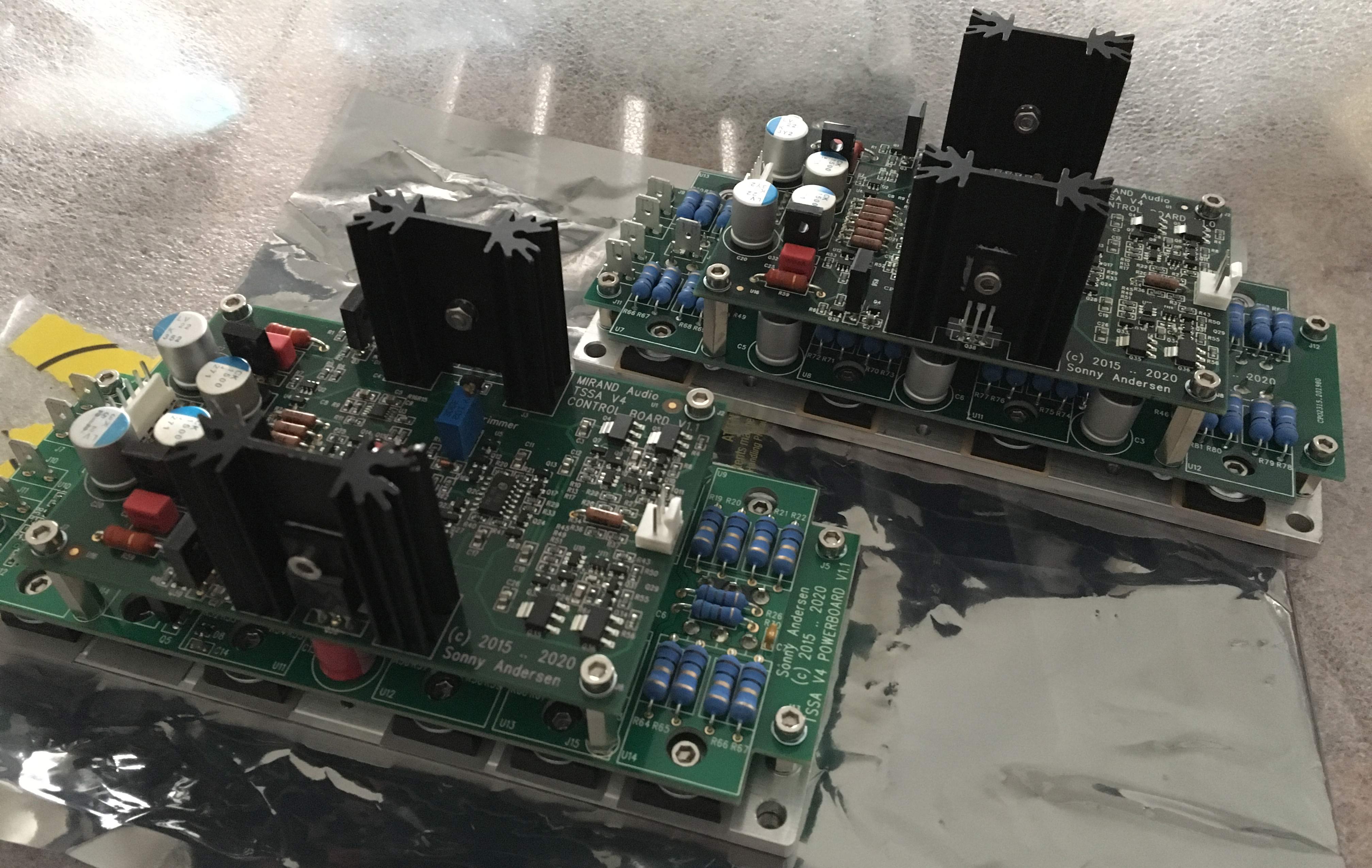

Hi Sonny,
what is the difference between these two V4 modules?
Again
The bottom module also has speaker protection.
For the top - you need separate protection.
As performance - they are the same.

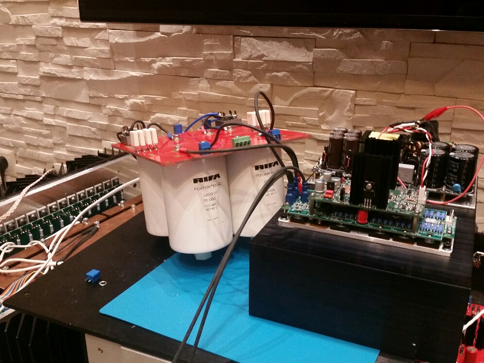

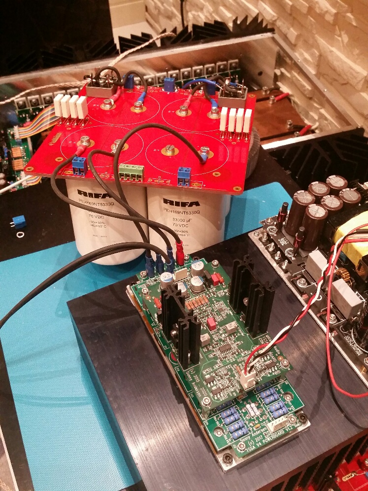

I wish to congratulate Sonny, TSSA V8 is a superb amplifier!!!!
I'm sorry about one thing, I've kept him in the box for so long without trying it.
It is very fast, with an articulated bass, crystalline voices, without fatigue, very silent.
I have been listening for hours on this wonderful amplifier, I really like it very much and you are one of my favorites. And Sonny was right, the best sound is with the classic PSU. I tried the switch, but I was not happy.
Once again, thanks Sonny!

Hi vitalica
I am very happy that you like it. It is a very serious power supply you have there. 4x33000uF PEH169. You own my respect !!!!!
