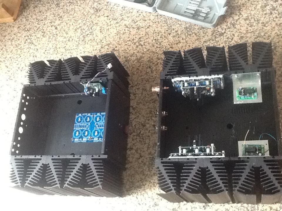

TssaV4 is really good amp'after 6 month listening I would like to update news chass ,idea for using higher basic (1.6A) , 2 x 1000va Sec 35v dual mono.
I prefer tradional power supply than SMPS, l

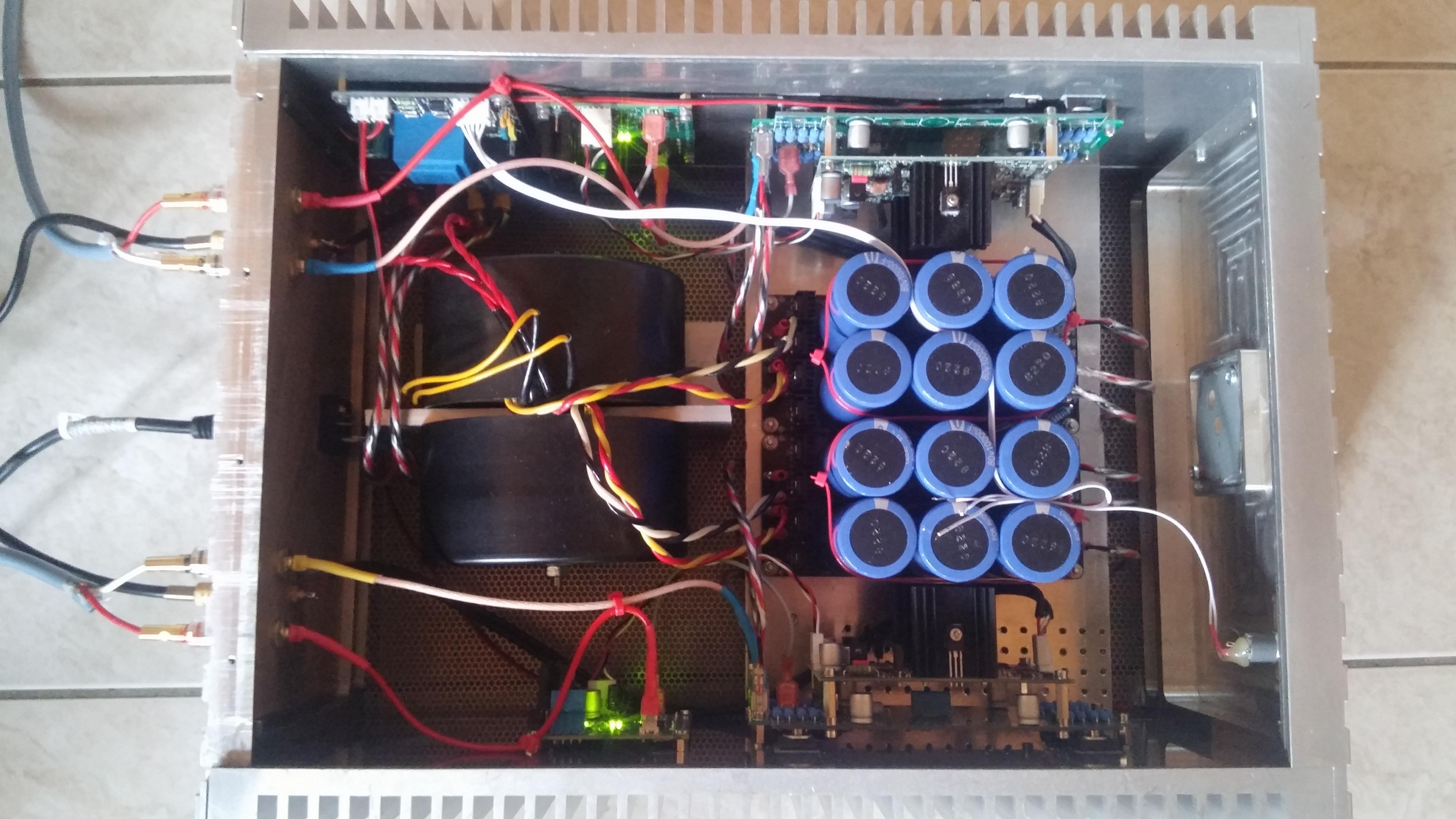

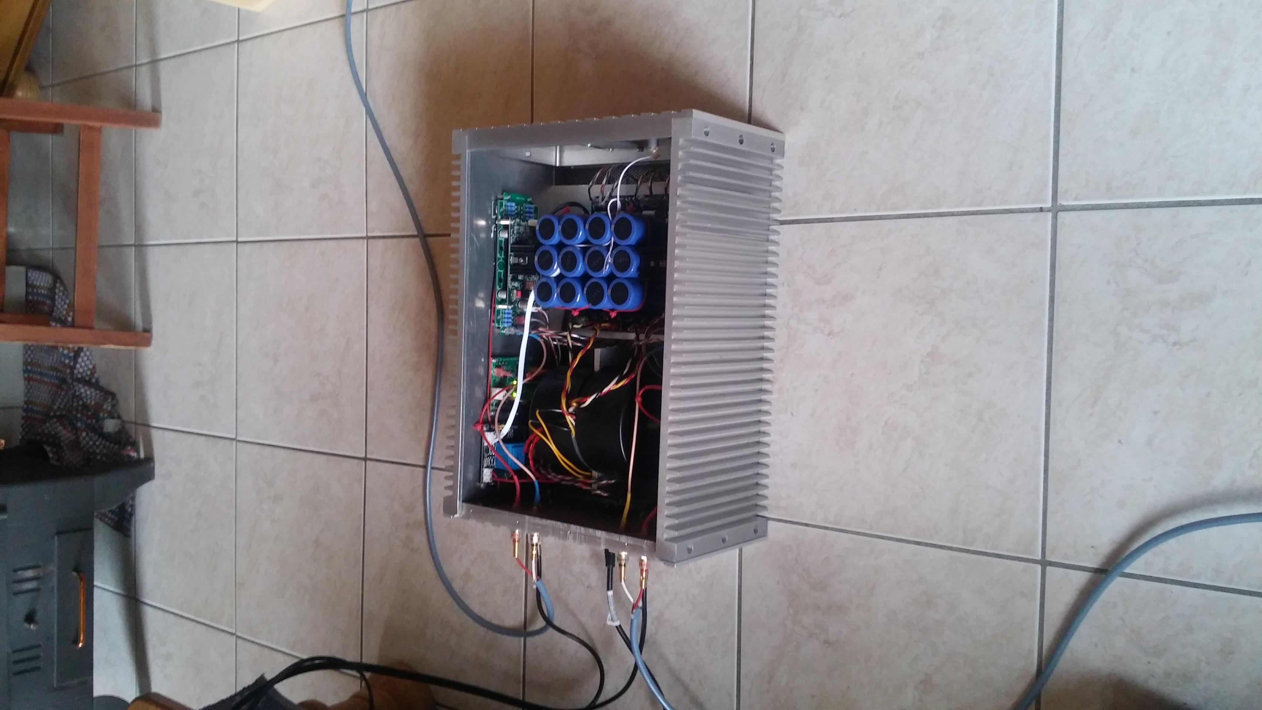

Here some pics of my TSSA V2 taken with a smart phone
Per channel 2x35Vac/340VA audio transformer and 60mF/80V PSU
Inrush protection module with 75°/C temperature protection
