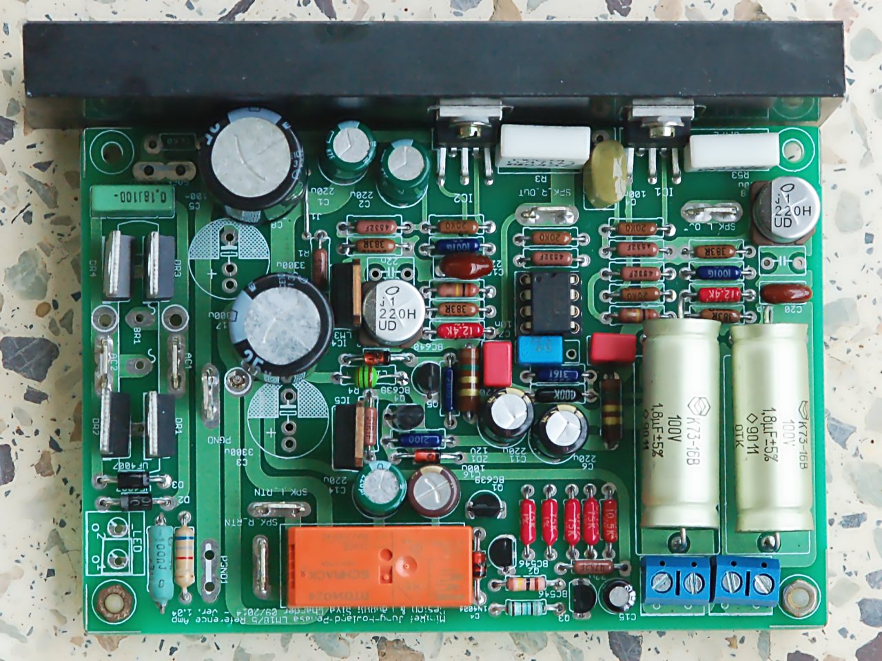

Uriah, I now have a MiniRef working fine with ST TDA2050 chipamps. This is the latest schematic and layout revision (v1.04), and includes a series-shunt regulator upgrade (basically borrowed from Dario's MyRef FE, but entirely through-hole) and a few other minor build upgrades to passive components.
It's Apples vs. Oranges, but my preliminary impression is that this particular MiniRef prototype with TDA2050s sounds even better than the previous one with LM1875s. I'll give an update later with pics and audible impressions, after I listen to some more tracks.
OK, here's a pic of the prototype MiniRef v1.04 with TDA2050 chipamps (it can also interchangeably use LM1875 chipamps):
The main upgrades are the improved series-shunt regulator for the opamp, and an inductor AC-decoupled small-signal ground. The BoM is otherwise nearly identical to the previous versions.

I haven't taken the decision on uploading the full schematic here. However, as a broad hint, it's basically the same as the published v1.02 schematic, with the addition of the series-shunt regulator from the MyRef FE, for the op-amp rails. Other changes are minor.
