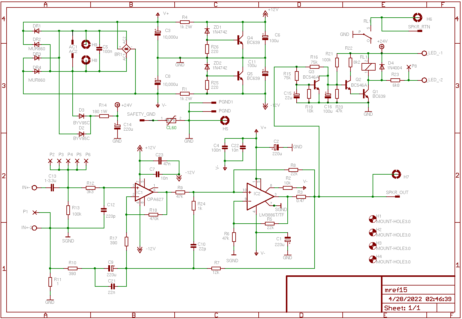

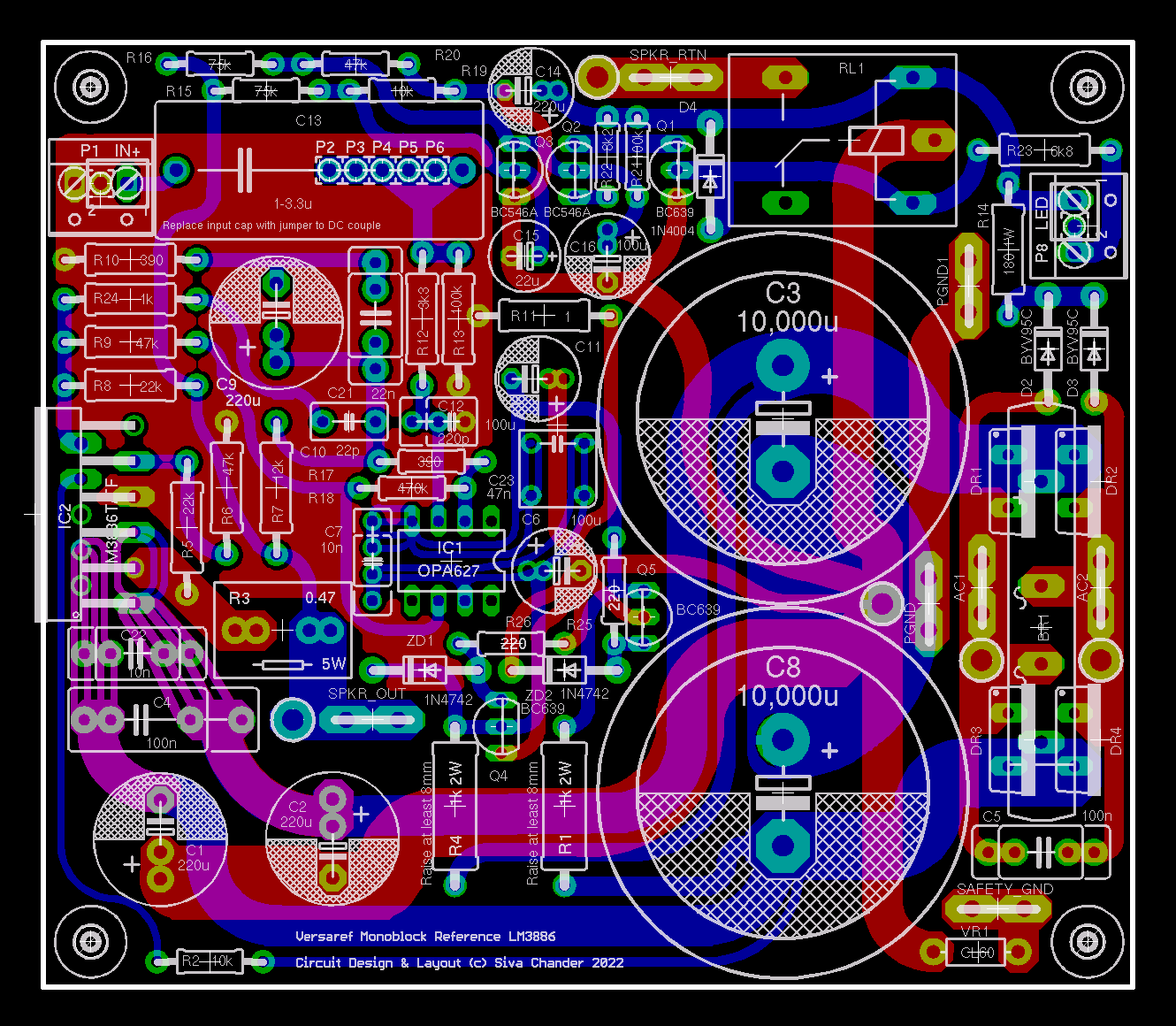

Sorry - I was off the forum for a while due to health issues and some other unrelated stuff, but I finally got around to doing an LM3886 monoblock version of the MiniRef. I started with my older MyRef Rev C v1.4 layout and tweaked the feedback loops to use the Walt Jung double non-inverting topology of the MiniRef (MyRef is double inverting, and has a unique compensation network that limits the usable opamps to less than a handful - LM318, TL071 and a few other slow and venerable opamps). I also transplanted the opamp rail shunt-regulator from the MiniRef V1.04.
The result is the VersaRef - it should be a direct drop-in replacement for the MyRef Rev C v1.3 and v1.4 boards, but with a large range of usable opamps for the outer loop - LT1360, LM6171, OPA627, LME49990 and maybe some discrete opamps, should work with minor tweaks. Here's the schematic and layout if you want to re-do it in Eagle or anything else. Alternatively, I'll try to get PCBs fabbed in due course from Gerbers after re-checking everything to make sure that there's no major screw-up.

What is the benefit of the jung type feedback tho compared to a single cap of say 470pf value?
Also i see that youve omitted the 3k3 1nf stabilizer between the input pins of 3886 and is the design still rock stable without it?

Single cap at C10? I think 470 pF is a bit excessive, but 47 pF might be right - will have to build and listen to the sonics.
Thanks - In the hurry to do a quick mash-up, I forgot the inter-stage Zobel of 3k3 + 1nF. I'll add something there - maybe just plain 220 pF as in the NatSemi AN, or 1k + 3n3. Maybe also a small pF value parallel to R6 to ground on the chipamp inverting input.
OPA551 is news to me - great high-voltage rail specs. Should be workable for the MiniRef/VersaRef, but you probably want to filter the opamp rails anyway, with or without a shunt regulator. Maybe just a series RC or LC network on each rail.

Linuxguru could you perhaps sim what i did with the interstage zobel?
3k3+ 1nf was too bright sounding (hint of instability?) So i changed the R to 2k. Treble became more calm. Then i tried 270ohm+ 330pf. This was even better subjectively. Better behaved treble, everything more transparent.
As i understand it the value of the cap corrolates to the range of freq it attenuates and the value of the resistor how much of it?
Id like to see if 470ohm+ 330pf is stable in the sim (the values i will be trying next) and what the lowest values i can get away with is.
220pf by itself was unstable, btw.

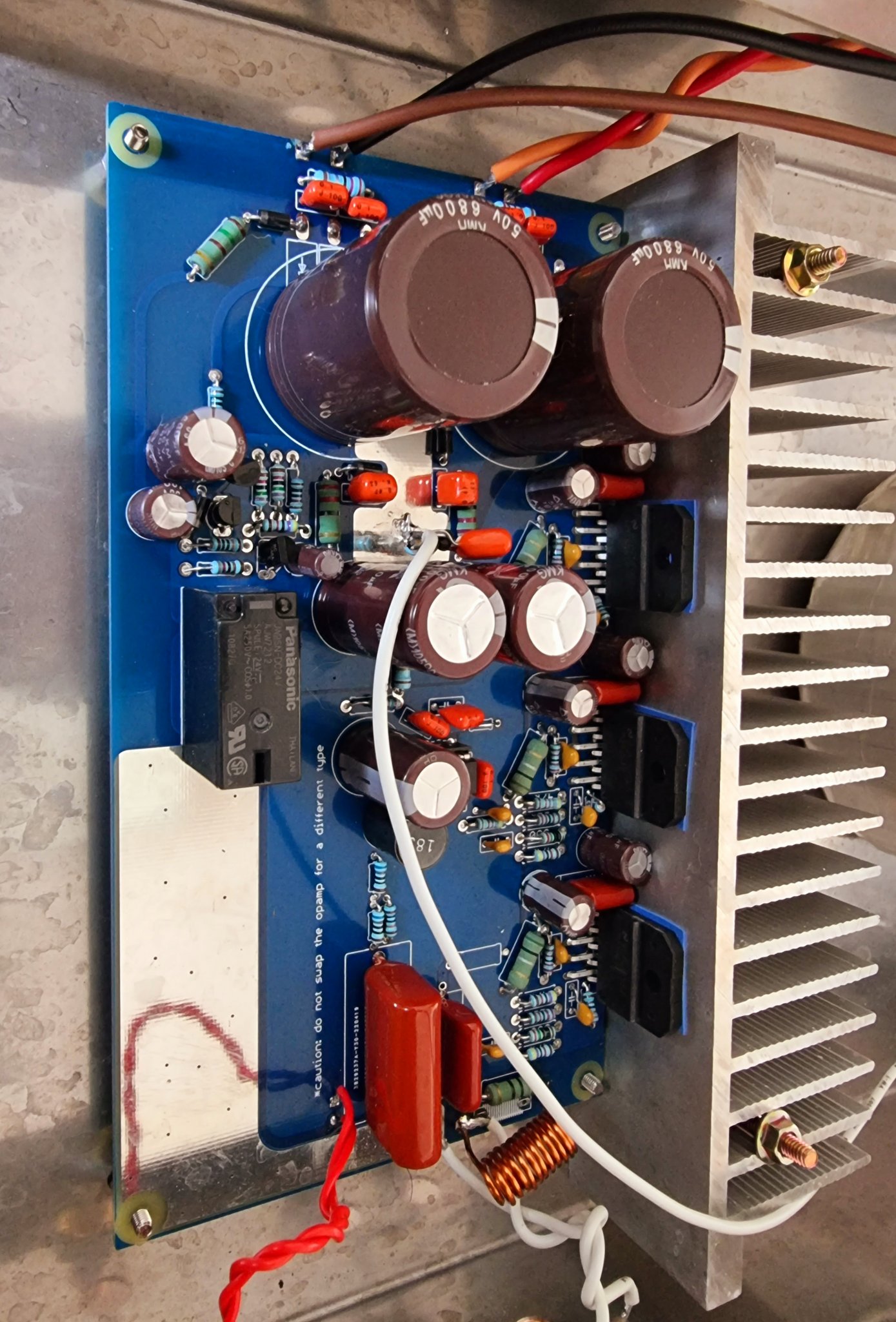

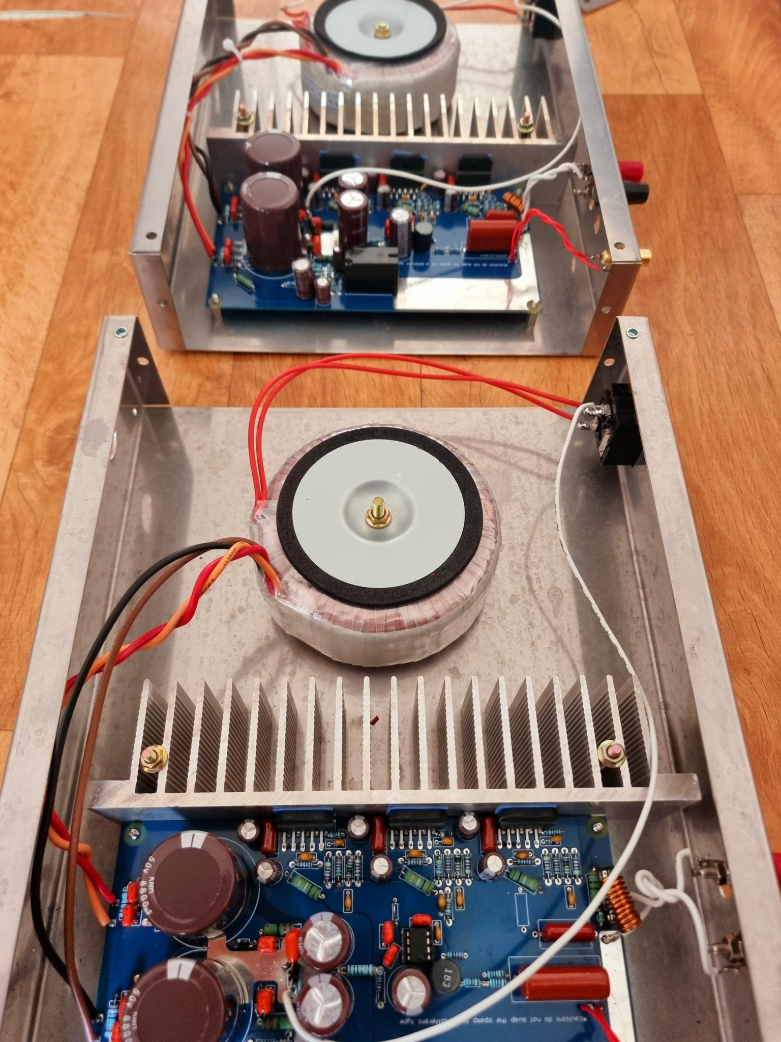

And here is my build. Kept to your schematic to the tee. Except for the czcrc filter (cap-zener-crc) for the opa551. Triple current pump. Mono mono chasiss
Sounds amazing. Completely hum free.
