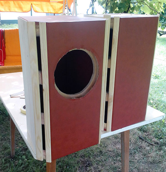

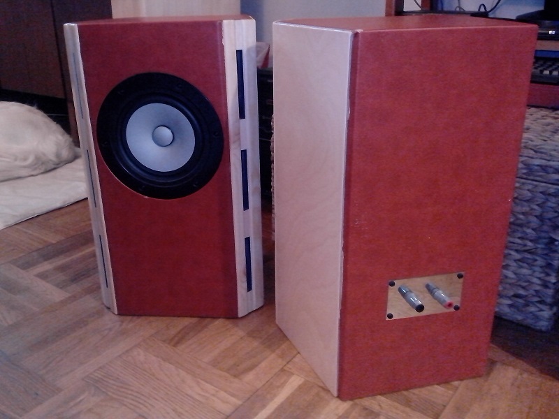

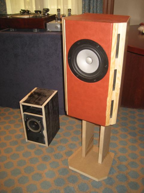

Here are some pictures of these speakers that I've built this sommer. I made them just for fun to put the drivers in durig the reparation of super pensils. The boxes for superpensils were made very sloppy and careless so I promised a friend to repair them. For mar-kens I used material I had around (chipboard, mainly), i didn't want to spend extra money just for experiment. Well, after some extensive listening, I'm sory I didn't use proper material, as I like them very much. I experimented with finish, just to cover the materials I used.
I'll try to attach the photos

Just about to attempt the mFoken with the FF85WK Drivers. This thread and the help I got with the driver selection has really inspired me , thanks Planet10 🙂
Dave is the block under the baffle vital could I take it out ? Would it inpact on the sound quailty ? I will joint the baffle into the side panels to make it strong
that's not just a brace, but also used to adjust the net CSA/Volume of slot port - by changing the width of that strip the tuning can be adjusted for a range of drivers
AH ! understood thanks Chris
I should have expanded to say that the high aspect ratio (skinny) port slots and variable size of the separators is a feature throughout most of the mini-Onken / Fonken / Mar-Ken family.
