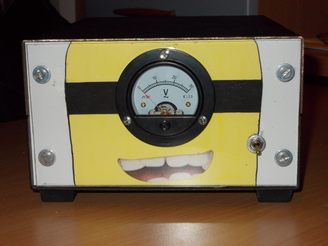

Minion Style Power Supply
It’s for my daughters’ room amplifier: I had to do it …
Ciao.
Luca
P.S.: here's the 2.0 release Minion Style Power Supply

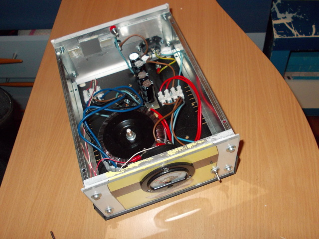

It's a simple 220 Vac / 21 Vcc converter, no USB charger, supplying a TK2050 based amp.
Just a transformer, bridge, 4 x 3300 uF capacitors and a Vmeter.
Ciao.
Luca
We now get to find out what it does.
The fuse should be before the insulated terminal block.
i.e. at the FIRST opportunity after the Mains Live enters the enclosure.
add insulation to all the bare mains Live and Neutral connections/joints/wires.
Add second layer of insulation to all the mains wiring.
Consider adding a layer of insulation to all other exposed conductive parts that are near any mains wire. This is to make it impossible for a loose/broken Live wire to touch any other metallic parts that could be a health risk to your child.
