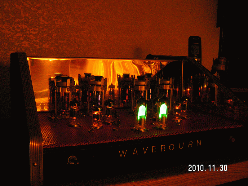

Once again: here is my answer for heat problems. Tubes as far as reasonable from each other; anodes turned such a way they minimally radiate on each other; mirrors behind the tubes; perforated chassis.
It's Pyramid-VII-M amp prototype, it will go soon to cobra2 in Norway, his friend I hope will be happy to use it, as soon as I finish testing and some cosmetics.
The mirror will make things worse, as each valve will see an image as well as the real thing, but you have the valves far enough apart that this should not be a problem.
If valves are close together better to make the back wall matt black so it absorbs heat, then gets rid of it by convection.
Absorbs heat and heats transformers? No, thank you! To absorb heat I am going to use heatsinks around 6С19П in another project, but you if I remember right you yourself said that it is bad as well. 😉
As I said, anodes oriented such a way they radiate minimally to each other and perpendicularly to mirrors, so rays are reflected under angles between tubes.

All dark😱.
Must be a power station trip due to excessive current at start up. If you use an inrush suppressor the lights don't dip.
Very nice!
Thank you!
I dimmed the light to take a picture of glowing toobs. No excessive current at startup; it has a wirewound resistor in series with primary and relay powered from filament rectifier that shorts the resistor as soon as voltages are up. Nice feature, highly recommend!
