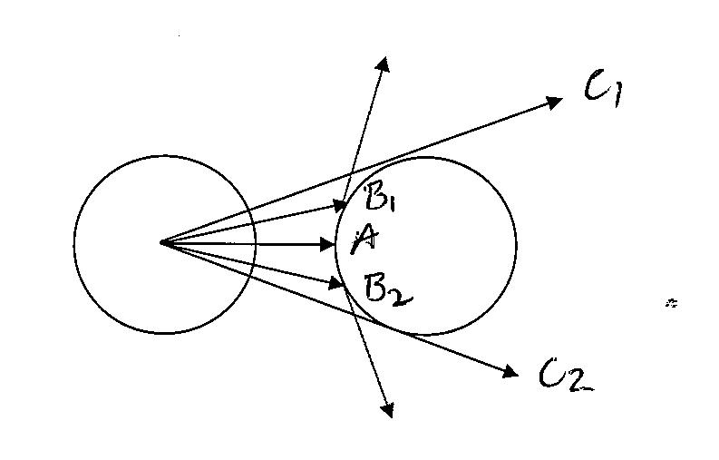

At visible light frequencis, glass reflects only a small proportion of the incident energy. Otherwise all our windows would look like mirrors! The proportion reflected rises for glancing angle incidence, which is why a valve looks more shiny on the edge. Most of the rest of the light is transmitted through.
At infra-red glass is not so transparent. A significant proportion is absorbed and heats the glass. This is why valve envelopes get hot. When two hot valves are next to each other, some of the heat radiation will heat the other envelope and some will go through and heat the other anode. Some of the extra heat in the envelope will then be radiated inwards, so indirectly heating the anode.
Can we estimate the effect of other valves being too close? We can surround a valve with 6 other valves, all touching to form a hexagon. Then the middle one has virtually no cooling. We could say that each extra valve reduces cooling by 1/6 =16.7%. We don't put them that close, but we can assume something like 5-10% reduction in cooling for each close valve i.e. we would need to reduce anode dissipation by 5-10% per near neighbour. A stereo amp would have 4 output valves in a line, so two of them have two neighbours: 10-20% reduction needed. The data sheet max dissipation would be for one valve under ideal conditions, and ideally we want to be a bit below that anyway to get good life (unless we are rich or foolish).

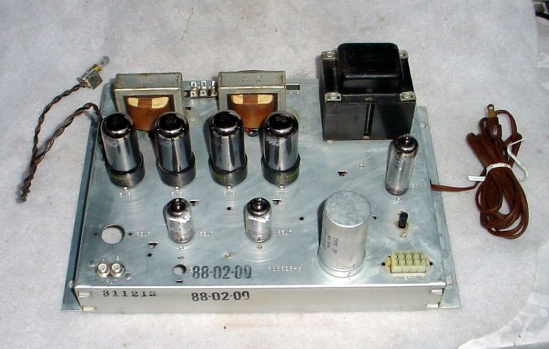

I went to a technical high school that had a 3 year long electronics program. Our "textbooks" were Army training manuals from the late 50's and Philco manuals from the same era. We were taught the "one diameter spacing" rule, and it seems to work OK for me. If you are going to push a tube to it's max, I would give it all the space you can. The 6V6GT works at 8 to 10 watts of dissipation. The spacing on the Magnavox amp shown looks adequate to me unless you are going to stuff in bigger transformers and crank things up.

The thread starter showed a pictures of an old Magnavox P-P amp. They were not known for running the tubes hard. The amp uses a aingle 6X4 rectifier. That's where I based my 8 to 10 watts from.
