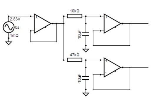

Minimum load resistance for NE5532
Data sheet says the attached.
So that 600R should be treated as lowest.
For low distortion, 2k and above would be recommended.

Its good down to about 500 ohms, there is a slight increase in distortion, but not normally anything to worry about. Some opamps have dramatically rising distortion for heavier loads than 2k, and 2k is the de-facto standard that most opamps will happily drive.
Being able to drive low impedances like 500R is very useful for low noise circuitry where you want to keep resistances low for lower Johnson noise.
