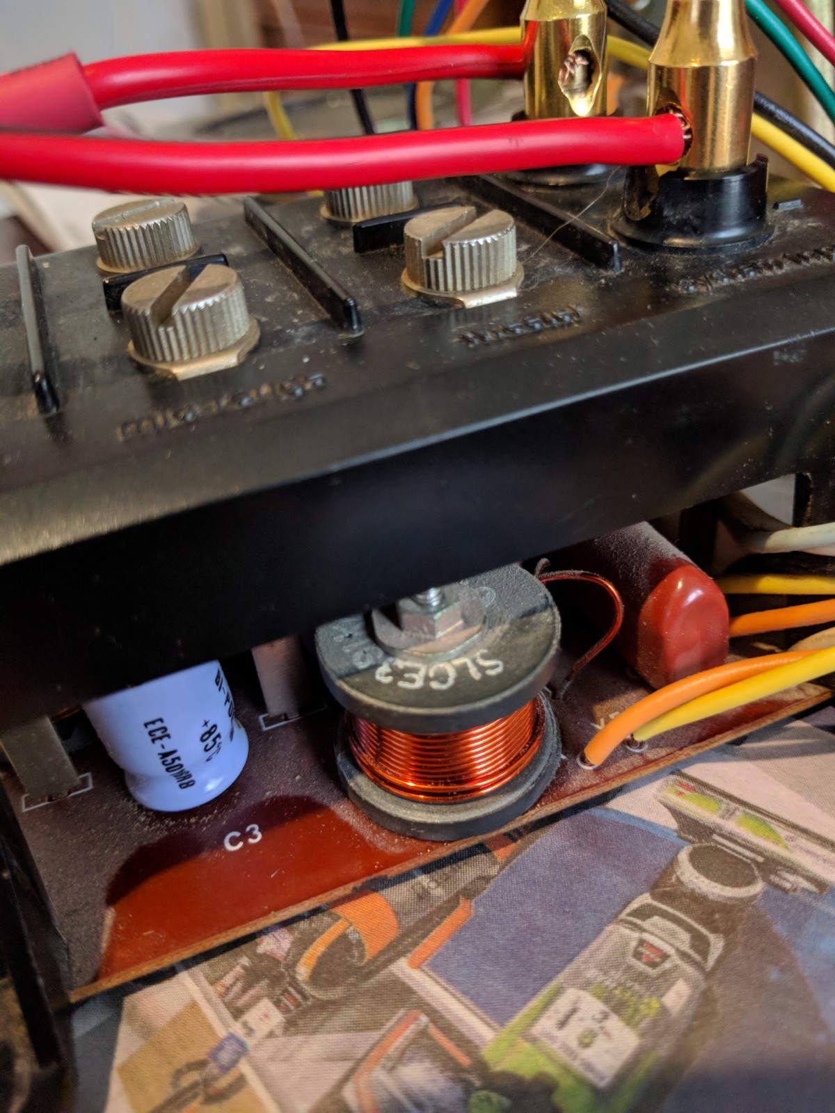

a. Select suitable Inductors which will improve the sound reproduction, be electrically suitable, but no break the bank.
b. Decide on a suitable crossover circuit board which would compliment these speakers.
c. Create a new wiring diagram with color coded wiring, which a non technical person to follow.
Cliff, allow me to expand on your requirements the way I see them. I have changed the order so that they flow better.
a. We can see one ferrite inductor, so know we should use a ferrite for the same function in your proposed external crossover. We would need to see the other inductors to choose electrically suitable partners for them. However, there can be no guarantee that our chosen inductors would improve the sound reproduction.
b. You would like the formal crossover schematic translated into a practical layout of components, so you can see clearly how to connect them all together to create your proposed external crossover.
c. You would like someone to colour code the wires that connect the external crossover to the input terminals and individual drivers, so you can make no mistakes in those connections.
If you agree with my take on your requirements, note that it is b. and c. that are the BIG ASK.
Is anyone up for the challenge? :cheerful:

The other Inductors were more difficult to photograph, but when I visually inspected them, apart from differing sizes, they all had that bobbin exterior and the screw shaft down their centre with a fastening nut at the top.
I'd say they're all iron core.
I know that high value iron core Inductors are smaller than Air core Inductors of the same value and more practical for this reason.
Aren't air core inductors superior to use than iron core, especially where higher sound frequencies are handled?
Also aren't iron core inductors often selected by manufacturers over air core in order to keep costs down?

Inductors are not polarity conscious ( there is not so many passive parts which are - except regular electrolytics capacitors and diodes- and if they are manufacturers will tell it explicitely).
To understand the existing filter circuit you'll absolutely need to take into account the driver behavior into the equation ( electrically and acousticaly). As already stated in loudspeaker's passive filters everything interact. This is at electrical level but once you have multiple drivers there is interactions too at acoustical level ( their location on the system, their shape and type, the box shape,... everything interact more or less) and this can lead to destructive or additive behavior frequency wise, weird behavior about the directivity, etc,etc...
This will require some gear to acquire electrical and acoustical properties then modeling through a software like Xsim, then to fine tune the results afterward with the real thing in place.
There is no wire colour code convention ( except the red:+, black:-, but in case of multiple drivers there is none) but you could either make your own and have it stated somewhere user can read it ( however this won't garantee you to meet a punk which make a point to not follow rules whatever they are and their outcome 🙂 ) or use a kind of connector which is multi point like the ones used in proworld ( something like Edac). That said you'll need to ckeck they will withstand the condition without start a fire ( amperage and voltage).
