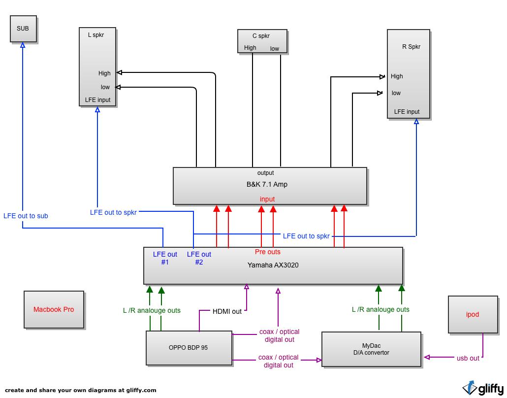

Extra simple idiots guide to mini DSP integration ??
Hello.. Maybe I need the idiots guide to miniDSP integration because for some reason I can not wrap my head around how to integrate the mini DSP in my home theatre / audio setup. I can't even figure out the best unit to use. I have read the entire miniDSP manual and then the entire REW manual referred to by the miniDSP, which only made my confusion worse as the REW manual doesn't even mention the DSP anywhere in the manual !!
My main goal is to balance out the frequency response of the main speakers and possibly the center. I have tried using the program built into the yamaha as well as the denon before it but it ends up sounding like someone threw a wet blanket over the sound. Kind of like it is forcing everything down to the least common denominator.
I would greatly appreciate it if you could tell me:
1. The best unit to use for my application
2. what other equipment I will need. mic, plug in, 3rd party like REW ?
3. Where in line to hook it up.
Thank you for your input
Here is a diagram of my equipment layout
