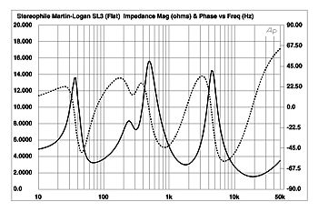

Here's the phase and Z response (1998 Stereophile review) for my passive xo ESL hybrid ML SL3. (Can you see the wiggles caused by the ~250Hz xo and ESL EQ?) If I used miniDSP to recreate (and improve!) the XO and the EQ for the ESL, I would like to flatten the overall phase response. Is this something that miniDSP can do now, or is it functionality that I can expect in the near future?
In order to flatten the phase response (or to reach a constant group delay) you need to adress the phase independent from the amplitude. This is not possible using IIR Filters like the miniDSP does. FIR Filters could do this, however the DSP used on this platform does not have enough calculation power to perform FIR filtering. Disadvantage of linear phase speaker systems is a significant overall group delay (e.g. 70 - 100 ms in case of linear phase down to low frequencies). Doesn't matter when only listening to music, but for home theatre systems this might be a problem.
The phase you are looking at is the impedance phase. Replacing the passive crossover with an active one will remove impedance phase variation associated withthe passive crossoevr/equalization but it will not affect the impedance phase of the woofer or panel. This is not something that can be addressed with DSP. The low frequency impedance peak is that of the woofer resoance and at least one of the higher frequency peaks is that associated with the impedance peak resulting from the LC resoance of the ELS panel and its matching transformer. Also, if you remove the passive crossover make sure you measure the impedance of the panel. Most ELS panels have very low impedance at high frequency. This is the case with my Monolith panels, and if that is the case with your panels you should make sure you have a resistor of 1 or 2 ohms in series with the primary side of the matching transformer. Otherwise you may find you amp reacting badly to direct connection to the panel.

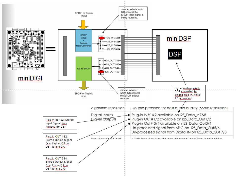

Sorry for my ignorance, but just so I'm clear on what you mean. The digital signal comes into the Digi, gets sent to the DSP, is broken up & then the high frequencies can be sent back to the output of the digi?
Hoping the attached diagram brings some light into your brain ;-)
miniDSP and miniDIGI are stacked and connected through ribbon cables. Jumpers and plugin configure the signal routing.

The internal DACs of the DSP (Analog Devices ADAU1701) are used on the miniDSP 2x4. Specs are quite OK though not comparable to high end DAC Systems.
I would try the build in DAC and optimize the rest of the system (room!, speaker EQ,...) first. In combination with miniDIGI it is quite easy to add external DAC later (each miniDIGI has one SPDIF output).
