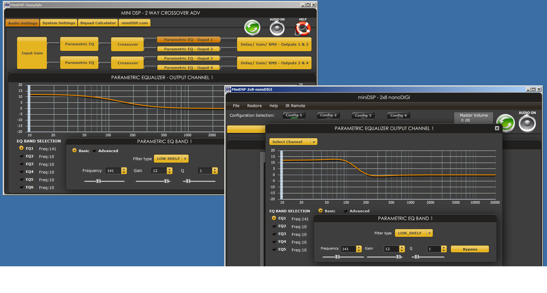

Steve,
You can tell by inspection of the plug-in screen if programming a simple filter.
Here's an example where I selected a simple 12db shelving filter with 141Hz center frequency and Q=1 in both my 2-way Advanced plug-in and my 2x8 nanoDIGI plugin. (Note the difference.)
The 2-way advanced plugin is correct and would yield the proper first-order shelving action. However, the nanoDIGI plugin would need to be modified by reducing Q to 0.5 to achieve the equivalent result.
Actually, since these plugins both default to 0.5 it's the 2-way advanced plugin that needs to be modified and not the nanoDIGI plugin. Obviously I don't have all the miniDSP plugin's so you need to check the particular version you have.
Hope that helps.
Dave.
