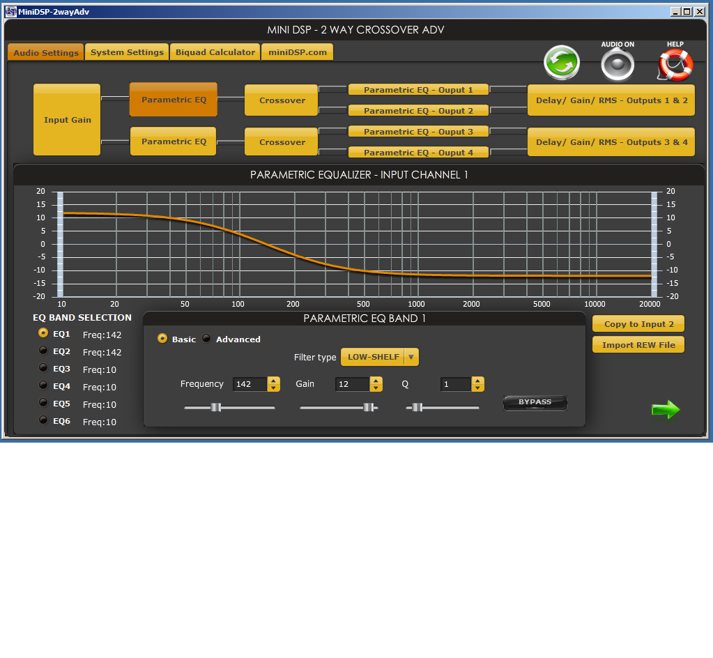

John/Rich,
To create a standard, first-order shelving filter (with gain greater than 16db) you would indeed use two filters, but the settings should be at the same frequency. If you separate the filter center frequencies (and leave the Q setting at 1) you no longer have a textbook 6db/octave shelving filter.
With some of the digital boxes (like the DCX2496) you are required to separate the programmed frequency of each filter to create the proper cascaded filter function, but not so the miniDSP since it uses "center" frequencies for the shelving settings.
Anyways, your example of 35Hz-757Hz yields a gain of 24db at center of 142hz. So, to program into a miniDSP you have three options. (All three have exactly the same curve, just offset in gain for utilizing different gain structure.)
F = 142Hz, Gain = 12, Q = 1, Low-shelf,
Or
F = 142Hz, Gain = -12, Q = 1, High-shelf,
Or
Attached is a photo of the middle example:
Dave.

That is incorrect, Dave. This figure compares a 1st order shelf with Fc = 142, +24dB with two shelves cascaded, each with Fc = 142, +12dB.
The difference is clear. A 1st order shelf has one pole and one zero in the transfer function. Cascading two identical shelved with 1/2 the gain and the same Fc yields a transfer function with two poles and two zeros. What I posted previously is correct.
When the center frequencies are staggered as I specified, at 70 and 285Hz the result is as below, perfect match.
The gain of a 1st order shelf is F0/Fp= 575/35 = 16..42 > 24dB.
What you have is a 2nd order shelf with gain = (Fo/Fp)^2 = (285/70)^2 = 16.57 > 24dB. (ignoring round off errors)
Yep, sorry I forgot about the known "Q-issue" with the miniDSP.
You do need to alter the Q setting (on some) of the miniDSP plug-ins to achieve the textbook first-order shelf if using filters with the same frequencies.
So, for this 35-575 example set both filters to 142Hz, and 12db, and change Q from 1 to 0.8. It looks good then.
MiniDSP has adjusted/corrected the Q "problem" with some of the other/newer plug-ins, so a person needs to be aware of which plugin (and kit) is being used and check accordingly. 🙂 Sorry for the possible confusion.
Dave.
Dave.
It is not a Q issue. It is not possible to cascade two 1st order shelves with the same gain and center frequency and have the same response as a single 1st order shelf. There cascaded pair will have two zeros and two poles. The net transfer function will be 2nd order have s^2 in both the numerator and denominator where as the 1st order shelf only has s^1.
It doesn't help that the default Q setting for miniDSP shelving filters is "0.5".....which doesn't correspond to a first-order shelving filter if you were to program it without changing that parameter.
Dave.
This also depends on what version you have. I have a version of the 2way advance and the 4way advanced that require Q = 1 for a "correct" 1st order shelf. I have a newer version of the 2way advanced that requires Q = 0.5. And my 2x8 plug-in requires Q = 0.5.
For this reason, and the Q peak/notch this, I always input biquad coefficients for any EQ and then check by measuring the results and comparing them to known behavior.
I guess if I had one complaint about miniDSP it would be their deviation form the standard analog definitions of Q. Point in fact, a true, analog, 1st order shelf doesn't have a Q.

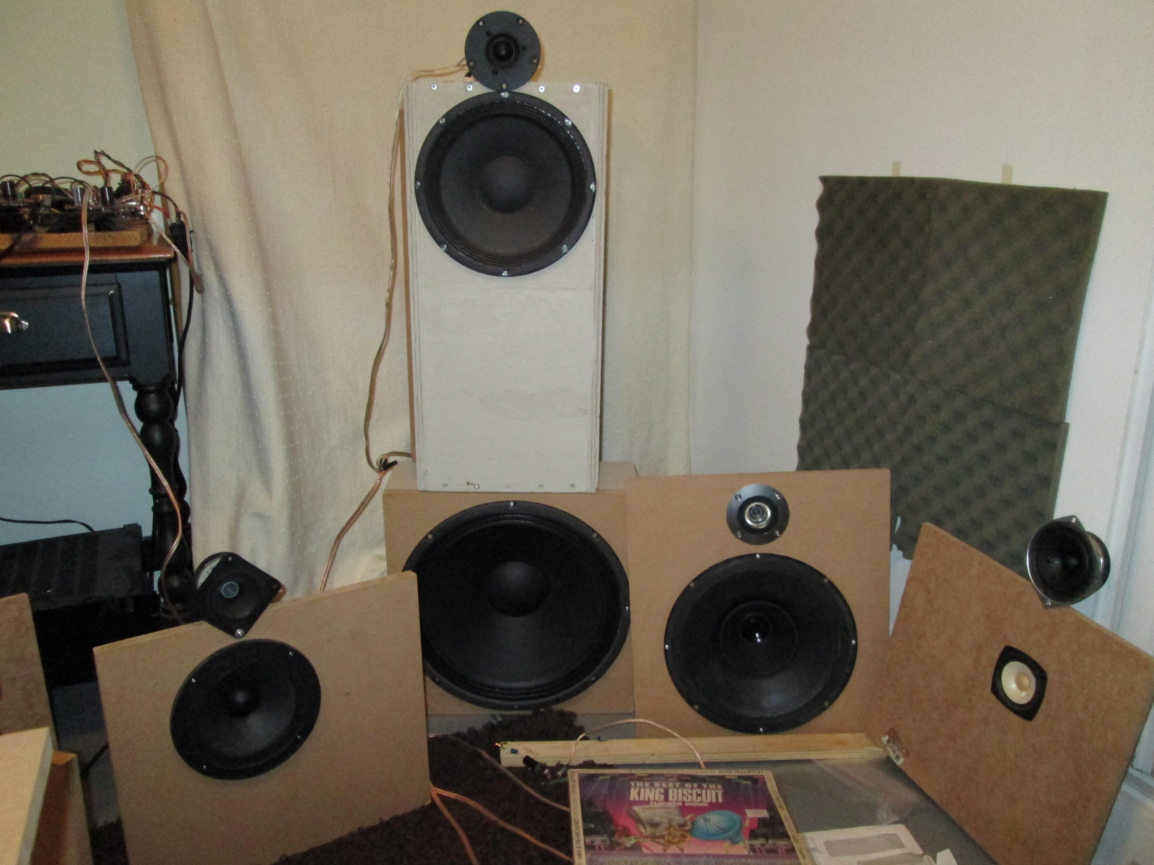

- MiniDSP H-Frame.
