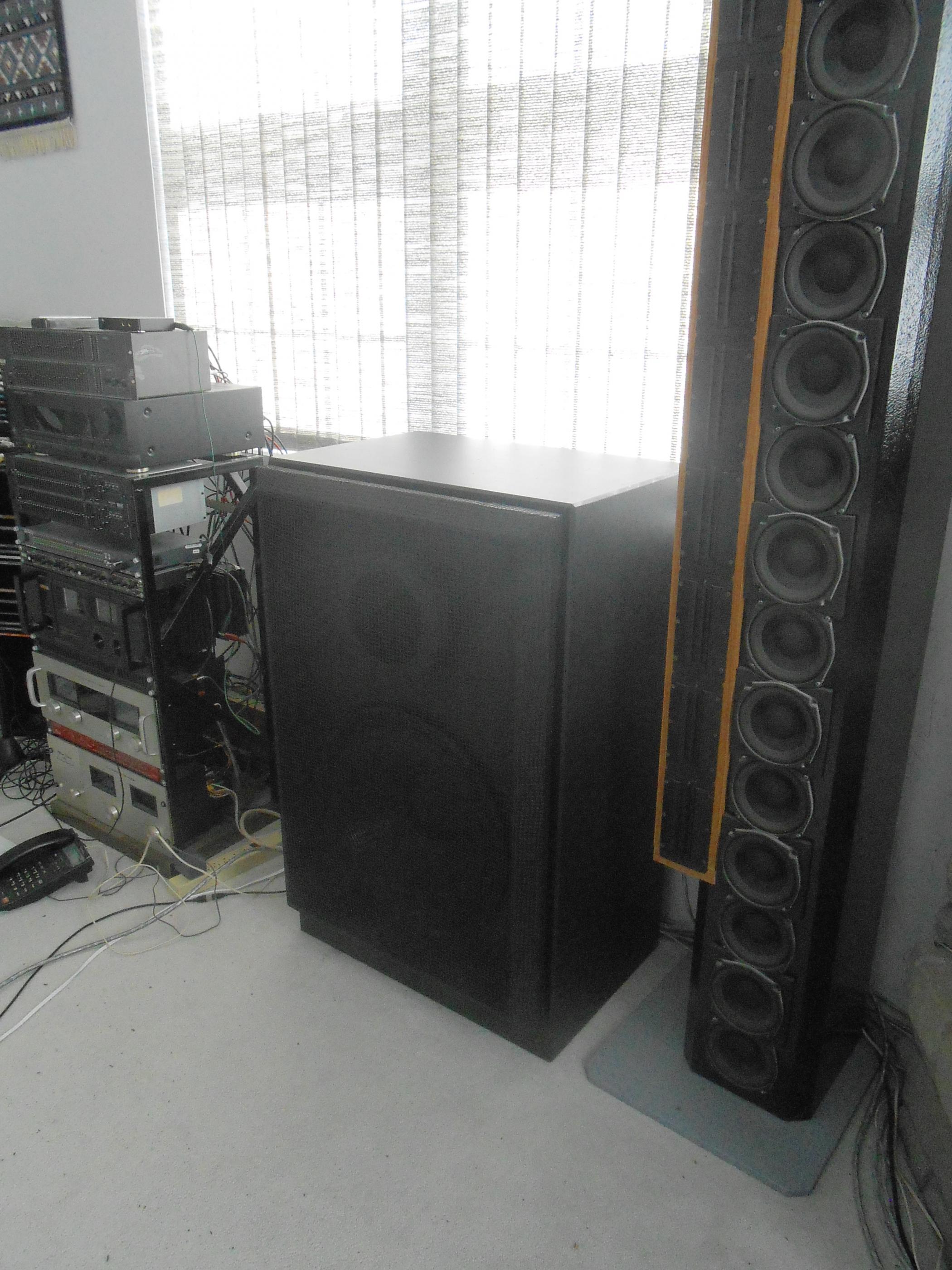

Hi Guys;
I will leave this thread as fast as I have entered, so pardon me for Intruding. I am in way over my head. I wound up here as a result of a search for a steep roll off (greater than 24 db/octave) crossover.
I stumbled upon the miniDSP 4x10 HD, thinking this may be the ultimate answer for my very large 3 way, 2 channel system.
I am not up to constructing something from scratch. This unit seems to be able to take a digital signal from a CD or DVD player, (and laptop source?) eliminate my equalizer and crossover units.
I have not found detailed specs regarding this unit, but I sense that it is not warmly received by all here. I did see that it could somehow use REW to equalize and otherwise adjust the system.
Pardon my ignorance in this area, but if this is not the ideal unit, could you point me in the right direction,
Thanks Peter

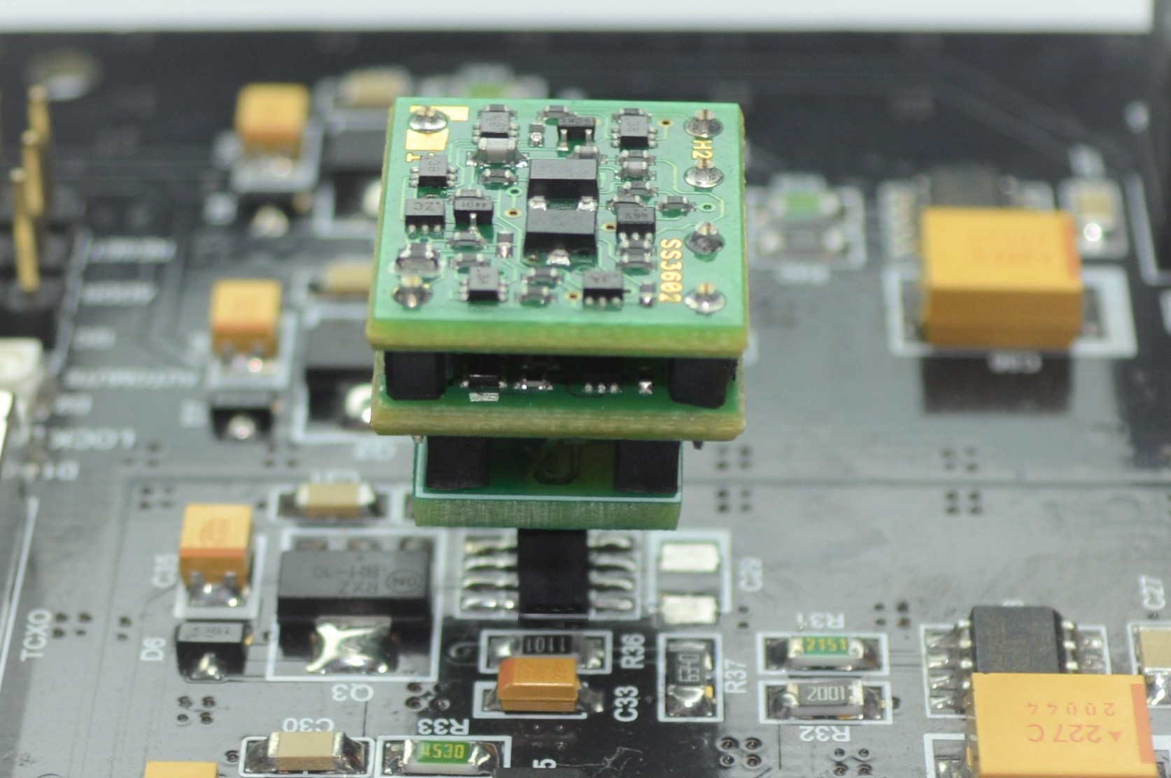

'Tis but a mere speed bump to the determined opamp roller.
I guess some have way more time and patience than I do... 🙂 Oh, well. Each to their own.
First time i plan to use adaptor to dip8
But if i not use adaptor which opamp you recommed to upgrade this minidsp
The opamps in the MiniDSP 4x10HD does not use a common footprint. The DMP8 footprint does not fit anything else that I'm aware of. If I was to replace those opamps, I'd probably go for an OPA1612.
Tom
Tom
Dear Tom Minidsp OPamp not come with DMP8 https://www.njr.com/semicon/PDF/package/DMP8_E.pdf
it come with (SSOP8) https://www.njr.com/semicon/PDF/package/SSOP8_E.pdf
SSOP8 smaller than DMP8
Dmp8 it close with soic8.
You know... That's probably true. I do recall the pins being closer than the 1.27 mm of the DMP8. 0.65 mm sounds about right. I think that's the same as TSSOP, though I recall the package used in the 4x10HD being wider than TSSOP.
Maybe you can find an opamp in a TSSOP package and make it work.
Tom
