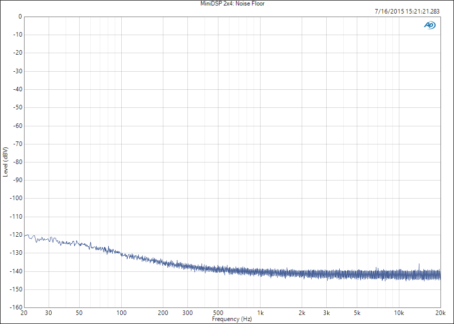

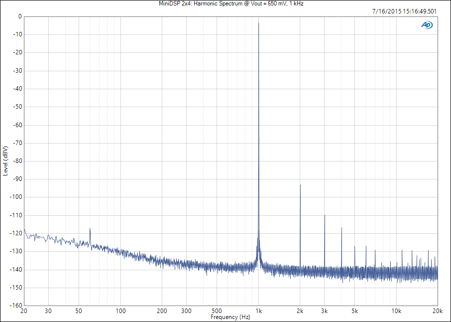

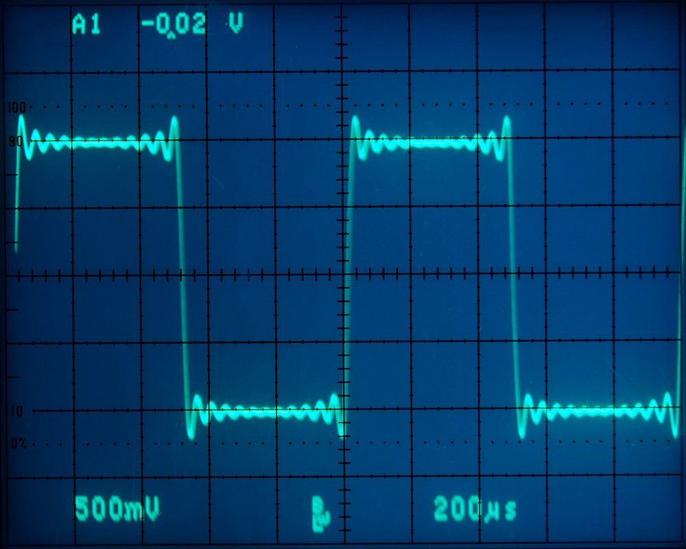

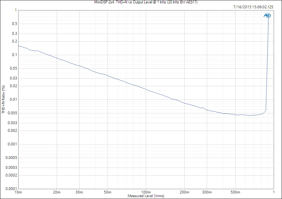

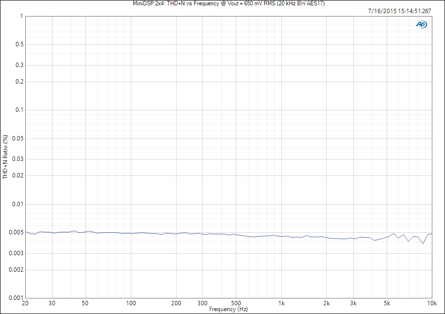

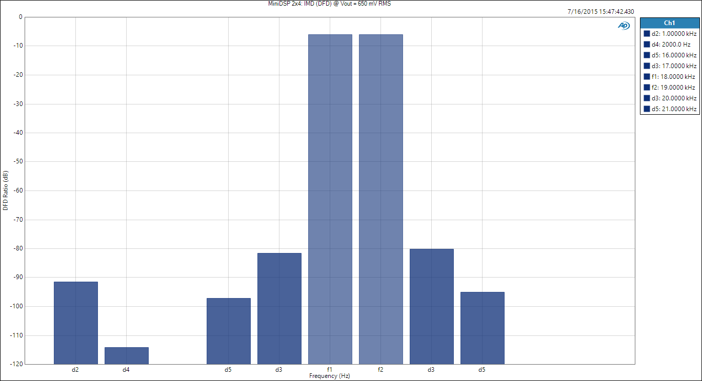

MiniDSP 2x4 Measurements
As requested, the MiniDSP 2x4 measurements.
Please note that these measurements were intended as a quick look at the performance of the single-ended version of the 2x4 and not an in-depth characterization. Thus this set of measurements should not be considered complete, rather a quick glance at the performance. I also no longer have access to this 2x4, so I can't go back and take more measurements.
I may get my paws on a 2x4 differential version in the future and will post a full set of measurements of it if that materializes.

MiniDSP 2x4_ Harmonic Spectrum @ Vout = 650 mV, 1 kHz.png45.3 KB · Views: 587
MiniDSP 2x4_ THD+N vs Frequency @ Vout = 650 mV RMS (20 kHz BW AES17).png37.6 KB · Views: 570
MiniDSP 2x4_ THD+N vs Output Level @ 1 kHz (20 kHz BW AES17).png34.3 KB · Views: 567
Does the board show a pair of lowpass caps on the inlet diff amp? If so, it's more likely their tolerance than layout symmetry.The CMRR is less than stellar. That's to be expected from a discrete solution, though, it looks like the layout could use some tightening up to prevent the degradation above 1 kHz.
The -54dB floor below 100Hz suggests 0.1% matching. If MiniDSP gets that by design rather than good luck coming off the reel IMO that'd be notable.
They appear to be using LC (!) filters on the inputs. The CMRR at higher frequencies could be dominated by the tolerance of the inductors.
I don't know whether they use 0.1 % or 1 % tolerance resistors. -54 dB CMRR would imply 0.2 % matching.
In the old days, resistors were binned which meant you were more likely to get resistors that were closer to the tolerance limits than to the centre of the distribution. I don't know if that's still the case or if the manufacturers have improved the process enough that they can rely on spot testing or skip testing altogether.
Tom
Tom
That'd do it too. What dominates just depends on the LCR values and tolerances chosen; in a well designed circuit caps tend to be the limiting factor but it depends on cost headroom in the BOM and how much the designer optimized.
Since diff amp CMRR is a function of relative pair ratios in a resistor quad there's an extra factor of two. The terminology's not standardized and even in matched quad datasheets it's often unclear exactly what one's getting; I've seen both definitions here in use in the industry. Whether there's a 0.1% take out and its extent would depend on the manufacturers, R values selected, and how the fab lines are operated. In general I would tend to guess probably not so much due to differences in temperature ranges, TCRs, and thermal ratings. It's plausible for certain Susumu selections and straightforward within Yaego's RT series. 0.5% is increasingly popular and doesn't necessarily cost more than 1% so that's a possibility to consider as well.
