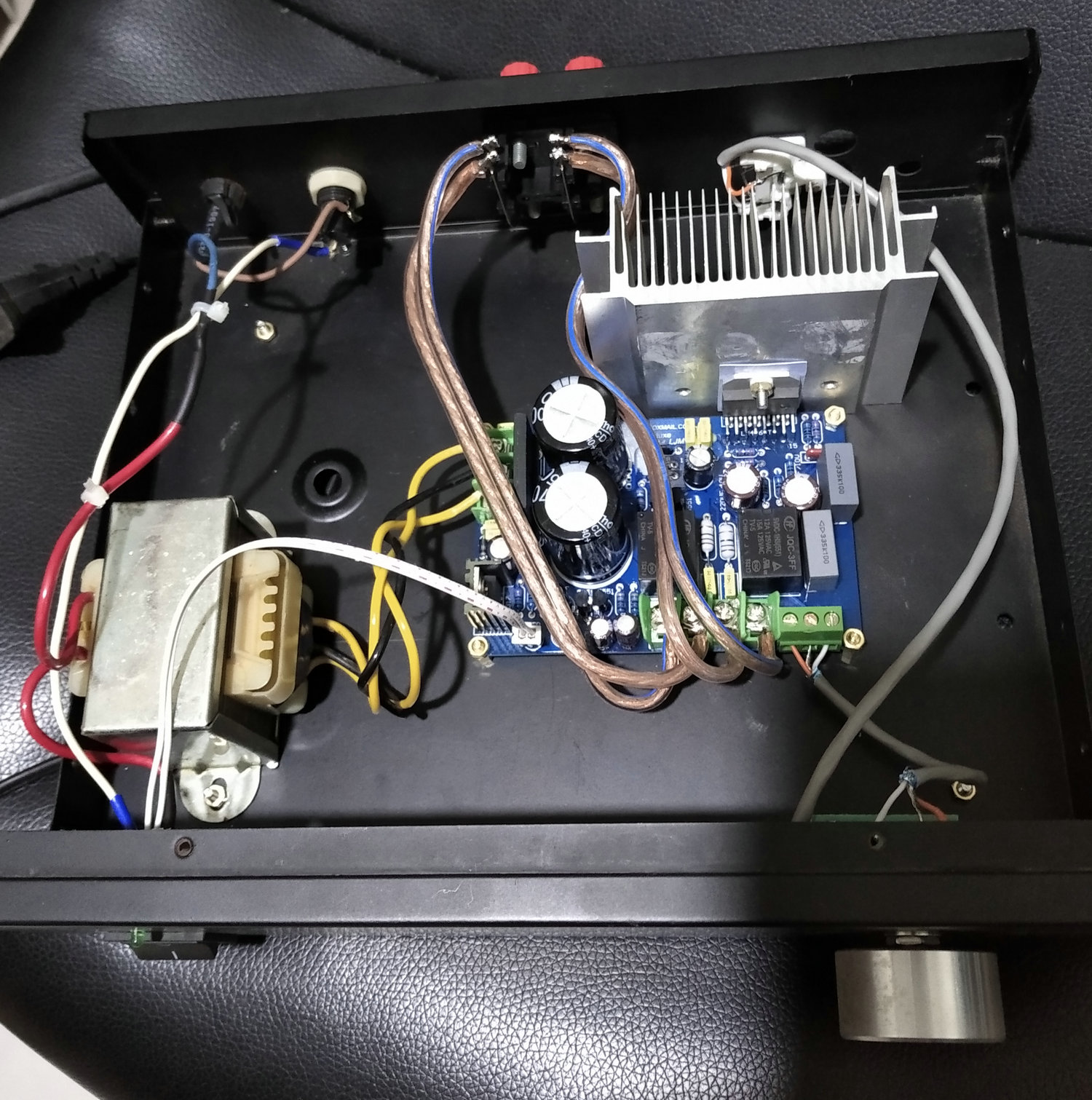

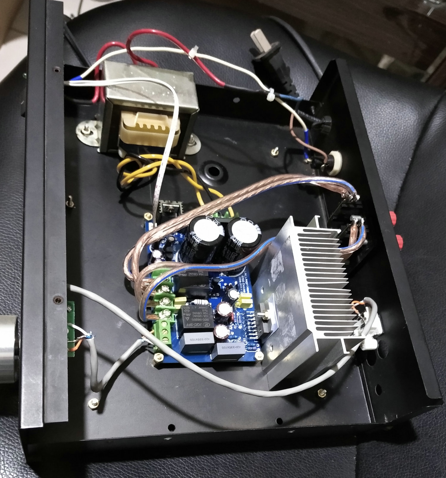

I recently installed one. Probably the cheapest machine I've ever installed.
LM4766
I found a computer speaker that nobody wanted. There is a transformer inside.
AC 18-0-18。 Then I found a previously abandoned chassis.
The total cost will not exceed $12.
LM4766
