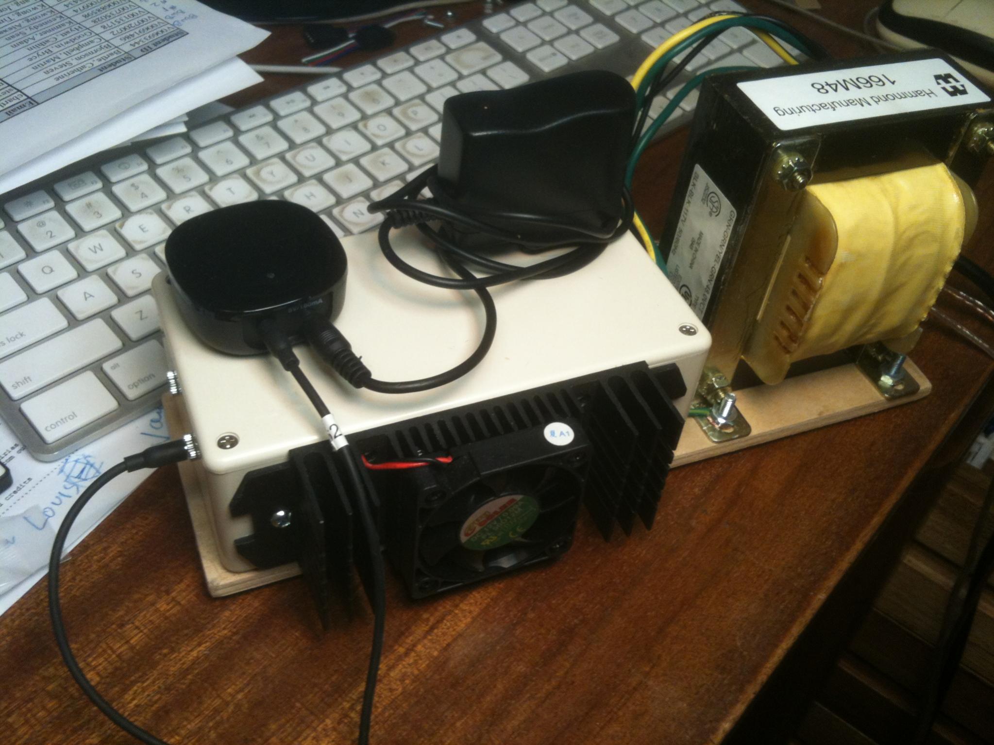

Thanks Andrew. Not a very good picture. The plastic casing is cut away so that the whole PCB and chip are flush to the outside surface. The chip is tight to the heatsink with thermally conductive double sided insulating tape designed for this purpose from the electronic store.

Success
The transformer arrived 48V CT or 24-0-24 Big unit. Works perfectly.
I just played 1812 cranked all the way with good clear sound and very little heat detectable from the pentium heatsink with fan. I powered the 12v DC fan from one side of the transformer with a single diode. works fine. seems to see about 10vdc.
Anyway the picture shows final unit with the monster transformer, the heatsink and fan and the bluetooth receiver and power supply.
Thanks for you help
