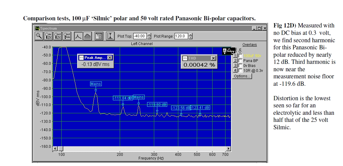

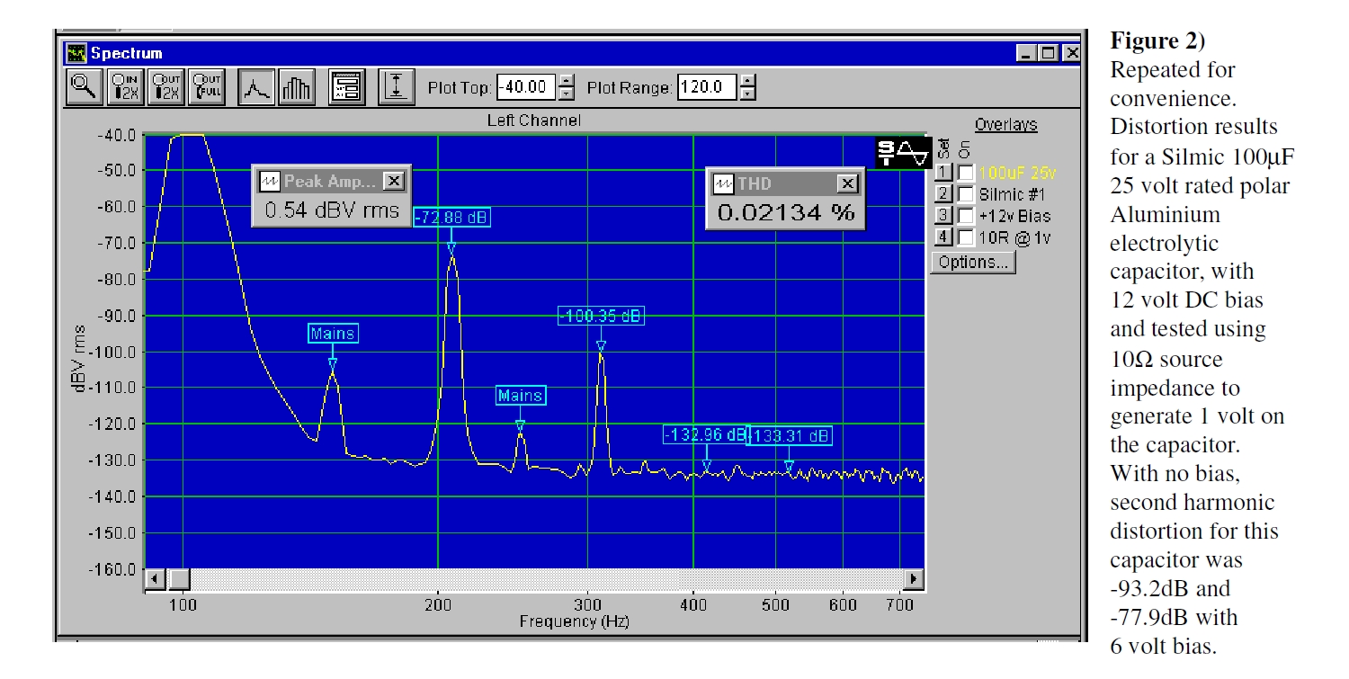

I wonder how much voltage rating matters when one follows this generous capacitance formula. I ask this only because according to Bateman's many measurements, higher voltage rating always lowers distortion (specifically H2 harmonic, thus decreasing H2/H3 ratio) considerably. But this is probably based on situations when the capacitance values are more typical--say (under?)scaled to create a 2Hz corner frequency rather than accomodate this current-carrying requirement.

IMHO you should consider using a bipolar cap. You are passing an AC signal thru it and from Batman's work it was quite plain that a bipolar cap has quite a bit less distortion that polar electrolytic for this use.
Also, he found that the higher the voltage rating, especially with a DC bias, the lower the distortion.
Greg
