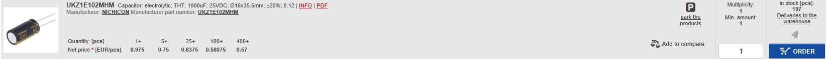

If you are interested to try the "perfectly linear electrolytic capacitor" rule of thumb found in Douglas Self's book Small Signal Audio Design (2nd edition), Figure 2.21,
then I recommend you extract the required "AC current delivered into headphones" from the handy table in this web page. When I quickly scan the table, I observe that AC current delivered into headphones is 50mA or less, for about 95% of the headphones listed.
Armed with the necessary numerical values, we simply plug and chug in Self's rule of thumb. AC voltage = 0.08 , AC current = 0.05, frequency = 62 radians/second. And presto, out pops the answer: C >= ten millifarads. (ten thousand microfarads).
Here's a capacitor that sells for $1.44, qty=1, and meets these requirements: link . Remember that Self's data says ANY electrolytic capacitor, from ANY manufacturer, will be perfectly linear when delivering 50mA to a load* ... as long as that electrolytic capacitor is 10,000 microfarads or greater. Even the $1.44 capacitor shown here.
*at frequencies of 62 rad/sec and higher
