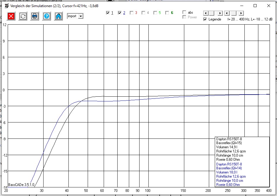

both of my simulations cross the zero just once
Close, but that is not what the sim says. Their is a white closed space in between the red line and the back line. That represents a double crossing of zero.
The actual (real live) driver response will cancel that claim. And the modification of just +2Hz (!!!!!) fb will defeat it completely! It does not even alter that curve to 0.1dB!
