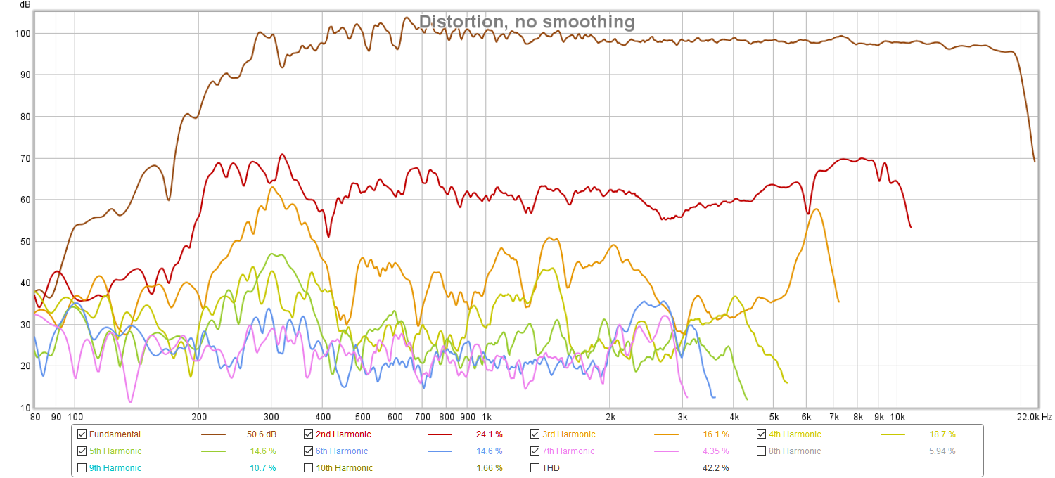

Pulled the mids - noticed my t-nuts were just a touch over flush with the driver mounting plate still. Changed to some new mids as well. I don't like making multiple changes like that but it's a pain taking the wg off it's mount to pull the drivers off. No change in the distortion. I have some small foam plugs cut that fit the mid ports which helps a tiny bit with hf diffraction off the ports. Pulled those out and things are much better. One (or more!) of the plugs must have been out of whack and touched the cone. The distortion still isn't on par with the 1 port/driver version but much better. I'll bring my precision square home from work this week and see how flat my mounting plates are.

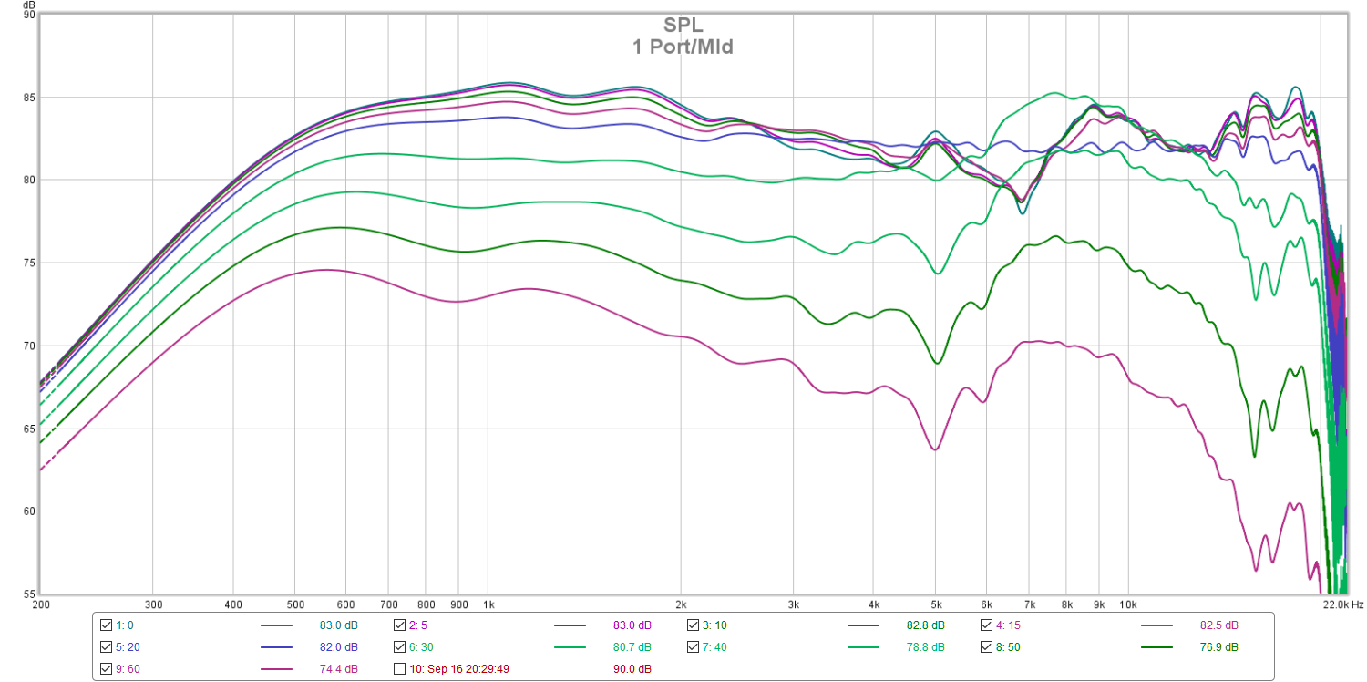

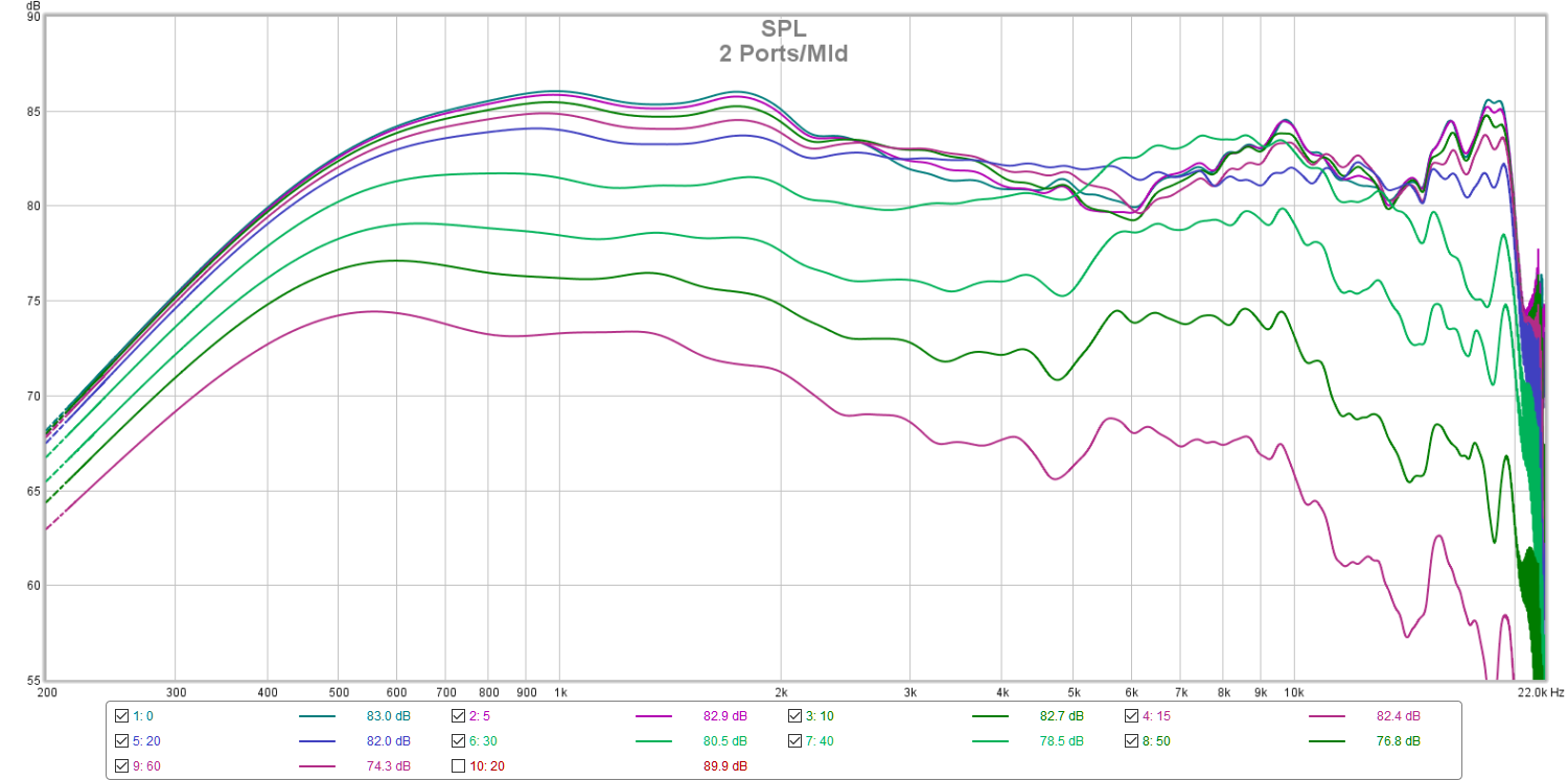

Here's the polars for the 1 mid port/driver and 2 ports/mid driver. This is a BMS 4552nd and two Celestion TF0401MR mids. The main thing I'm looking for is hf diffraction from the mid ports, and I wanted to see the effect of 1 vs 2 ports. When I originally did the testing in this thread my mid ports were too small. I didn't see anything in the data to suggest that but HornResp sims and work others have done convinced me of that....and I wanted to try to get the mids to play higher.
You'll also notice that I'm only using 2 mids per horn rather than the 3 I tested. When I set out to build these I intended to use 3, but two are much easier to get onto the horn and will offer plenty of output. These are eq'd to about +/- .5dB at 20° with a bit of down tilt. I'd say having 2 smaller ports per driver is much better in terms of hf diffraction, and I'll go ahead and redo the ports on the 1 port/mid horn to match the 2 port horn.
In the end these "mini Synergy's" will sit over a couple of sealed TD15M woofers to be configured horizontally or vertically - whatever gives the best in room response. XO to the woofers will be around 300hz.

Kind of weird how the treble peaks up there above 5kHz off-axis. Are you sure the Celestion output isn't getting into the combined response up there, or is that just from diffraction? Seems pretty severe.
On my newest waveguide, I was surprised to see very little effect from the midrange holes, but quite a bit from woofer holes that were further out (better now that I moved them further). That's with a 90x65 essentially conical (with OS throat) waveguide.

What's weirdest is how at ~7kHz and 30degrees off-axis it gets about 7dB stronger (relative to 2kHz) than it was when directly on-axis. And about 3dB stronger, without comparsion to other frequencies, at 7kHz than on-axis. Can't see how that happens!
Where are the holes relative to the axes? Isn't that a round horn? Then rotate it and place the anomaly where it does the least harm - up in the air or down on the floor rather than off on the side

I want to point out that I'm not intending to use them this way, I chose 20° because that is typically my design axis due to the way I toe my speakers....old habit. I eq'd as flat as possible so the different port versions could be compared equally. In practice I find that eq'ing these waveguides based on an avg of measurements out to 40° and a few vertically to work the best. Pretty sure I have the OmniMic sw Bill I will check it out.
nc535 - the wg is elliptical - 90x60 with an 18" wide mouth. I think more details on the wg are in the first post of this thread. The pics from post #412 show the 2 different port configurations. Port locations were in fact chosen where I thought they would do the least harm.

In (a grand total of) one test, I tried moving ports into corners vs moving them further out where they'd be clustered closer to each other and found that the closest distance to each other worked best. But that might've just been that one horn. I do know that having the ports too far from each other can cause bad pattern problems, but that's more in the midrange. This effect seems to be about 7kHz, quarter wave about 2", half wave about 4", if that's relevant to the issue. It's still really odd how extra off-axis energy seems to get generated, or is it that there's somehow a suckout near on-axis at 7kHz?
I think that's what it is. I thought it seemed that the un-eq'd axial curve was a bit weak in that region compared to what I'm used to seeing with this wg without the mid ports. Unfortunately I didn't save the raw response. Next time I'm setup for measurements I'll compare to my older data.
One thing I might try is to use two smaller ports on one mid and a larger port on the other in an attempt to randomize the effect of the ports.
Geddes' round waveguides have a suckout directly on-axis, which he explains by reflection from the mouth. It seems that the more symmetric the waveguide is, the more geometric effects will affect what happens on-axis (because all the effects reinforce each other when seen from there). Maybe your randomizing might be the way to go. The ellipse would be closer to a circular horn than something with a less regular mouth.

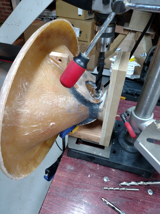

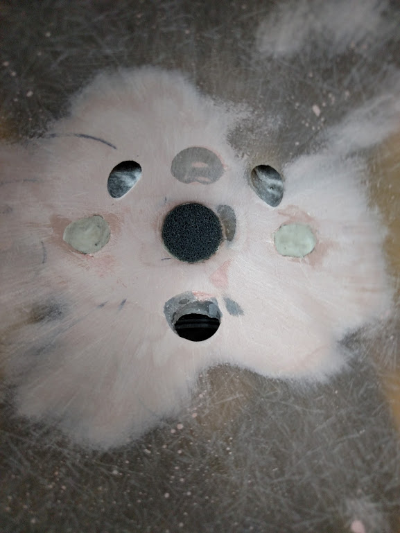

Back at work. Got the old ports filled and new ones drilled. The top mid has two roughly .5" ports and the bottom has single .75" or so dia port. I forget the drill sizes but I tried to make the area of the two ports = to the area of the single port.
I got smart this time and made a drilling fixture that mounts to the cd mount holes, so the ports are drilled at an angle to the horn wall. A 5/16 flat end mill made starting the holes on angle a breeze and I finished with the correct drill size. The ports are much cleaner and consistent doing it this way. In the pic you can see plumbers putty covering holes left and right of the cd entrance. I'm now screwing the compression driver onto the wg through the inside of the wg itself. This had to be done due to the way the mids mount and it's much easier getting the cd lined up with the wg entrance this way.
