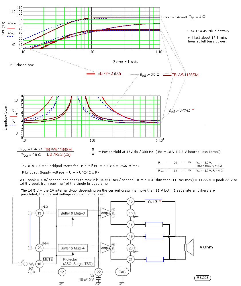

Not in my opinion if the prerequisites are followed: A box max 7-8" cube i.e. about 5 L and the use of the given 4-channel BTL Car Radio IC.
Actually, for this case the ED driver would be wasted. See the picture: 1(1)

Wow 😱
Excellent job on the document, graphs, and cutouts from the PDF for the amp chip!
I'd hate to waste such a nice high-powered 6.5 woofer on such low power. Also the smaller 5 inch woofer makes more room inside the box for electronics because it doesn't have a huge magnet.

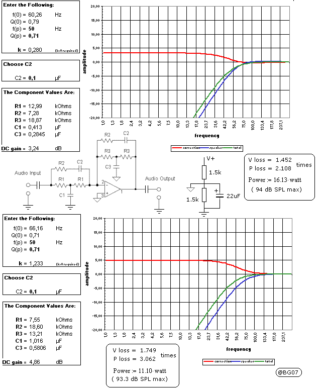

If that 5 inch sub is 40W, it's probably sufficient to not burn the coil in case its driven into hard clipping. For the highs, I'm blocking the bass to prevent blown speakers. I'm also hoping that bi-amping highs and lows like this will make it sound louder and clearer without bass distoring the smaller speakers.

Agree, and for close range listening you might also consider LT for slightly more extension on the lower FR end as well. See picture 1(2)
