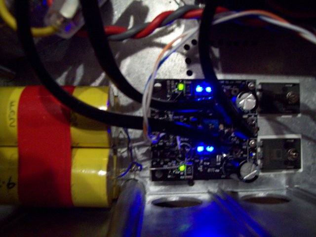

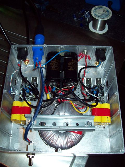

Made a few changes:
Replaced on board PSU caps with 100uF 100V Rubycon ZLH
Bypassed 22uF ceramic coupling cap
Replaced 47uF electrolytic feedback cap with 4x22uF fostex branded film caps
Drilled lots of ventilation holes in the base and sides of the case (it was sealed before)
Changes? Now you can see the modules yellow and blue LEDs glowing through the holes in the case. Sounds a bit different too 🙂
Possibly a touch leaner but upper mid and HF clarity far improved. Generally sounds a bit cleaner and more sophisticated, if that makes any sense.

Very nice build Sharpi31 - looks great.
Except - you're going to need some heat sinks on that case. They're not class-d you know 😀

Good build! Those yellow caps are the Fostex 22uF caps, I take it! That's a fairly major mod. Did you do bypass the ceramic input caps first & then listen or dive straight in with both mods i.e is the bypass responsible for the extra clarity at HF? What does the feedback mod do for the sound?

I bypassed the coupling caps first - this cleaned up the HF and seemed to remove a degree of harshness (not that the amp was noticeably harsh beforehand).
Next I replaced the PSU and feedback caps (the big yellow caps replace the electrolytic feedback cap on the board). This increased smoothness while opening up the mids a bit.
To be honest the amp sounded good from the start. The mods improved the performance - more than subtley but not dramatically. Definitely worthwhile though.
I'm waiting for some of the new 22uF Wima MKS 2-XL caps to arrive. These are really small low voltage film caps that would have been far easier to fit in place of the electrolytic feedback cap. I used the big Fostex caps but may still change to the Wimas when they arrive. The Wimas would allow for much shorter connections which can only be a good thing.
