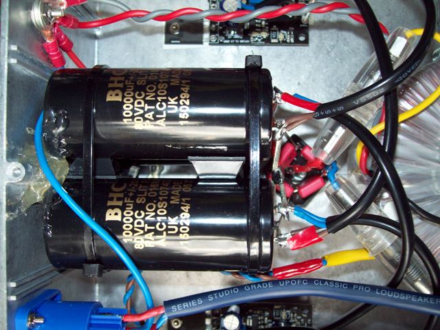

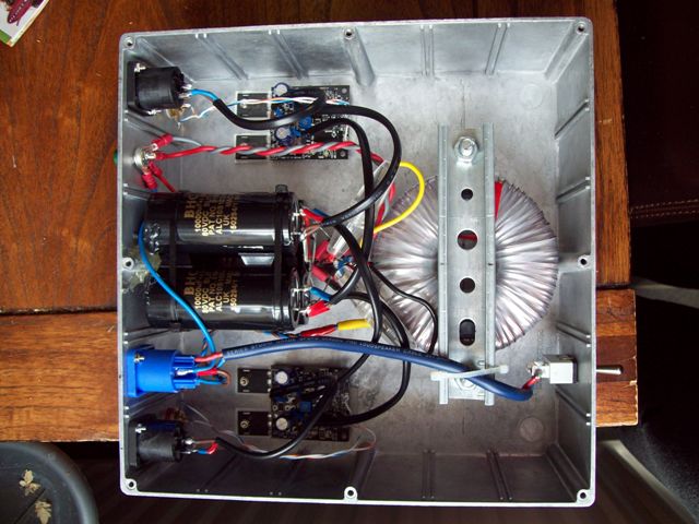

I just finished assembling the amp, and successfully managed to resist the temptation to modify the NX200 module. I even used the designated signal input point so that the onboard 22uF ceramic(?) coupling cap is in the signal path.
I used a 41V transformer which gives me 65V rails, a Vishay 35A bridge rectifier (with 0.01uF Wima FKP bypasses), 2x10000uF BHC slit foil per rail. To match my UCD180HG power amp I used Neutrik Speakons, Powercon & insulated phono sockets (so swapping from one to the other couldn't be easier).

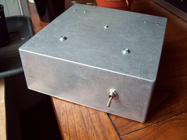

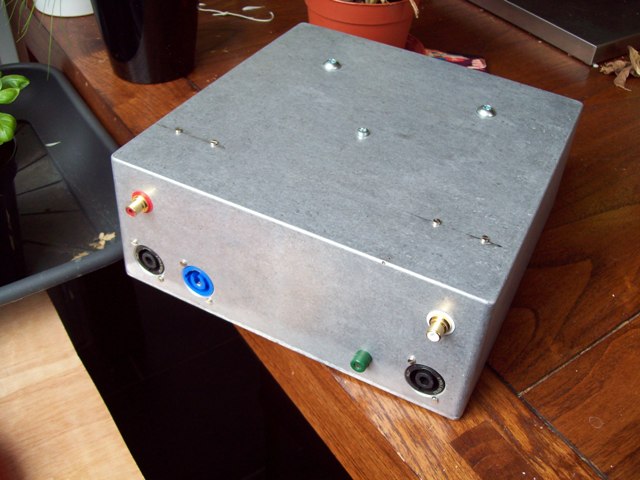

The case is from RS in the UK and costs only £22
RS diecast aluminium box 250x250x100mm
It gets quite hot to the touch, but you can hold your hand flat on the panel with the mosfets attached for as long as you like (so it isn't that hot really). I haven't played with bias yet so it may yet get hotter or cooler...
Planning to use Rubycon ZLH for PSU caps.
